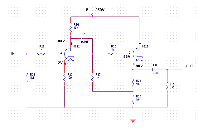

Guys, I want to tube preamplifier that I create will be different from the MOSFET or bipolar transistor preamplifier!?
Preamplifier will give one a real tube sound!!
That's why your offer a schematics or projects.

You can simplify your amplifier. C7,R25 and R27 can be removed.

Means to remove the buffer (C7, R25 and R27), then what will be the output impedance preamplifier?😕🙄
At the beginning of the given schematics is very interesting, but I think there are several a few mistakes, they are: instead of ECC88 should be PCC88,
The power supply I have a few mistakes .....
I think I agree with my observations?
So please (this is true for all), give suggestions about what I should be changing for the seeds to get things right with the line stage gain (amplification) to 10x and the output resistance <1k?

I mean that you can connect the anode of first triode directly to the grid of 2nd triode, but with having the grid stopper at the grid of the cathode follower.
So the DC-blocking capacitor C7 is not necessary as well as biasing resistors R25 and R27.
This has no influence to the output impedance of the whole circuit.
