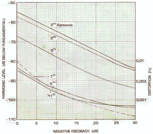

My repeated contribution at this time:
I have not seen any zero-nfb amplifier which does not have audible distortion. (That according to general acceptance based on a wealth of experimental proof of what is audible).
The much lauded 'linearity' of triodes of whatever kind: Not according to my data books or tests. Yes, mainly 2nd harmonic distortion, to be cancelled in p.p. blah blah blah .... Perhaps the expensive analysers used in the prestigious labs where I worked lacked calibration. Shure, some better than others, requirement of proper circuit design etc. - been there, done that.
My main contribution at this time by measurements and tests (if it is possible for such to still carry weight in the haystack of pronouncements by the celebrities ....): The matter of harmonic multiplication so glibly and simplistically offered as condemnation of gnfb at all. Sure - true enough; but figures please! In any properly designed amplifier this does not occur before the application of heavy amounts of gnfb, far above the level required for reduction of all harmonic products to below any audible level. In this (misuse) is included the low thd figure level chasers hovering in the 0,001% regions.
The following are graphs of decrease of harmonic levels up to 11th, for an ordinary if well-designed 80W transistor amplifier operating at about 40W into a resistive load, vs. amount of gnfb. Sure, the reduced decreasing tendency is evident, particularly for the 11th harmonic. But at the design figure of 28dB of nfb, levels are already close to or buried in noise - no need for more gnfb. If there are golden ears still capable of hearing these - my sympathy for your disadvantage. Mercifully most of us fall short of that.
(Apology for a somewhat smudged picture - figures pasted on afterwards.)
