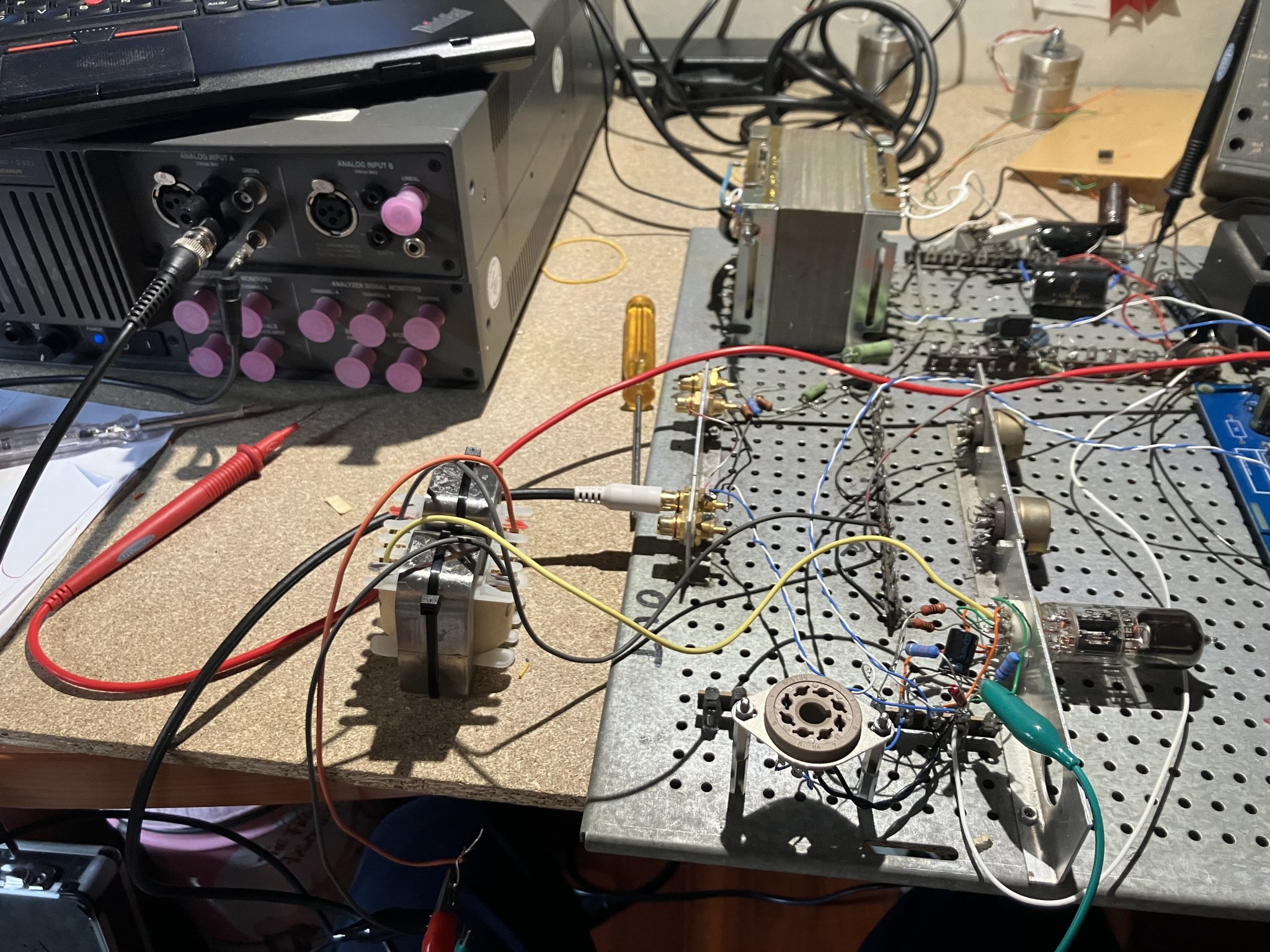

Starting the test
Not so bad for the start point
