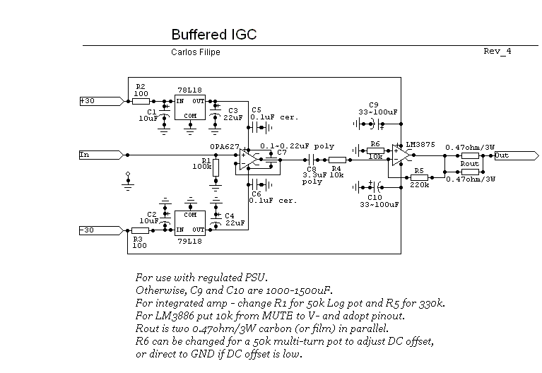

Rev_4
Carlos Filipe BIGC_rev4 😎

I just want something that sounds good, and Carlos method looks like good engineering to me. I can see how making your signal source move current rather than voltage thru the interconnects would cause problems with frequency response and apparently most signal sources are not designed to do this. They are designed with an active preamp in mind at the other end. (I read an article Carlos posted about this).

First: you can hardly call it a 'secret recipe' when so many schematics have been made available and so many questions answered about the circuit.
Second: To the best of my knowledge it was Pedja/Joe Rasmussen who originally came up with the idea of a buffer for the inverted Gainclone. And Pedja had full details of regulated supplies on his site long before this thread began. To call the ideas of these guys 'a hamburger' is highly disrespectful!
Third: a not insignificant number of us have now built and tried this design. We are the only ones really qualified to pass comments on whether it is any good (and I include PD in that statement and respect his opinion too, if not his comparison with a battery-powered GC).
