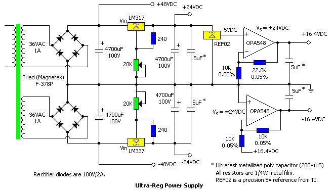

If you have not made a Gainclone before, please build one without the regulators first (use 1000 uF Panasonic FCs on the pins). Get that working properly and then add the regulator circuit. You will only need to remove the 1000 uFs and replace with the 33-100 uFs. 😉 [/B][/QUOTE]

What about building a regulator like this one from www.headwize.com using high amperage power opamps (the same that will be used in the amp)?
Erik
Regulator

What I managed was to optimize the sound quality of this regulated PSU (with LM338), with some hints of Nuuk and Pedja, who told me that the output cap could be removed (it was sounding very bad to me with 100uf).
I finally did not remove it, but put a much smaller one, and on the LM3886 chip too.
The LM338 likes to be bypassed (who doesn't?😀 ) very near the input and output pins, and that is in my schematic.
