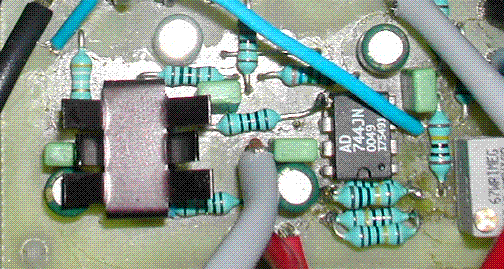

Hetsinks for DIL
Or use these:
Search for 75-611-52 at ELFA
I use these on the BUF634 and AD811 in my preamp...
air said:Ooops.![]()
I did miss the part in the datasheet, where it says that Wide BandWith mode sets Iq to 15mA. That explains the heat in my Buf´s 😉
Well, I´ll just have to change them to TO220 and use heatsinks, like Carlos suggests.
Or use these:
Yes,thats the one.peranders said:
Here is a picture from my preamp
