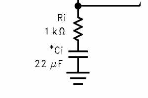

Do you have DC at the pre out, after the cap?
You could try to put the 22uf cap on the NIGC.
Like this:

I checked it out after this and I had no problem with voltage on speakers output of the GC. But still had around 210 mV offset. So I took the caps off between the pre and the GC, so I have them now DC connected. The offset of the GC is now 10mV on R channel and -10mV on the other!!! Good.
