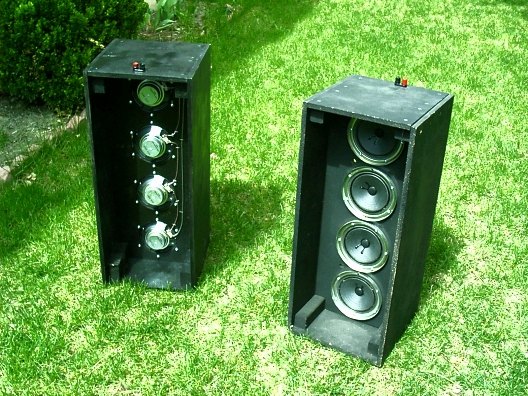

As it turns out, the girl living upstairs of me has a digital camera. 😀
These are the satellite speakers. I cross them over between 100-200hz, and they will play 105dB (by my calculations, never measured) and to my ears they sound completely clean.
I run the sound through my Behringer mixer, and I have the treble knob all the way up (that's a +15dB shelving filter with a corner freq of 12khz) and the two midrange knobs (centered at 3k and 500hz) turned to -6dB. So, the corrective EQ on these is pretty huge; once I get them to that point, though, they sound extremely sweet and pleasing to the ears.
They do require themselves to be elevated off the ground so that they're at least partly at ear level. If they're not, the sound becomes muddled and coverage suffers. I find just setting them on the table next to the potato salad works nicely.
The drivers are 4 ohms apiece, and I wire them in series for a 16 ohm load; I can wire 4 cabinets in parallel to get a 4 ohm final load, which my amplifier will happily drive to 50 watts without distortion.
The cabinets are 13" wide, 12" deep, and 28.5" tall (not counting the binding posts), made of 1/2" material. 2 of the cabinets were made from particleboard, 2 from baltic birch plywood. I haven't sat down and done a/b comparisons, but they seem to sound about the same. The baltic birch stands up to abuse *MUCH* better, but the paint is much harder to get right. Particleboard you can just spraypaint black.... baltic birch you must sand, prime, then spraypaint.
And of course, the most important ingredient to ANY low-budget speaker setup is copious amounts of black spraypaint. 😀
If I had it to do over again, I would add some dead space to the bottom of the cabinets so I could add a "speaker pole tophat" to them and mount them on top of something, so it wasn't such a challenge to get them to the right height.
I have not built subwoofers to compliment these yet. 10" drivers are on their way now from Parts Express and should be here Tuesday. I'm hoping that I can integrate the dipolar satellites with vented woofers and have things come out sounding good.

Is that kind of an idobaric set up? That probably helps them alot, since I've noticed that isobaric setups seem to redeem the simplest and cheapest of dricvers. That brings up some interesting ideas... thanks alot for the pictures. I'll post mine as I work on them.
They are dipole speakers. There's no back to the cabinets, and the "front" baffle is mounted in the middle.
Construction details...
Dipoles are known for clarity, and these are no slouches. They do require a pretty hefty treble boost, but with it in place, they sound fantastic. They just don't go low. I've been using dipole subs but I'm planning a switch to vented subs in order to use room gain to my advantage and gain better low-end extension.
The design is easy to remember. The baffle is 26.5" by 10.5" (you could make it narrower if you like; it probably won't be as stable if you do) and the driver cutouts are spaced evenly across it. The drivers are mounted using 1" 8-32 machine screws and then soldered.
The sides are 12" by 27.5". The top and bottom are 12" by 10.5". The whole thing is secured with cleats made from 2x4's that I ripped down the middle with a tablesaw. Super easy. The only problem I've had was with one cabinet; there was a rattle in it, which I fixed by cramming pieces of foam in between the cleats and the baffle. Problem solved!

Nappylady, have you tried putting the baffle on the front rather than in the middle? I can see a lot of problems in the mids and above with recessing the baffle, it's a good idea for dipole woofers, I'm not so sure about for midrange though.

I have not yet tried mounting the baffle on the front, but I can see what you mean about dispersion problems. The back end of the speakers is basically un-listenable becuase the baskets of the drivers obscure so much of the sound; since I'm not planning on having them play for both sides, I might as well try moving them to the front.
I think I'll try this today. Thanks for the idea!
