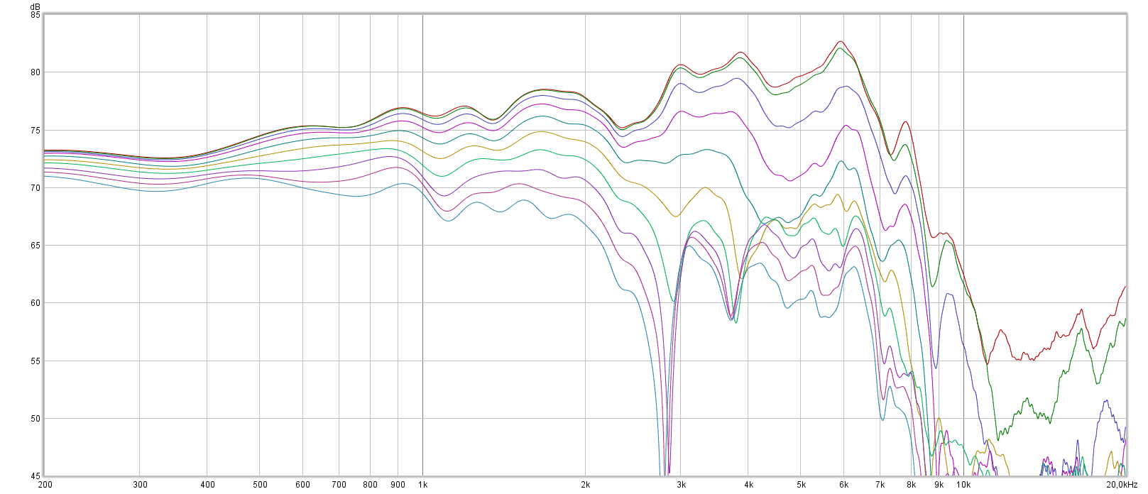

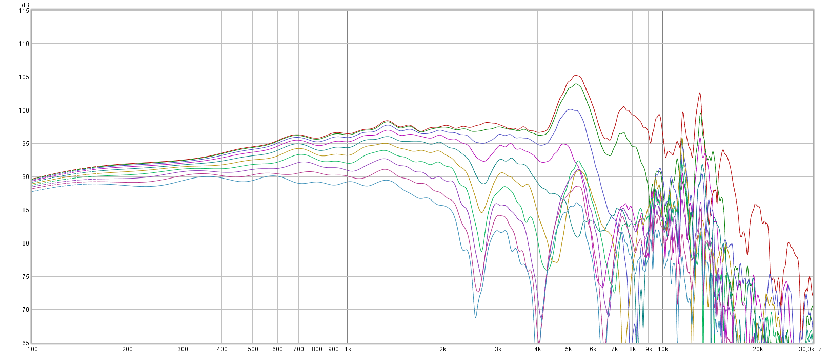

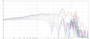

18WU makes very good midrange driver, I used it in one of my projects, see my measurement in enclosure in the attachment. Breakups are very mild, but it is better to keep crossover <2kHz. I added SS6600 in WG, crossover ~1700Hz LR4. Sound quality of the midrange was very good, transparent, crispy, vivid. Of course overall sound depends on quality of your measurements and crossover work, and how drivers fits together sonically.
- High-End DIY Three Way Speaker
