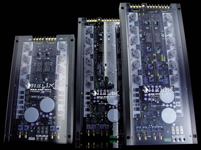

Uf, I know this amp from Helix, but true hi-end is BRAX. DIY is possible, but I don't know if anyone have a shematic of these amps.
Here is a picture and link to site:

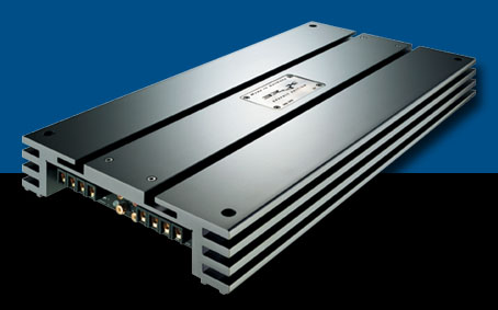

Speaking of Brax. Have you guys seen this picture ? Its their new component set.

Brax (Helix), Mcintosh, Zapco are among the top dog of the auto amp world. They are priced at around $1,000+ and their compact design should make good choice for DIY. From what I've seen, Helix's components are surface mounted and they are quite tiny to be solder by hands. Has anyone seen the interior of the Mcintosh and the Zapco amps?
