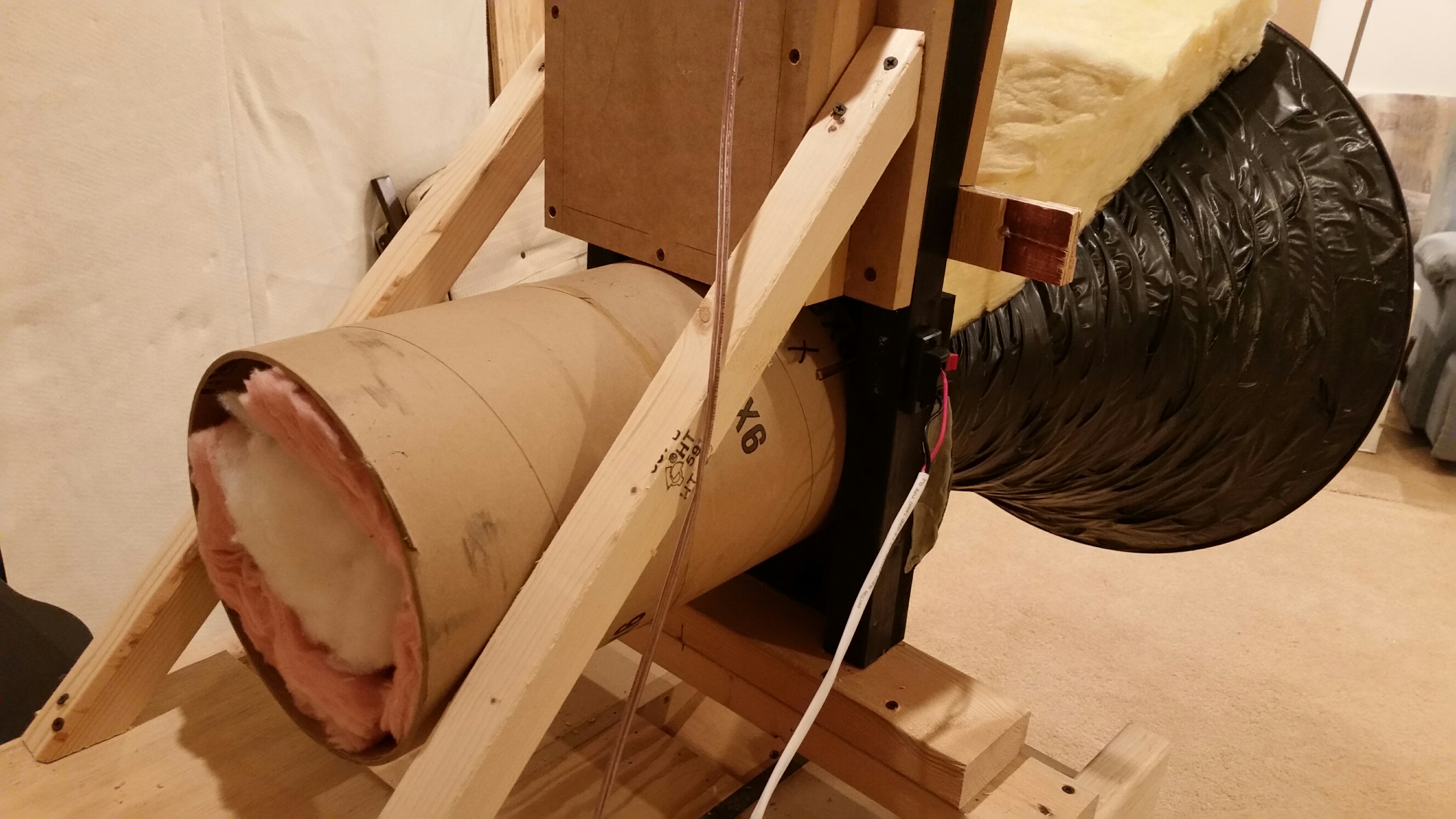

I was able to make an 18 inch length work quite well. But, then again, to me, an eight inch driver is more of a wide-band mid-range, and I would not ask it to do anything more than it is comfortable doing. If any given design is asking an eight inch driver to simultaneously produce bass, as well as much of the rest of the music range, be prepared to usher in modulation distortion. It seems to me, this is a loosing compromise. But, then again, to each their own.
