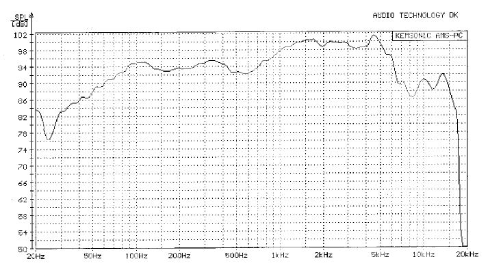

High efficiency Audio Technology C-QUENZE 23 Midwoofer
Decent motor, light cone. Suiting suspension. You end up with f-3dB at 55Hz in a small box. Like about any 8” pro driver. And Per Skaaning doesn’t trust his measuring capabilities for sure 😛. His units sell just the same.
If I did build with this I’d look to cross over quite high, maybe 600-700Hz as I’d be using this as a wide-band midrange, with 2nd/1st order slopes.
Trying to find 3 way speakers, that are relatively compact, but offer 93-94dB sensibility - not many about without looking at horns, MTM/2.5 way, compression drivers etc…
I am presuming that Per Skaaning rates at 2.83v i.e. 1w into 8ohms. Therefore potential that only a 3 watt amplifier would be somewhat plausible, but 8watt (e.g 300b) should be plenty with headroom (subject to the amount of current / drive needed which I haven’t looked into yet).
There are loads of 8” BMS, FaitalPro, 18Sound and B&C drivers with 95dB and comparable specs. The only difference would be the PP cone. Which in itself could be an argument. But not the efficiency.

There are several measurements of the AT23 around the web (dibirama,Troels Gravesen,archive.org AT site etc), but not this exact model, having a much lighter cone.
A lot of them (AT) exhibit the usual surround bump around 1k, and they're PP cones tend toi behave well, and a re very damped.
Yes, I did come across this, but think it was a lower efficiency model, 23 | 52 20 06 SD I think - I haven’t found anyone using this higher efficiency version(?).
