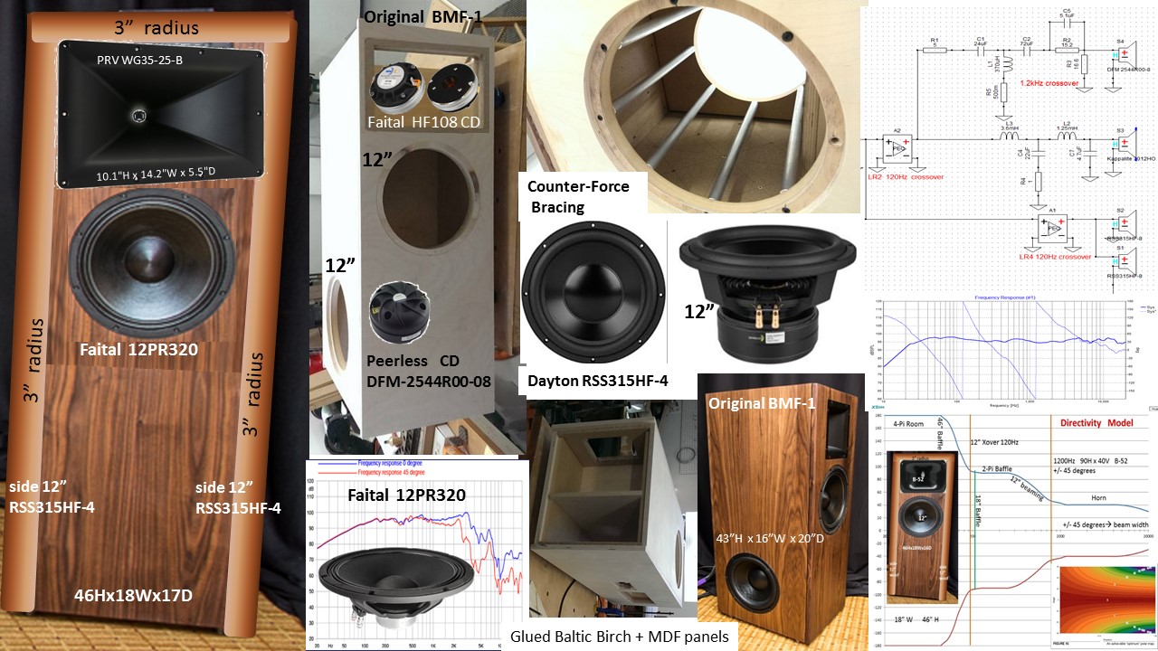

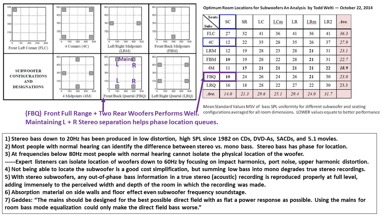

What You and your Family experience at the main listening seats must be MUSICAL MAGIC or there is very little reason for DIY.
GOAL: Stereo front 3-way 30Hz - 18kHz controlled directivity 3-way speakers, plus rear stereo Klipsch subwoofers
Sketch your room + seating positions + room treatments and run a few simulations.
I would use a great 12" in a low diffraction SEALED cabinet with a horn tweeter, and add sealed+equalized front woofers.
FRONT STEREO 3-way pair: 1" CD Horn + 12" midbass + room equalized woofers
---Consider a design like the Tweek Geek BMF-1 with side-side counter-force 12" woofers.
You can use your KLIPSCH SUBS for the first experiments, but plan for new front subs.
REAR STEREO pair of subwoofers:
---room equalize rear placement of your stereo Klipsch subwoofers
I'm still a fan of the Tweek Geek BMF-1 style speaker design. 24Hz to 18Khz @93db/watt $606 for drivers. The BMF-1 stands 43”high x 16”wide x 20”deep. Reduce depth with H46" W18" D17" cabinet.
34 Best Tweek Geek'''s BMF Speaker in the making images | Loudspeaker, Flooring, Geek stuff
A 3way 24Hz to 18Khz will cost you....$606 for drivers from PartsExpress + 100Hz Bi-amping
-Faital 12PR320 sealed midrange with -F3 ~100Hz cost ~$230,
-B-52 PHRN-1014 [Part # 299-2303] 1" Horn 10" x 14" Bolt-On waveguide cost $14,
-Peerless 1.75" DFM-2544R00-08 coated Ti-diaphragm compression driver cost $62
----option the 1" B&C DE250 mylar dome compression driver costs $104,
-plus two $150 Dayton RSS315HF-4 12" counter-force subwoofers (one amplifier per woofer)
$606 for drivers
Best value: Passive crossovers for the TM and biamp at 100Hz LR4 to the two 12" subwoofers.
----------Lower Cost----------
The $130 12" Eminence Delta Pro 12A woofer is frequently used.
diysoundgroup $310 HTM-12 uses an Eminence DeltaLite 2512 with a light weight NdFeB magnet, and SEOS15. CNC front baffle. $40 cabinet flat pac
Thank you for the options you offer me "LineSource".
The Faital Pro PR320 seems like a good option, and I can buy it at a good price in Europe.
I had thought about using the Faital in a closed box and crossing it with a subwoofer at 100-120Hz, but the comment of "Norman Bates" makes me doubt and it may be better to use a bass reflex enclosure to be able to perform the cut at 60Hz

Agree with Linesource (and others) about the B52 horn (parts-express 299-2303) being a great performer. Likewise either of the Peerless larger compression drivers offer great performance. I prefer the 1.75" diaphragm model if you will use active DSP crossover (which you absolutely should) as you might need some delay on the mid-woofer and some PEQ to hammer the response flat. I'm not crazy for the DE-250, but that's a personal choice. I also like any of the Radian compression drivers, but they are much more than $62!!!
I would also agree that a sealed cabinet is the way to go. You can always EQ the bass response as you wish with the DSP. Sealed or vented, the ultimate determinant of bass response will be the cone area and Xmax of the driver (assuming room and placement are constant). In any case, it's a good idea to keep the <80Hz stuff off your mid-woofer to avoid intermodulation distortion.
As far as <80-Hz is concerned; use 2 or more subs placed around the room. Start with FBQ or FBM positioning if possible (rarely possible in a real room). Move the subs around until they sound good. Each sub individually will excite some room mode (resonance). There's almost nothing you can do about that. But having multiple subs placed such that each excite resonances at different frequencies fixes up the bass nicely.
Once you understand this principle, it's easy to see why multiple subs work better. This is precisely why I DON'T like to have subs integrated with the main speakers - you can't move the subs (to fix up the bass) WITHOUT moving the mains.
That's a well thought out design there LS.
I've had something similar sketched up for a while now, but have not got around to building it because of other projects and an injury last year. PRV version of the same flare, DE250, AE TD10M and sealed and EQd LAB12's for the bottom end. Might have to get off my butt and build it now.
LS, do you have any more detail on the force cancelling rods? Looks neater than the threaded rods I've used in the past.

Unfortunately in the placement of subwoofer I have no options. The current subwoofer supports the three-way loudspeakers that I currently enjoy. For this reason I have thought about building an enclosure that also includes subwoofer, I know it is not the best option but I can do nothing to improve it.
After your help the speaker could be configured as follows:
-FaitalPro HF108 + Horn - Crossover 1200Hz
-FaitalPro 12PR320 Sealed Box - Crossover 60/80Hz
-Dayton Audio DCS305-4 Sealed Box
Would it be a good choice?
