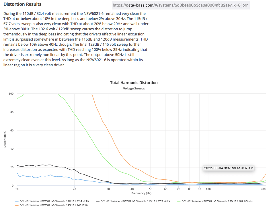

That's interesting - we have another manufacturer with another way of defining their Xmax figures. Fair enough really, as a long voicecoil and large magnetic gap depth will make for a more gradual increase in distortion as the voicecoil starts to excurse beyond the magnetic field.
It's a pity there doesn't seem to be a standard for this - it would make comparisons easier. But never mind, since many manufacturers do publish gap depth and voicecoil length measurements, maybe these should be used for comparisons, rather than the Xmax figure alone...
As an example, a driver with twice the gap depth and twice the voicecoil length (but the same overhang) will have half the rate of increase in distortion as the overhang is exceeded (I would guess).
Can be a can of worms, using a laser technically tells you when 10% distortion actually
happens. So as a manufacture you would tend to prefer laser.
Usually laser measured numbers are higher than the gap/coil height equation.
I tend to respect manufacturers that publish coil and gap height.
Think many are trying to stay away from ridicule.
If you published gap/coil equation and laser.
The laser number would be higher and people question it.
I guess people in the know how. Can also question
manufactures that do not publish coil height.
They obviously prefer to publish the higher laser measured spec.

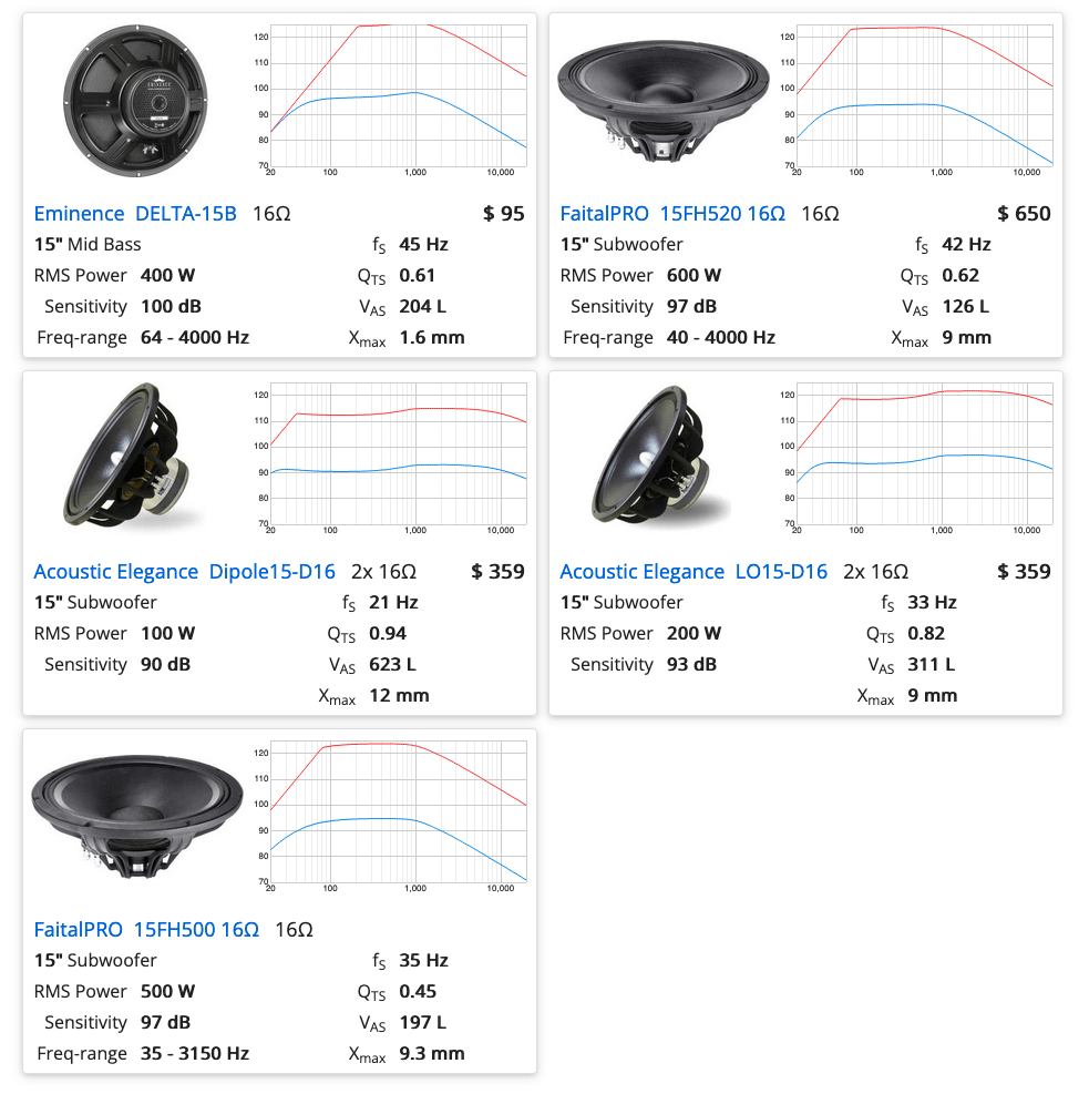

Based on the spec sheet, this satisfies all of your requirements.I wonder if anyone knows of high efficiency (95 dB/W/m or better) 16ohm 15" drivers (under $200 each) similar to these Delta 15B but with higher Xmax. The Xmech is about 11 but Xmax is only 1.6. Qts needs to be at least 0.5 or maybe 0.4 if fs is 35Hz or lower.
https://www.parts-express.com/Eminence-Delta-15B-15-Driver-16-Ohm-290-419
https://www.lorantz.com.au/loudspeaker-products/loud-speakers/15-inch-bass-mid/ac386t-pa-500w/
It is not local to you (postage would be a killer), but does show that the product you want still exists. Maybe you can find a small manufacturer near you that has something similar, or contact some repair places to see if they can recone a pair of dead/salvaged PA woofers to your specs.
A single 8ohm 18" option may be less hassle to source, and quite a few are around the 98dB mark. Conveniently for your budget, high(ish) Qts is usually found in the cheaper / lower power part of the pro market, e.g.:
https://usspeaker.com/beyma 18wrs600-1.htm (currently available new)
https://usspeaker.com/paudio c18-650el-1.htm (maybe available 2nd hand)
A quad of cheap 8ohm drivers would also be easy to pick up. If your have plenty of space, and if application is open baffle or infinite baffle, using a small array of really cheap drivers can work well.

im in the same boat. looking for a 100db 15" woofer. dont think its really possible. should have went with dual 15's myself to fully meet my mids.I am looking at options for a high efficiency build where I am trying to get as close to 100dB/W/m as possible. A pair of high efficiency 15s is one approach and I would prefer to have a system Z of around 8 ohms rather than 4. A single 15 may get to 96dB or so which may be what I have to settle for in the end but right now I am just surveying the landscape.
One 18" may be another possible option of course and I haven't completely ruled out a 4 ohm system as the only real issue would be the need to invest in more expensive output transformers but that may well be less of an issue than the cost to reach the 8 ohm goal. Of course the midrange has it's own issues because the list of direct radiating mid/full range drivers running near 100dB is also kind of short. In the end anything from 95dB and up should work fine. Even single ended 6EM7 should fill a modestly sized room nicely at that level.
