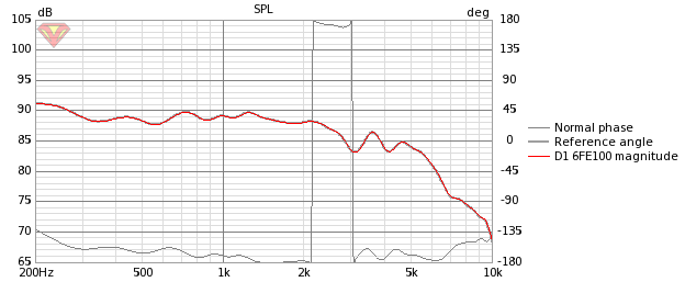

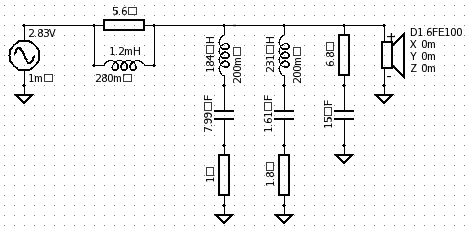

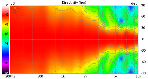

While I don't have specific comments for or against what you proprose (it mostly sounds reasonable), I can show you the measurement I just took for a Faital Pro 6FE100 I'm evaluating for midrange duty.
Measured on an 8" wide baffle, every 5deg from 0 to 90, mirrored:
I think it transitions smoothly from piston band to a steady 50deg of dispersion up to 10kHz. There are peaks to ideally deal with at ~4kHz and 8kHz, but the response from LF to 3kHz is quite smooth. Very easy to do if DSP, passively, the inductors are small so not that pricey.

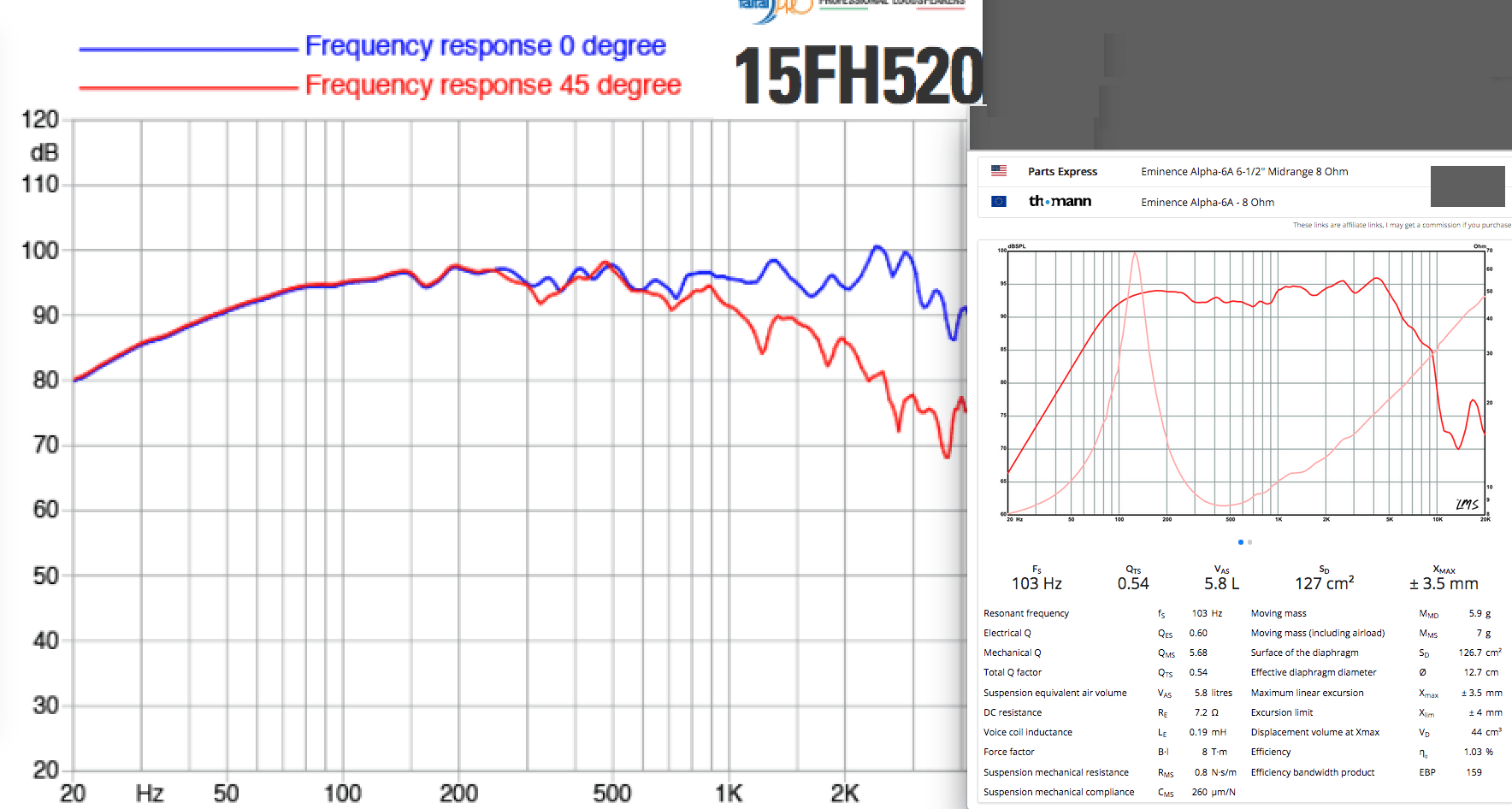

A controlled narrow beamwidth is beneficial in reducing room reflections, but transitioning from wide HF dispersion in the upper range to narrow in the midrange, then back to wide is not a good plan. Most 5 or 6" midrange should be around 90 degree (-6dB) dispersion in the 3kHz range, a good match for your tweeters.Thanks. This were my worries and the reason why I steered away from a 2 way design. Also, wouldn't beaming actually be beneficial to the sound as long as I sit directly in axis with my speakers, aiding with room reflections? Do you have any suggestions on a high efficency, low distortion 5 or 6" midrange?
I have personal experience with the Eminence Alpha 6A, it has similar midband sensitivity as your 15FH520 woofers and PT383 tweeters.
I've used them from around 2005-2016 for PA (mains, side fill, floor monitors) from 100Hz-3kHz, they sound good up to 115dB at 100 watts, and no complaints with 400+ peaks.
There may be better drivers available now, though most improvements would be in the power handling and excursion capability, not much of an issue for mid-band domestic use between a single 15" and dome tweeter.
