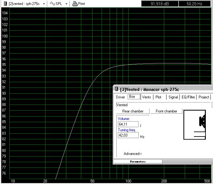

.... paradigm servo 15 .....suppost to be a fast/dry s..... what makes yours so different?
Damned if I know. I haven't heard your rig.
But what I can tell you that I've heard a vast number of bass rigs over the years and very, very few were what I would call fast and dry, the way non-recorded sound can be. Only big, heavily braced, low pressure BR boxes with low Qts drivers. Or big open baffles with low Qts drivers can do it - IMO. I suppuse it's about stored energy, or the lack of it.
Sorry if that isn't much help, but that's about all I know!
