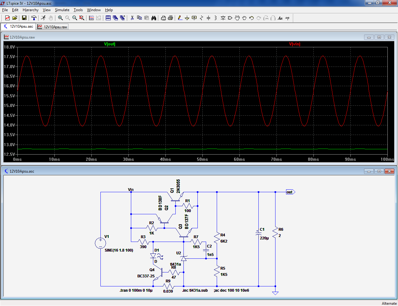

It is a typical cliché of ~high current supplies; but as most clichés, it leaves a lot to be desired.Here's what I have found
With an opamp combined with a voltage reference, it is possible to do much better.
A TL431 more or less mixes both and can provide a very simple and effective solution: here is an example (if you don't need the current limitation and indication, just discard them).
Use one 2N3055/3A load current with balancing resistors.
Stability, regulation and dropout will be better than for your example.
Oh, very nice!
I will most likely start with only one output BJT for testing then scale from there.
