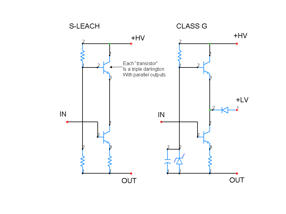

Gents:
Don't forget that the W.M. Leach Super amp has a totem pole (cascade) output stage that greatly increases the SOA by dividing the Vce seen by each power transistor by 2 thus allowing each transistor to operate in a much more favorable area of the SOA. These are not normally labeled as output pairs but rather output quads as it takes at least 4 output transistors to complete an audio cycle instead of standard two.
Cheers’
Philip
Cheers’
Philip

It is not that difficult to do with an S-Leach or any similar amp. A few component changes, a commutation diode (and snubber, not shown) and you're on your way.

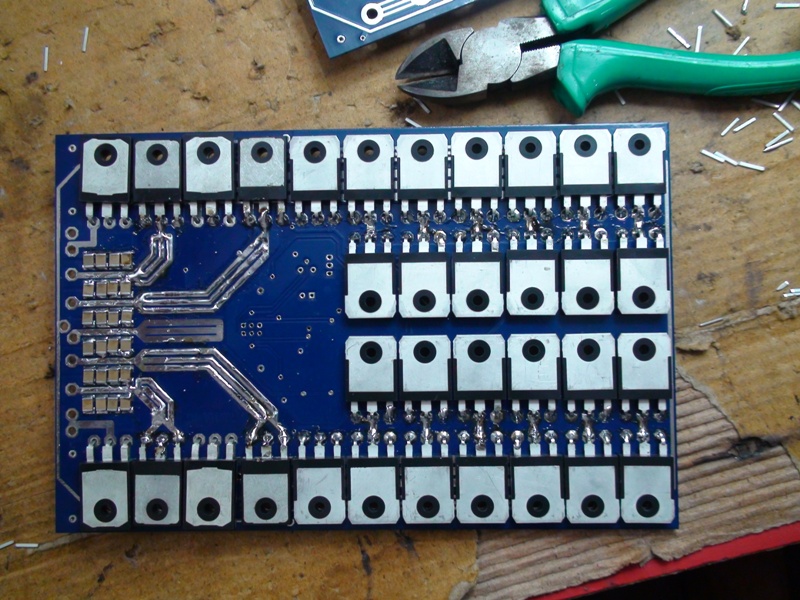

Below is my 4kw 3-step Class-H module, 12 pairs of 17A devices at output stage capable of more than 200A pk, Triple EF stage.
