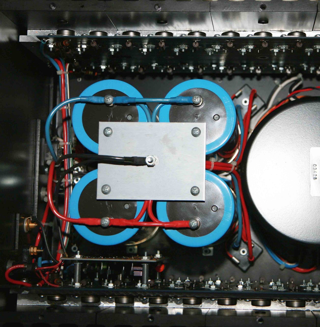

I have two mono-amps and these are using four 27 year old 30,000uF caps each.
They're are preceded by two 35A bridge rectifiers that are mounted with their backs on the metal chassis.
Question is:
I can get 8 new ones with a 5.5 mOhm ESR and 21.4A max Ripple current.
These are much better values than I have know and they're new of course.
Only the capacitance is 100,000 uF per cap.
I already placed a big Megasurge thermistor of 10 Ohms to dampen the inrushcurrent but I'm still a bit worried about the strain on the bridges at normal operation and idling.
Suppose I mount them and the bridges stay relatively cool is there still a problem then?
The old and the new have both 80Volt ratings and I can't get any higher voltage in the same priceleage as this one.
I know about the RIFA PEH169 33,000uF 100Volt cap preference...🙂
Any advice?
i think the rectifiers will be okei. but your main fuse will take a hell of abuse. you can try 2 10ohm thermistors in series. and make sure they kan handle the current.
Well that's a relief because the main fuse is the least of my worries 🙂
I've a couple of those Megasurge inrush limiters lying around. So if they one that's currently deployed fails I will swap it for one that can take even more abuse.
By the way:
The performance of the amp has improved consideryble especially at the low end of the frequency spectrum. So toss out those old caps!
