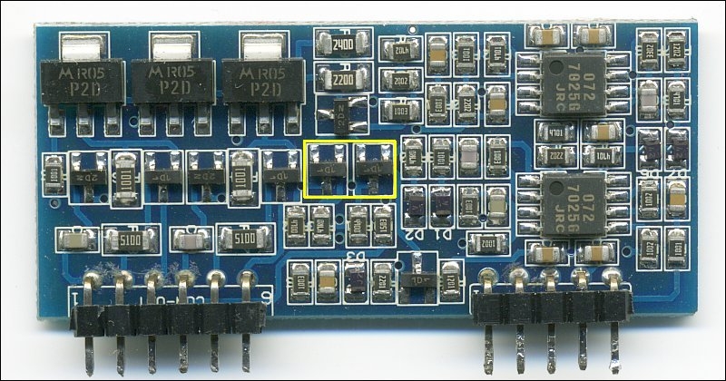

Quick measurements gave me this:
100Hz Sinewave tone into RCAs. 0.4VAC input on RCAs.
R201 couples the pre-amp/crossover stage to the Class D driver board. the Driver board side with gain turned all the way up is 0.8VAC.
Pre-amp side of resistor is about 6.5VAC. Resistor measures fine.
is this normal? or is the class D driver bad. Both 8 pin SOIC-W ICs are scratched off. Both get really hot.

Anyway, I figured out the 2 ICs on the driver PCB are TL072. I have an O2 audio which is a hifonix PCB and it wasnt scratched off.
Replaced them and the issue seemed to have gone away. We will see.

When you repair these amps, replace the two 1D transistors in the center of the board, even if they're not defective. They run hot and commonly fail.
Yea, I changed the 2 072s on that board. The top right one looked brown where it had gotten hot, and was getting hot. Changing those 2 op-amps improved the sound.
I didnt change those transistors yet. What is the symptom of these failed transistors?
