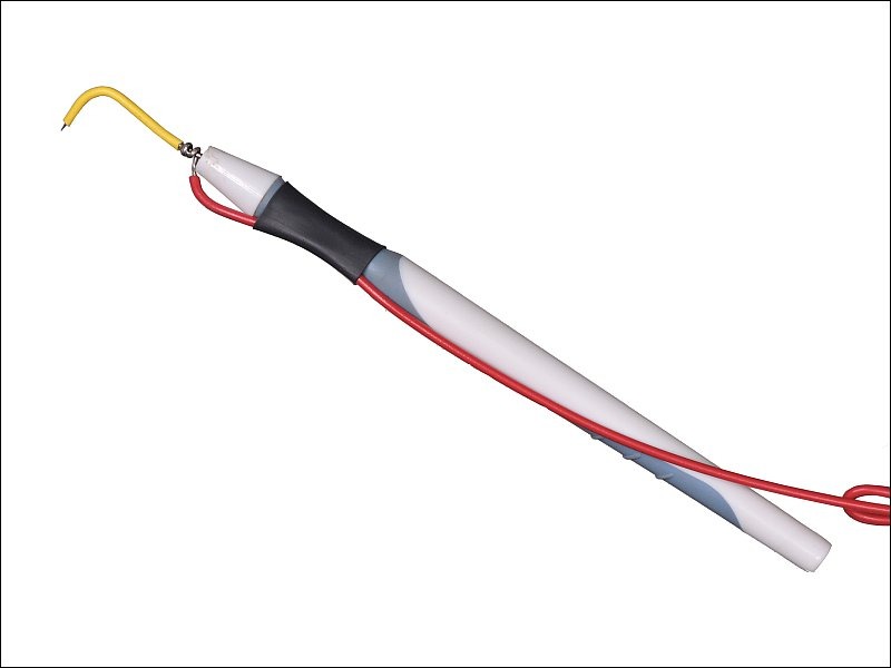

For pins that are difficult to reach, make a probe like the one below.
