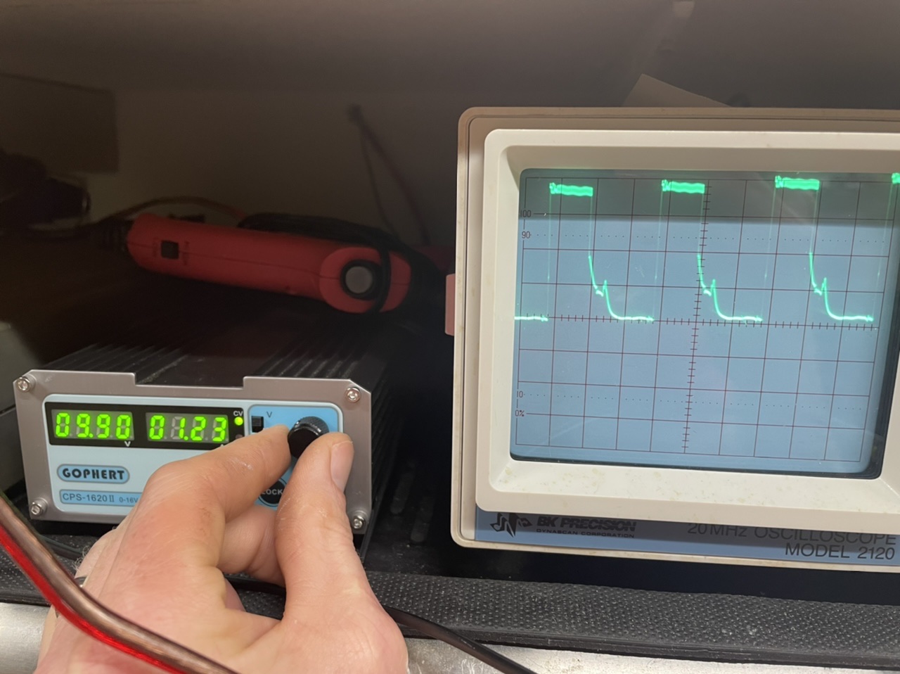

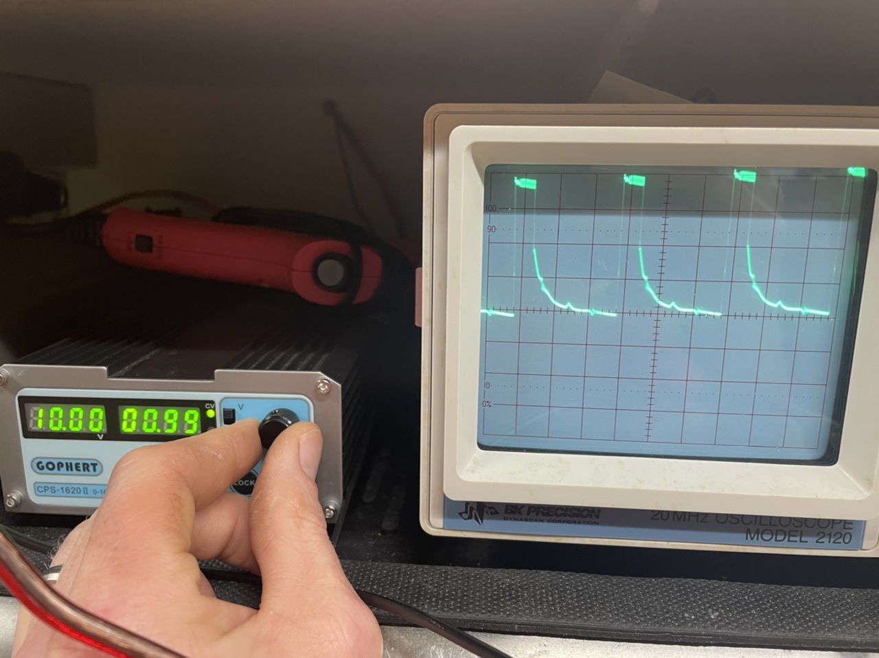

With no load, does lowering the 12v supply voltage force the power supply to go to full duty cycle?
Are any of the gate resistors heating up at the higher duty cycle (from low voltage)?
You stated that some (not all?) of the gate resistors were heating up. Does the signal on the gate leg of the corresponding FETs look any different from the ones that are not heating up?
So the resistors don't seem to be heating up at full duty cycle under no speaker terminal load.

BTW on the second try, I did have the scope on one of the gates while under load. The PS did go to full duty cycle, ~100A pull from bench, and smoke was starting the second time.
All gates look the same on the scope under no load at 9 & 10v
