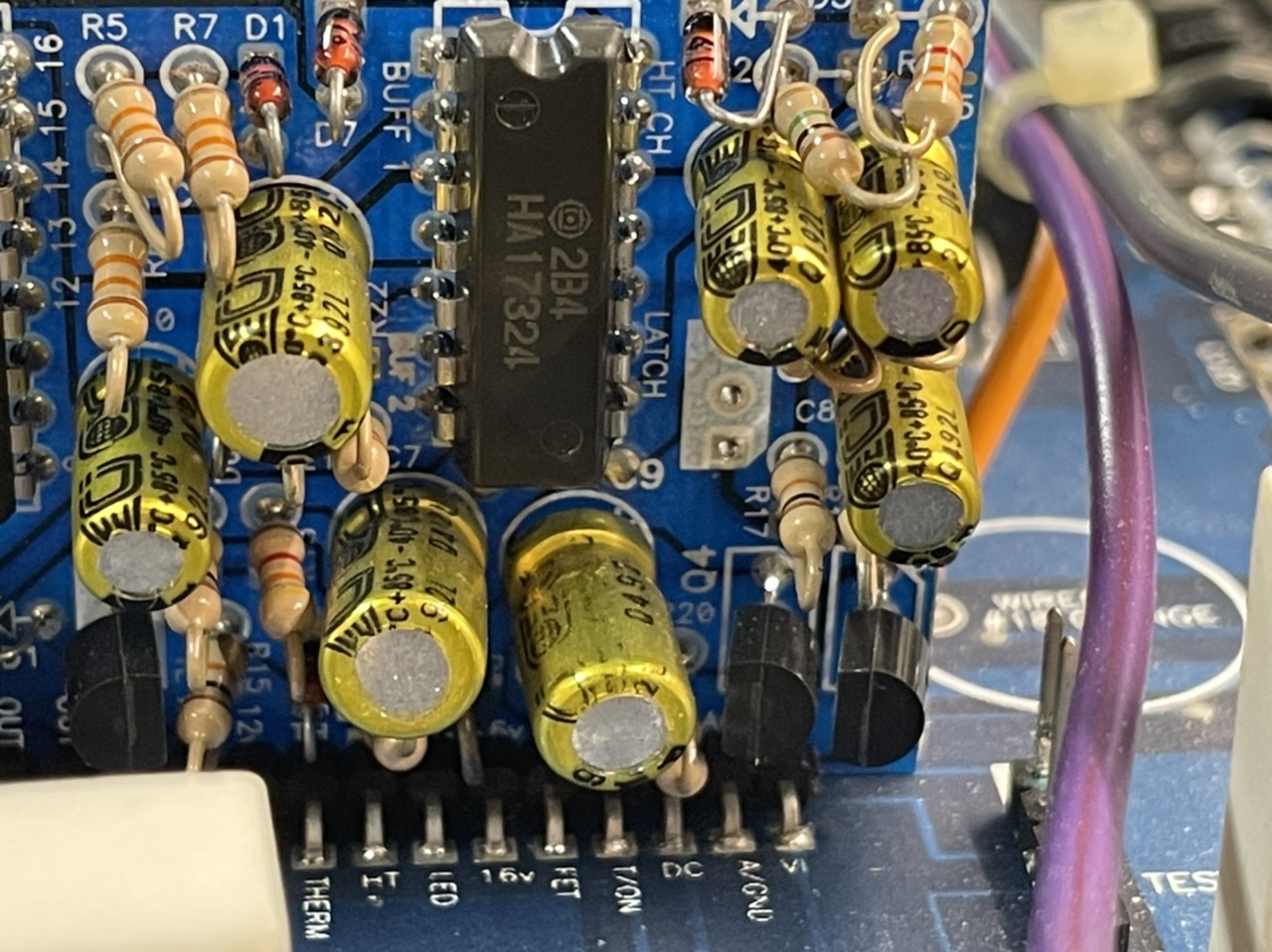

Its funny when it tries to power up, I hear it some stressing through the transformer but twisting it changes nothing. To me it seems like the amp tries to HOT power up about 3 times and then stops as thats what I see it pulling on my bench PS. Currently how it sits it is stuck in protect unless I wait. I tried draining some of the caps but I must not be draining the right one; because then I can probably get it to power up correctly for a few minutes or so. Its using TL594 and a new one for me for latch - which is a 14-pin device with 2B4 HA17324 on it. Looks a little slick too not like a normal IC. Looks custom maybe? Manufactured marking looks like a little camera inside of a circle. Thought it was OnSemi but is not.

Now even with Q1 removed the amp falls into protect at over 12.5vDC supply. Pin 16 of the TL594 starts to go high above 6vDC. This pin runs through a resistor and then over to the Hitachi HA17324 quad amp connecting to all Vin- pins - 2, 6, 9, 13.
The way this opamp is being used for Latch may be the reason why most pins are running a high positive voltage.... Is this opamp a suspect by chance? All other parts on the PS riser board are testing out OK.

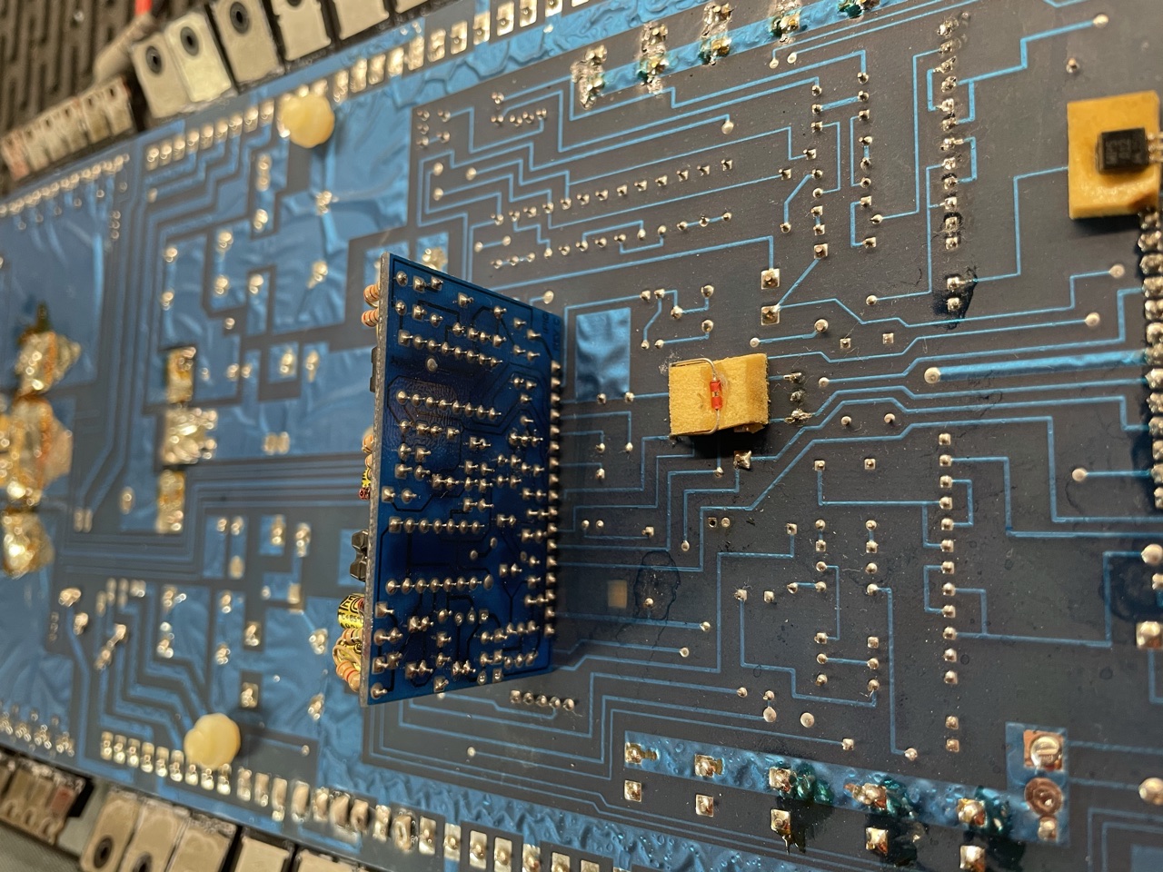

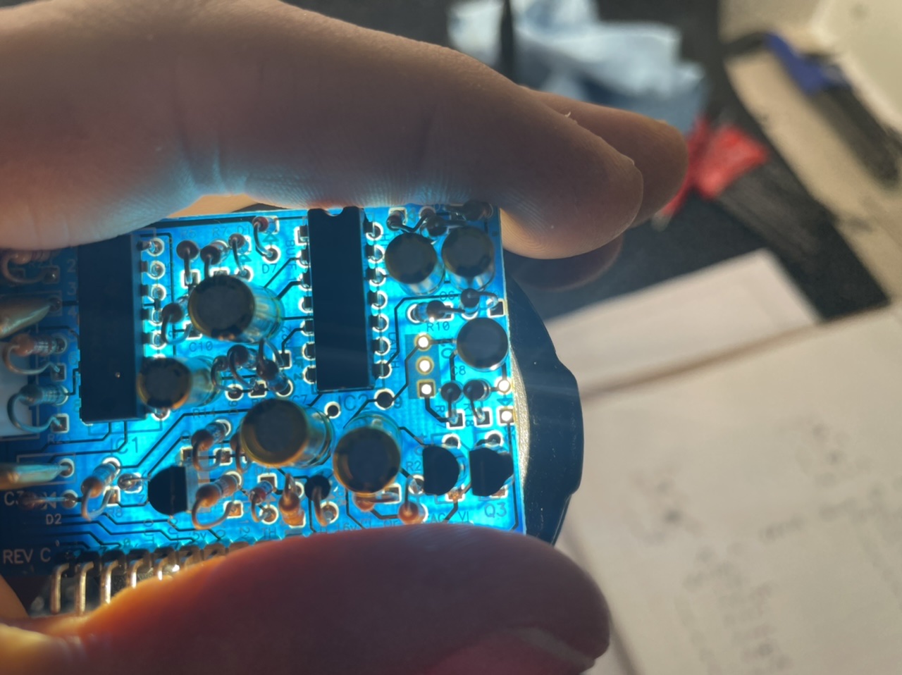

Photos of the ps driver board

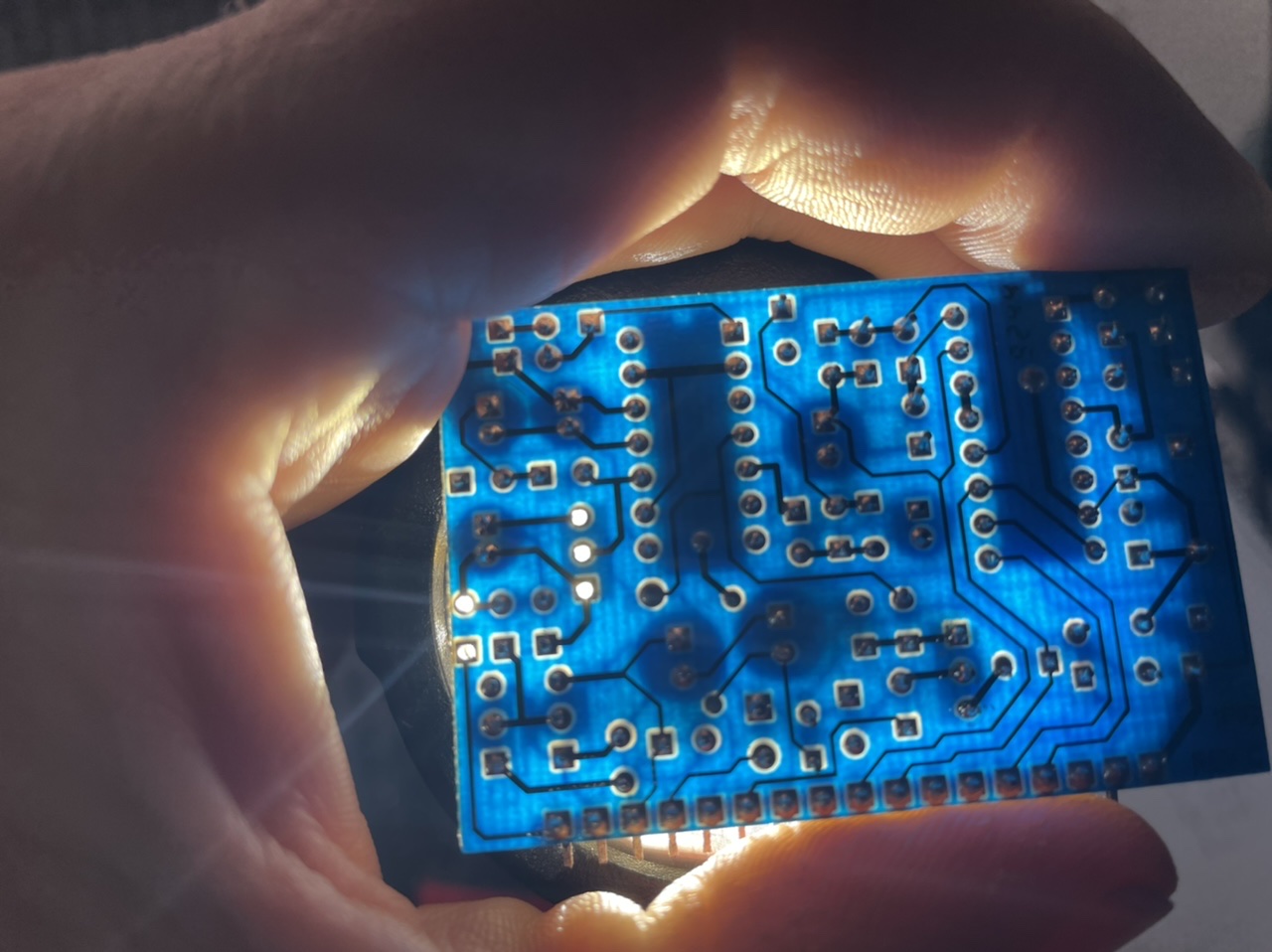

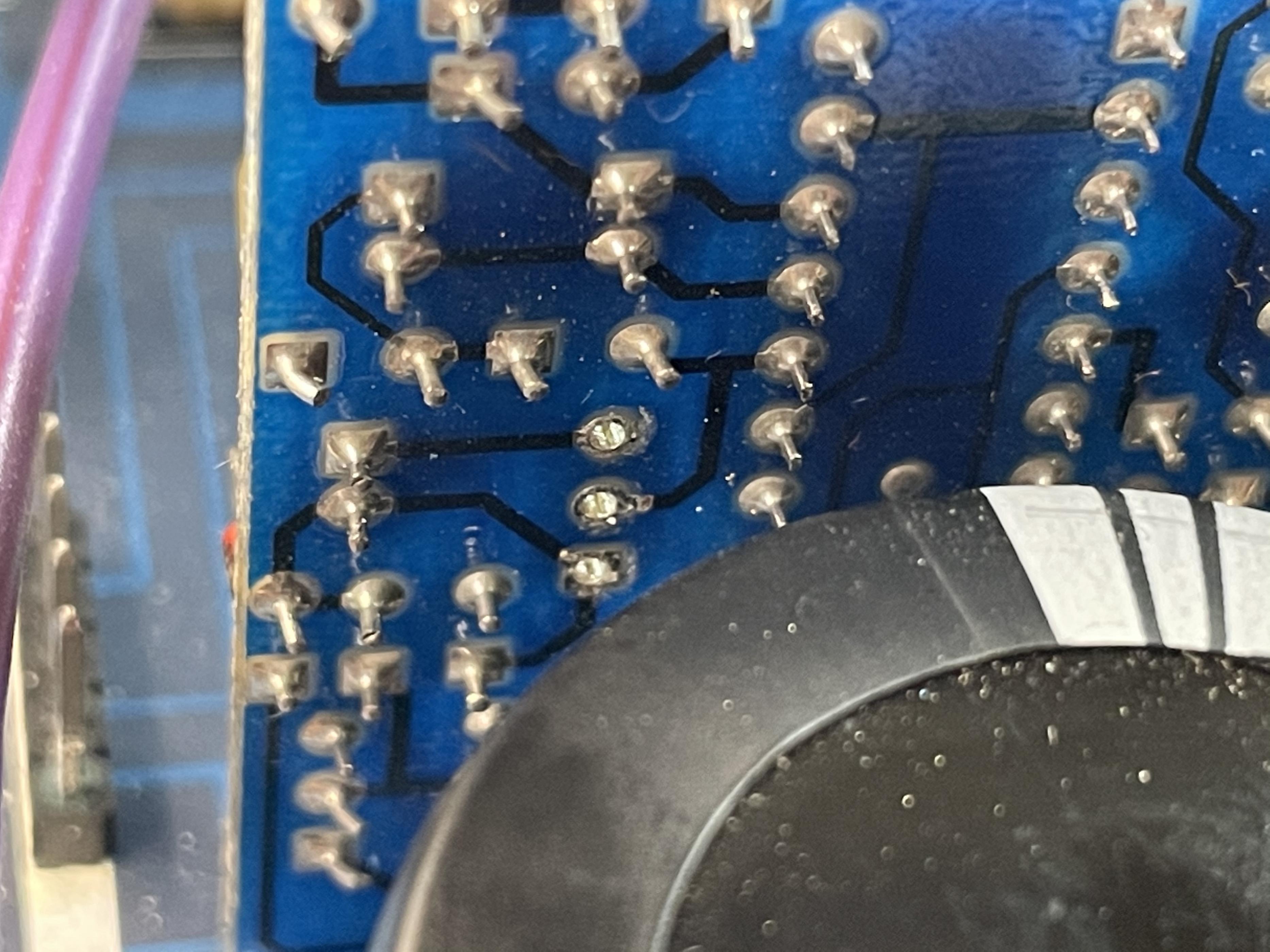

Q3/Q4 are what’s driving Q2s emitter high.
D5 removed for a minute.
Mounted the ps driver on bottom of board for much easier service.
