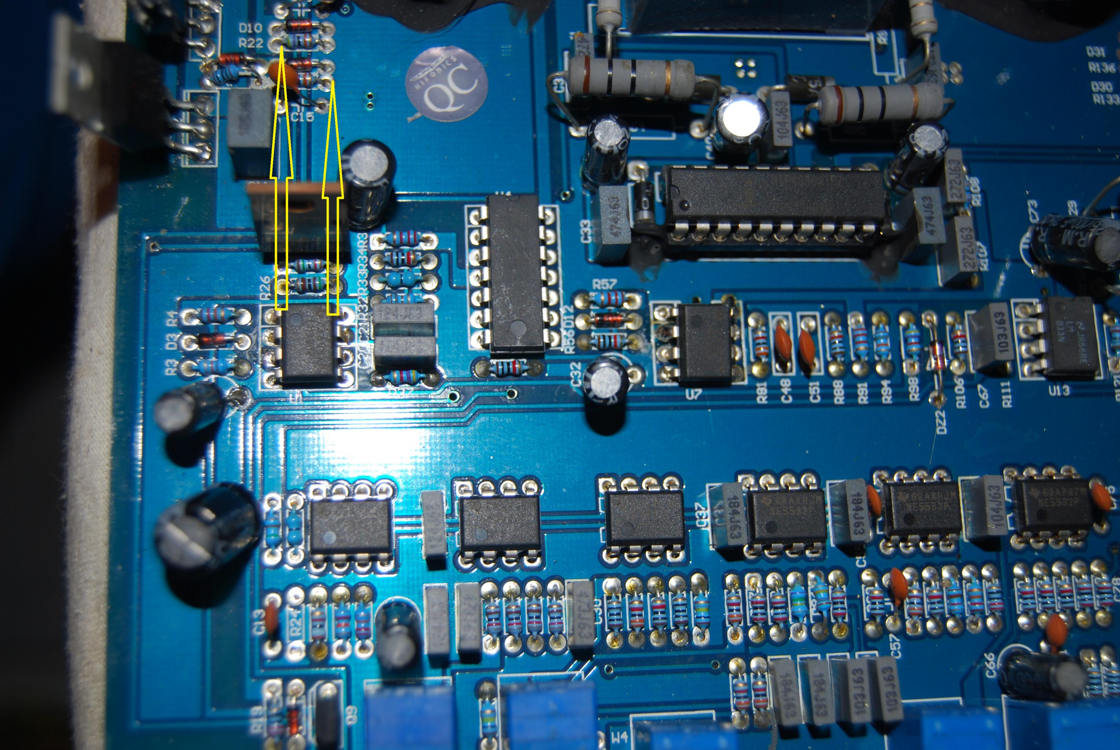

from the colored rings of your pic it looks like
yellow-purple-black-red-gold
that should be 47kOhms

from picture me i see green/violet/black/orange/gold=570k but i m not shure...if you have this configuration i wait you response.thank you!
OK this is the Titan TXI 1500d I have.
Pic just taken
So this would be 470 kOhms , also tested with an ohmmeter.
Pic just taken
the problem was one rectifier in short circuit around hip4080.after was changed rectifier the amp work ok..all the best !!!
