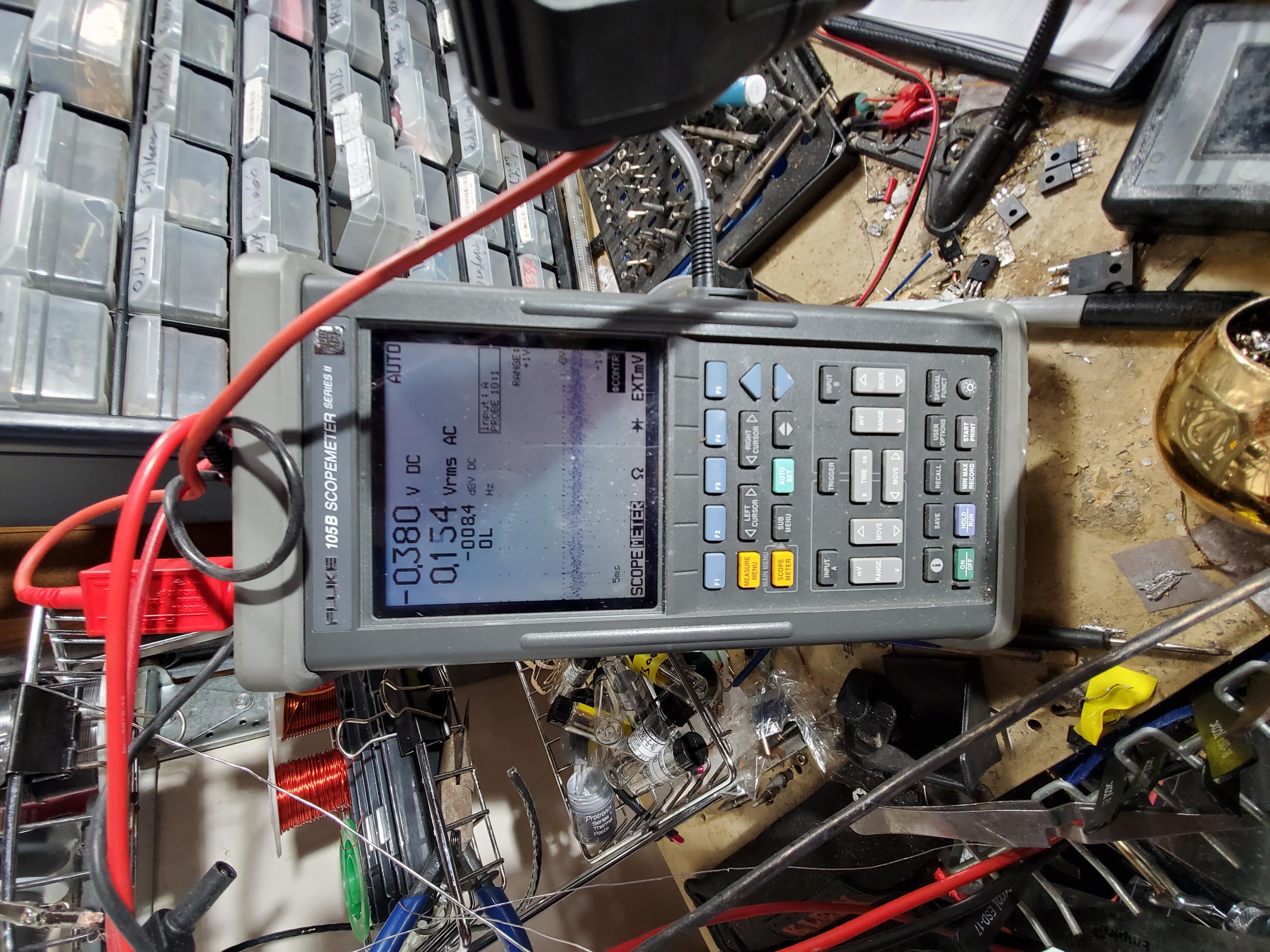

What is an acceptable level for this amplifier? I've heard 250mv I've heard 500mv dc. I want to reduce it as much as possible.
I have the amp up and running and load tested but I'm reading -.388v DC on the speaker terminals with no load.
-.356v DC with a 2ohm load so it drops slightly.

Acceptable to whom? Some techs won't let an amp go out with more than 25mv.
500mv certainly isn't going to do any harm. Is there an audible pop when the output stage engages?
Does the amp have a noticeable increase in current draw when you connect a load?
The problem (if it's deemed to be one) is likely the TL072 on the driver board. This assumes that the op-amp driving the signal to the driver board doesn't have so much DC on its output that it's leaking through the blocking capacitor between the op-amp and the driver board.

There is no audible pop and the amplifier seems to be functioning fine.
There is no significant increase in current draw when a load is connected.
My thoughts were to get your input and find a starting point. I think I need to go through the tutorial a few more times.
