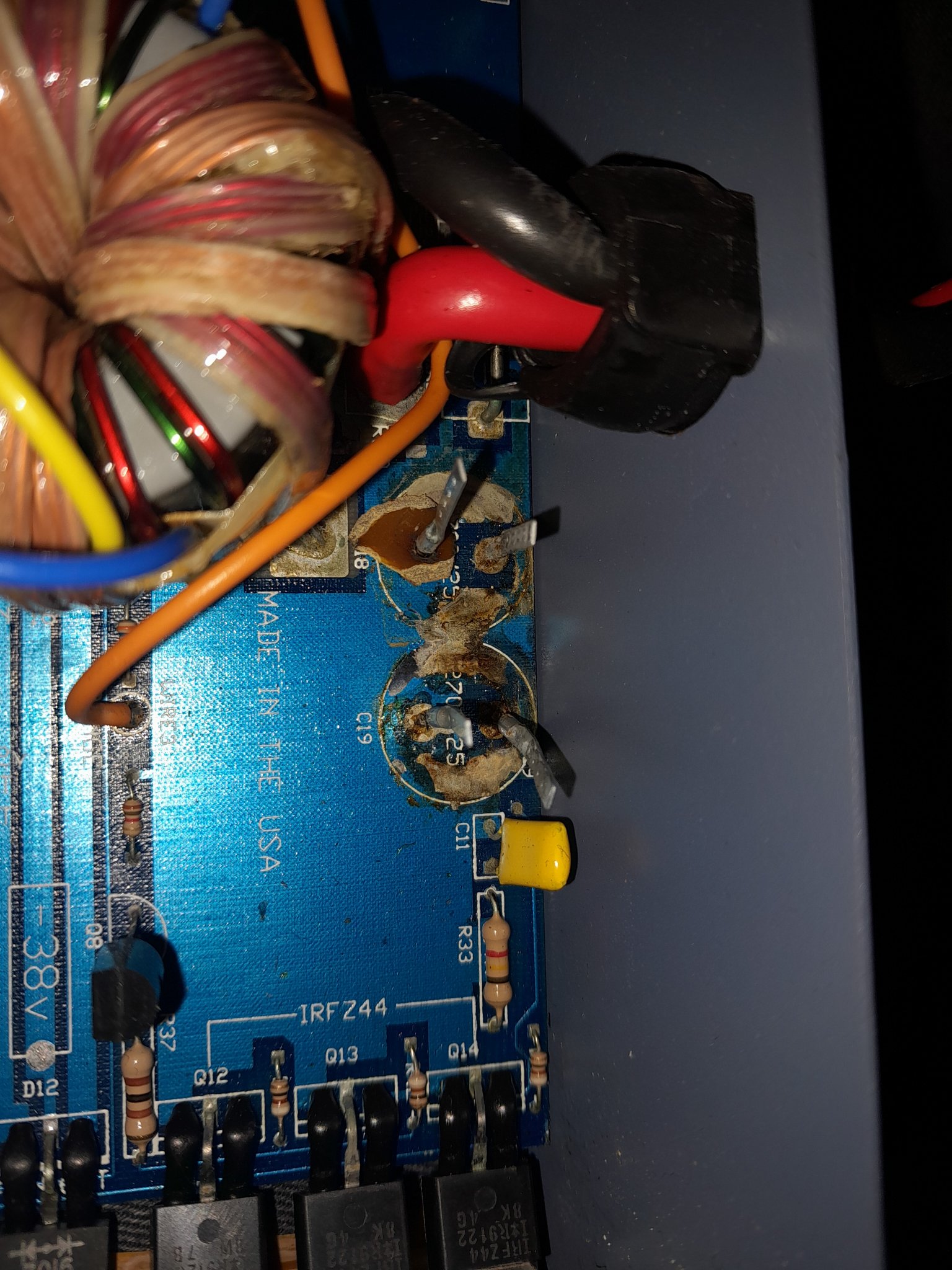

Those are the bridging wires. You need to measure to the non-bridging wires.

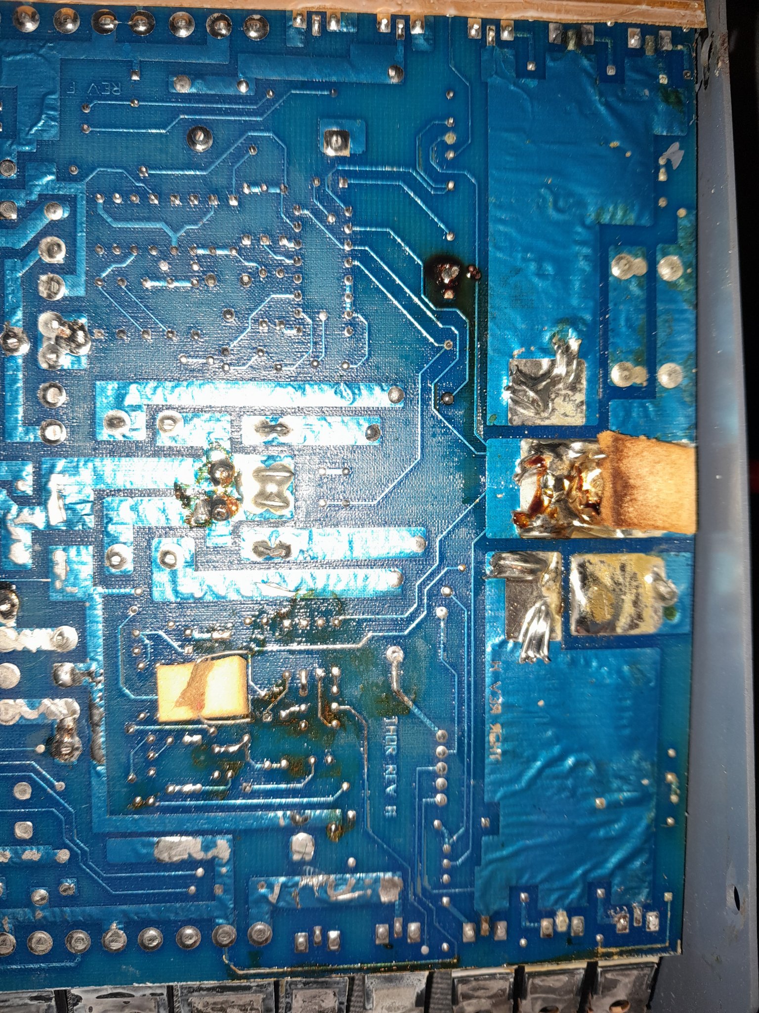

You sometimes have to cut away any discolored fiberglass. Leaving contaminated fiberglass is a fire hazard. Only you can know what you have.

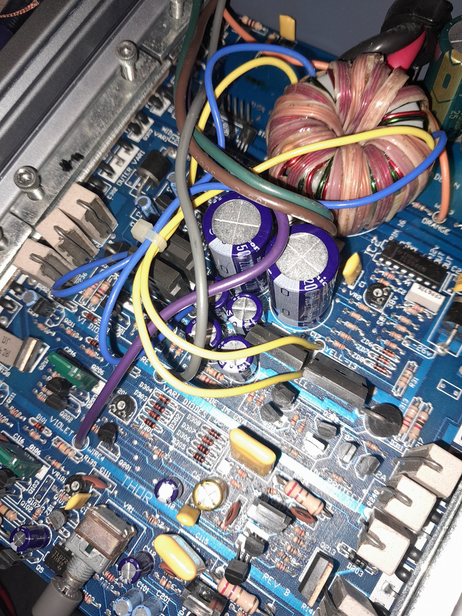

That's OK. The RCA shield grounds tend to break on the amps with the vertical RCA jacks.

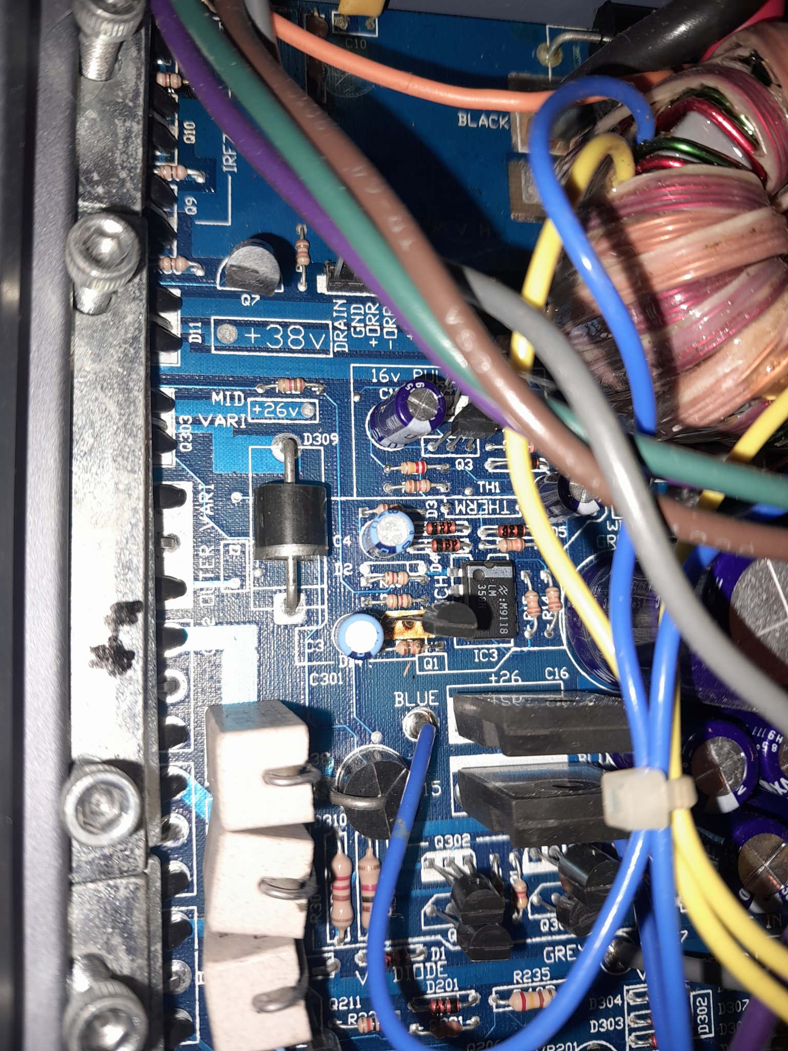

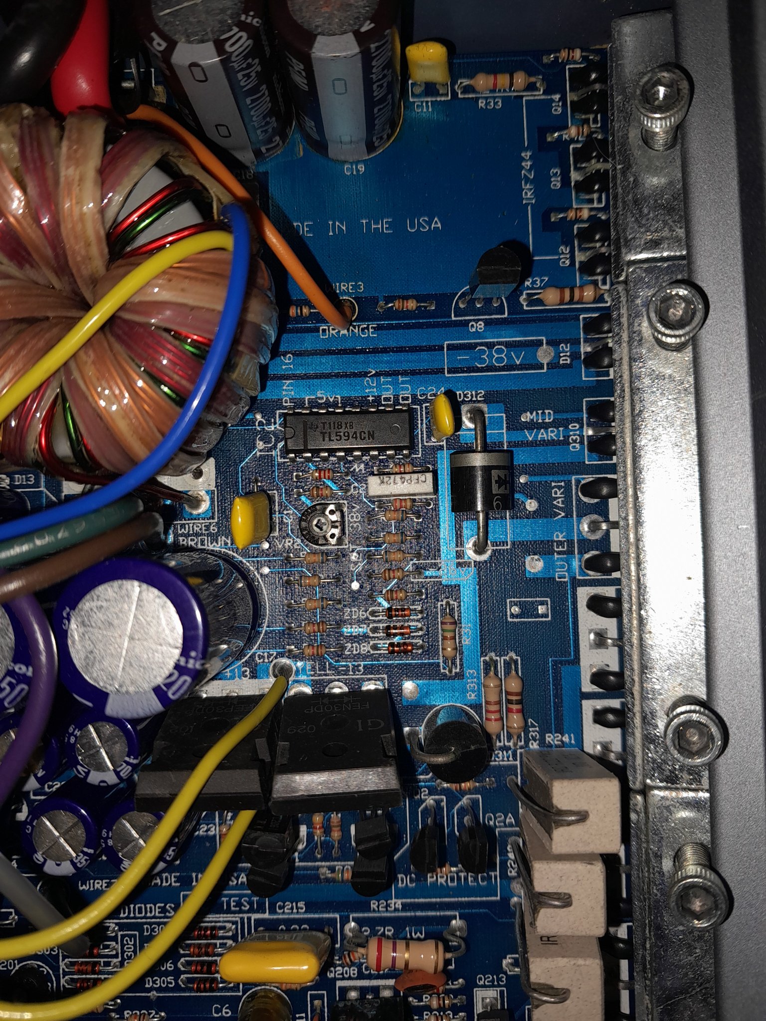

Confirm that the regulating zener on the op-amp is rated at 12v.
Is that the zener tied to pin 5?Confirm that the regulating zener on the op-amp is rated at 12v.
How do I test it?
The Zener would be connected across pins 4 and 8. There should be a number on it. There are sometimes two Zeners in series instead of a single Zener.
