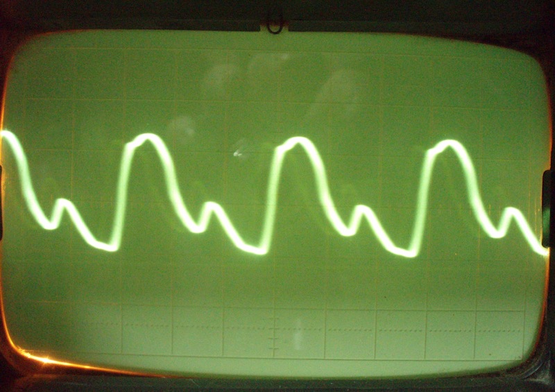

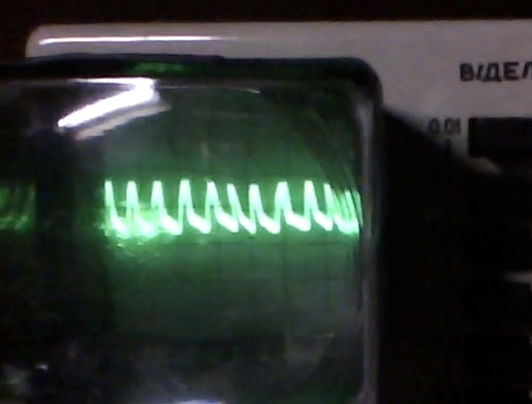

Finally had time to come back to this amp as well.
With my very old scope I was able to see the waveform on FETs gates, it should be square, right?
Anyway what I got is on the attached photo, v/del is I think 5V and time 0,2us/del but Im not sure, the explanations for buttons are in russian, I speak some russian but technical terms I do not know so well.
Sorry about poor picture quality and never mind the fish eye effect, the screen on the thing is so small that it actually has a magnifying glass in front of it. That glass creates the fish eye effect, next time I know to take the picture "straight".
Do you get a square wave at the output pins of the power supply driver IC?
If you set it to display only 3-4 cycles, you'll get a bit better resolution.

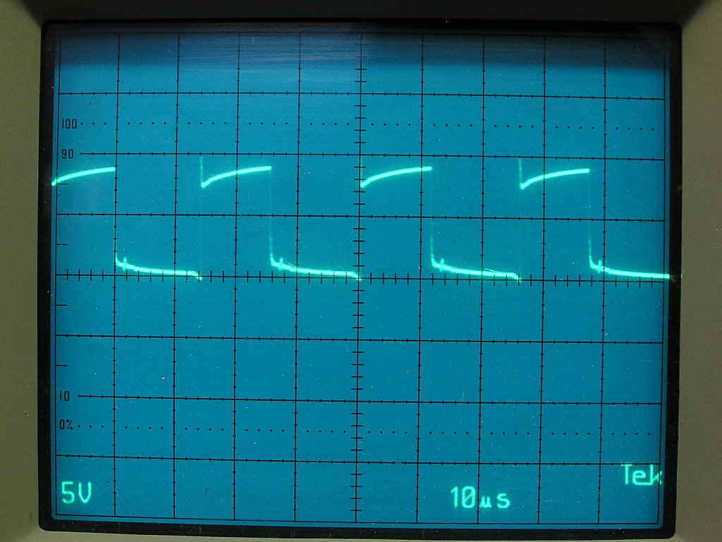

If this is at 0.2us, the frequency is too high. Do you have a sine wave generator or a test tone CD? if so, set either to 20khz and adjust the timebase to display 2 cycles. The power supply shouldn't have more than 4 cycles at that setting. Make a mark so that you can remember the setting.

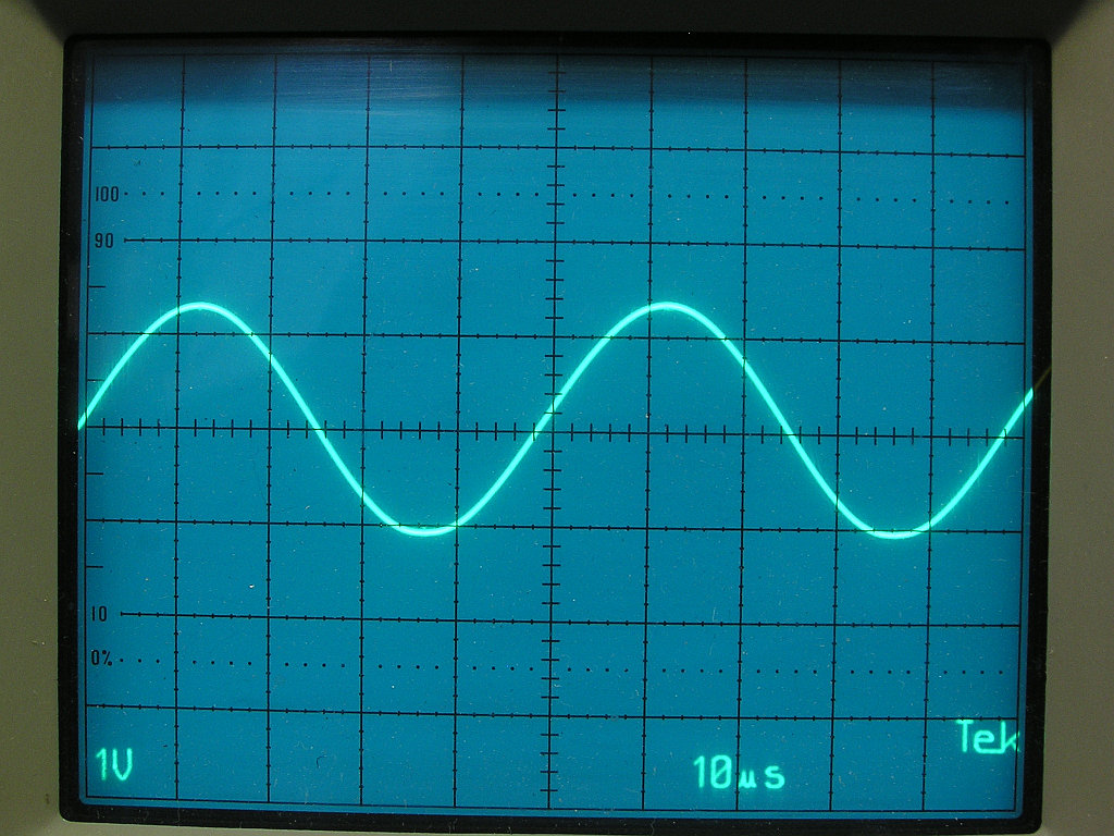

For reference, the attached images show a 20k sine wave and a 38k square wave from a power supply (gate drive). These are at 10us.

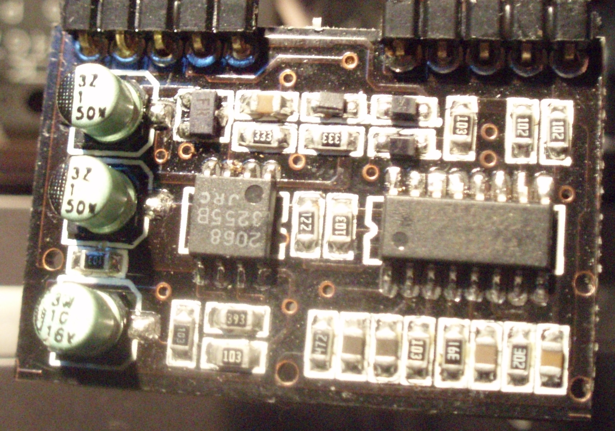

I cant get to driver IC with my probe, because it is located on a card between transformers.
I managed to check the pins of that card, did not find squarewave from them. Found similar waveform, that was on gates.
I have your tutorial and the test CD.
Seems that something on the driver card has failed?

Have you used your scope recently on a different amp to confirm that it can display a perfect square wave at that frequency?
I got a square from from another amp, that uses SG3525 as PS driver chip.
Also from a amp with TL494 driver chip.
I dont know if KA7500BD works at higher frequency compared to TL494, SG3525.

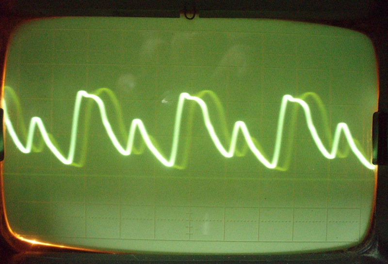

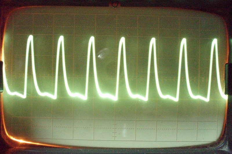

Got a bit better oscilloscope, they are hard to find used here in Estonia. Yesterday I saw that there is one for sale, so I picked it right up.
Took some new photos of waveforms produced by PS chip.
First one is from PS chips ouput, other photos are on the gate of FET amp idling, amp producing audio.
If the scope is set to 1us, the frequency of oscillation is too high. Check the resistor on pin 6. If it's within tolerance, the capacitor on pin 5 is likely out of tolerance.

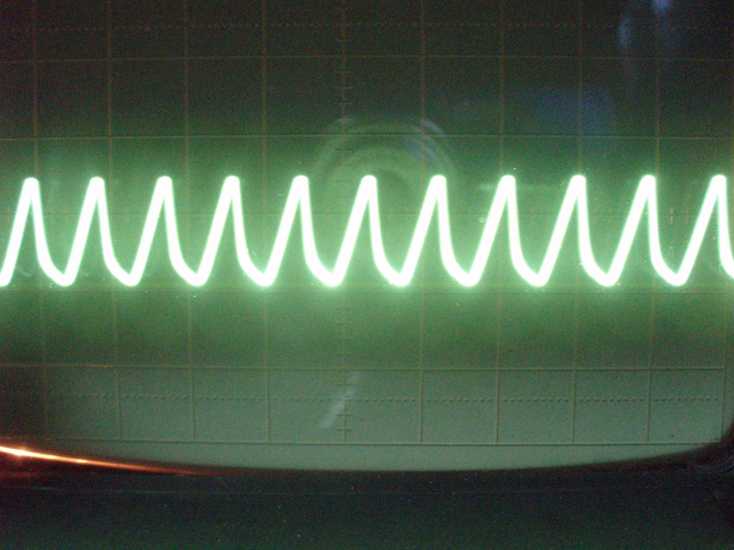

Pin 6 was 3,43 with limiter inline. Resistor reads 302, I measured 3k ohm of resistance across the resistor.
Waveform on pin 5 is a bit different from the photo of pin 5 waveform in your tutorial. Tried to probe another amp which I have lying around. From that amp I got the exact replica of waveform from your tutorial.
Photo attached, again 1us/del, 1v/del.
What is the value of the cap connected to pin 5? I did not see any writings on it.
I guess the marking is on the other side, I have to desolder the cap to read it.
