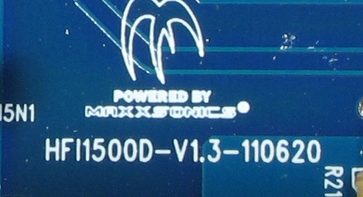

Hi Guys,

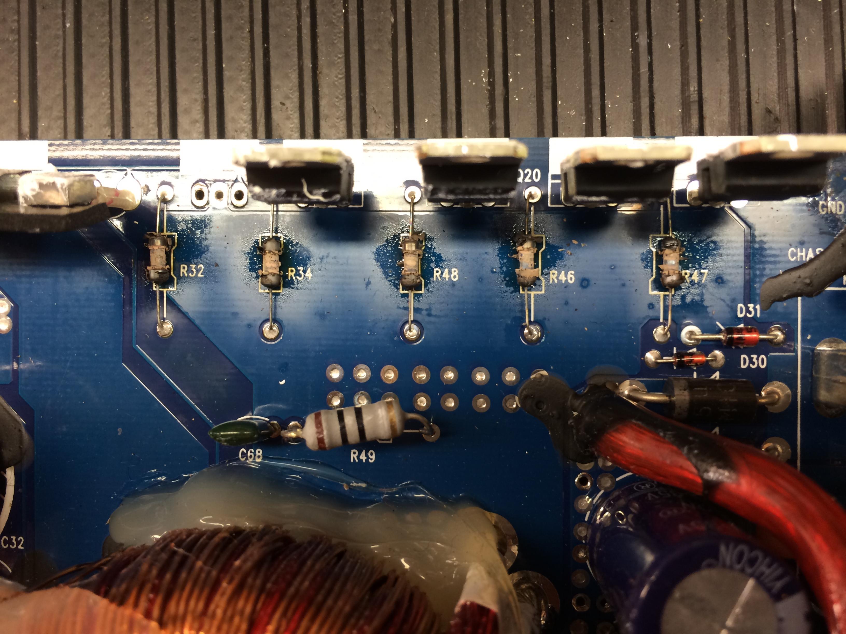

Working on this amp and I have found that all the power supply FET's are shorted, along with the drivers.
The gate resistors are all charcoal, can anybody tell me the value?
And, the FETS are p55N06's, do you think a P60N06 should be ok to use?
Tom
Perhaps not all of the gate resistors are burned down, so take them of from board and try to measure resistance value from each of them. Maybe someone shows you the right value.
I think it should be somewhere between 22-220ohms.
That 60N06 would probably work....it depends a bit from the driver transistors and gate resistor values. 60N06 has little larger Qg and Ciss so these need more ´power´ from drivers.

Looking at the datasheets for the IRF3205 and the STP60NF06, the Qg and the Ciss for the 3205 are much greater and the 3205s work with the 47 ohm resistors. The STP60NF06s would be a lighter load so there's no reason (that I can see) that the 47 ohm resistors wouldn't work with them.
Thanks to the both of you for your input on this issue. I installed the 47 ohm gate resistors, replaced the drivers with bd139, bd140 and finally 60NF06 (10 total). The Amp turns on and appears to function.
The question is, were would one find an issue if those gate resistors were incorrect or the FETs would not be compatible?
Would you expect to see the FETs over heat or would there be a problem when the amp drew a lot of current?.
If the resistor value is too high, the FETs will overheat. Even idling 1/4-1/2 amp too high (due to the resistor value being too high) the FETs could become extremely hot quickly. This is often masked with regulated power supply drive circuits at idle because the duty cycle is reduced. At full power, the duty cycle increases and the FETs begin to cross-conduct. This makes them much more likely to fail prematurely.
If you choose a value that's too low, it stresses the drive circuit more (not really an issue with those drivers) but I've also seen it cause nasty switching transients on the FETs.
