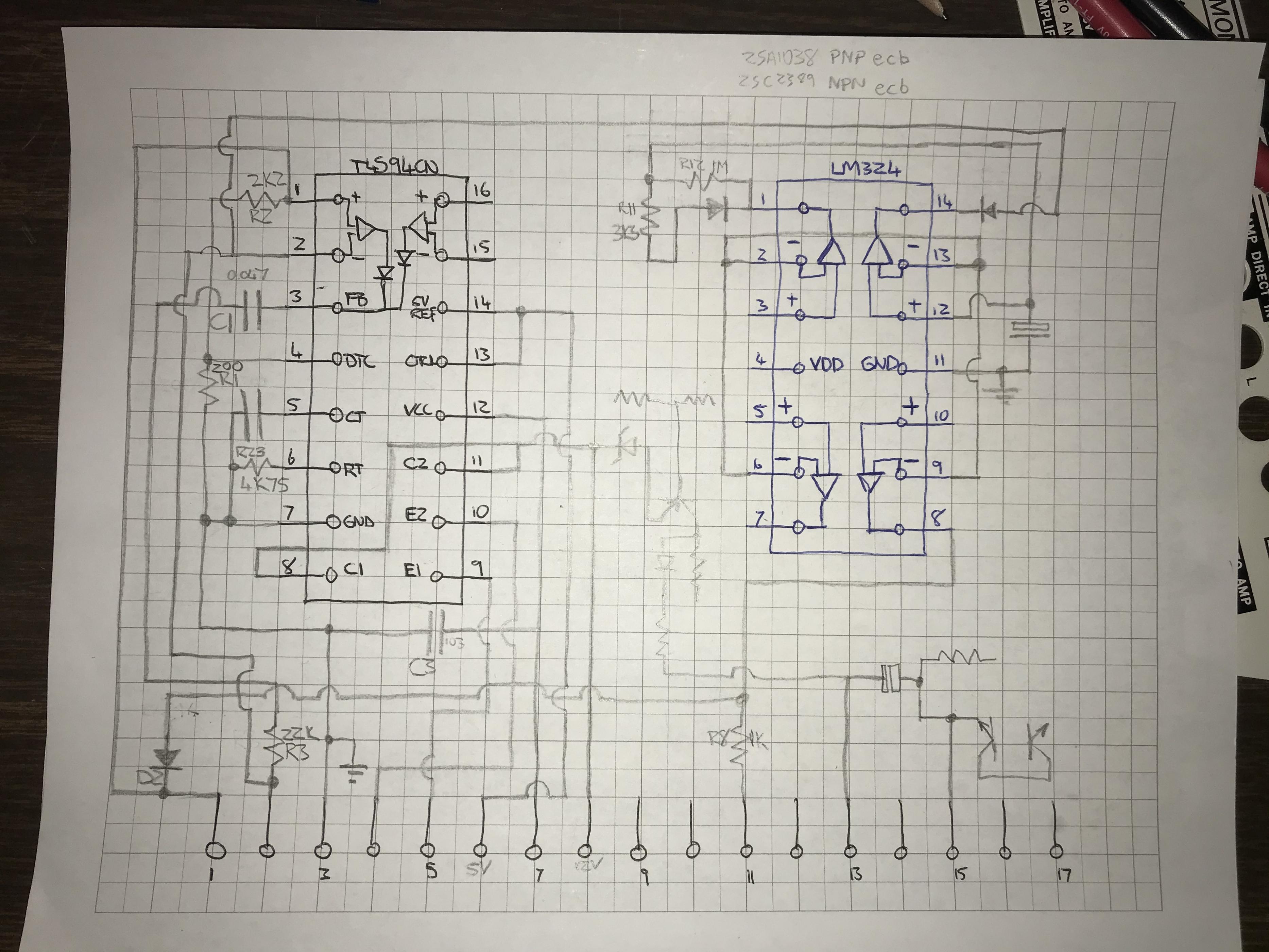

Here is a partial diagram of the Power Supply breakout board. It is not complete and may still have errors in it.
Pin1 on the board goes through a 43K to +47V and Pin 2 Goes to a divider formed between Ref (+5V) 2K2 and 43K to -47V.
I measure 8.2V on pin 1 of the 594 and only 4.954 V on the +47V side of the 43K resistor. It looks as if pin1 of the 594 is sourcing the voltage 😕

When the power supply was working correctly both pin 1 and 2 on the 594 was around 2.600 and 2.599 respectively. This only happened once and the LM324 was out of the circuit at that time.
I will go look at the voltages on the LM324 now and report back, but I could not find a connection between the LM324 and Pin1 on the 594.
That's what is supposed to be. The positive rail pulls pin 1 up and the negative rail pulls pin 2 down and when the two match, the power supply knows that the target rail voltage has been met and the duty cycle is rolled back. When pin 1 is so high, the 594 is being told that the rail voltage is far too high and the duty cycle is pulled back to 0%.

From that I would expect high outputs on all of the op amps, which is the case. As far as I can tell when the protection circuits are activated it pulls pin 15 on the 594 low and that is not happening when I see the fault.
Have you ever seen a failure where the 594 injects voltage into pin 1?
Thanks once again!
I kind of feel silly that I did not notice D2 driving pin 1 of the 594 high from the LM324.
I drew the circuit around pin 10 and it seems to me that if pin 17 on the PS driver board is pulled low, pin 8 of the LM324 will be latched on, shutting the 594 down.
Should I try running it with Q1 removed so that this circuit is disabled and see what I get on pin 17?
The latching for the 324 is output (P8) goes high and charges C5 Through R9 and when it is higher than inverting input (P9) through R10 it latches on.
So there is a bit of a delay because of C5. (I guess if C5 is leaking badly that could also cause this symptom, but I would think that is unlikely).
I did pull Q1 and it seems fine, but I like the suggestion of pulling D5 and testing it that way in the circuit, brilliant!

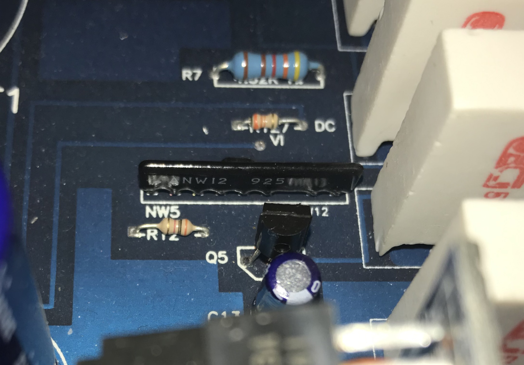

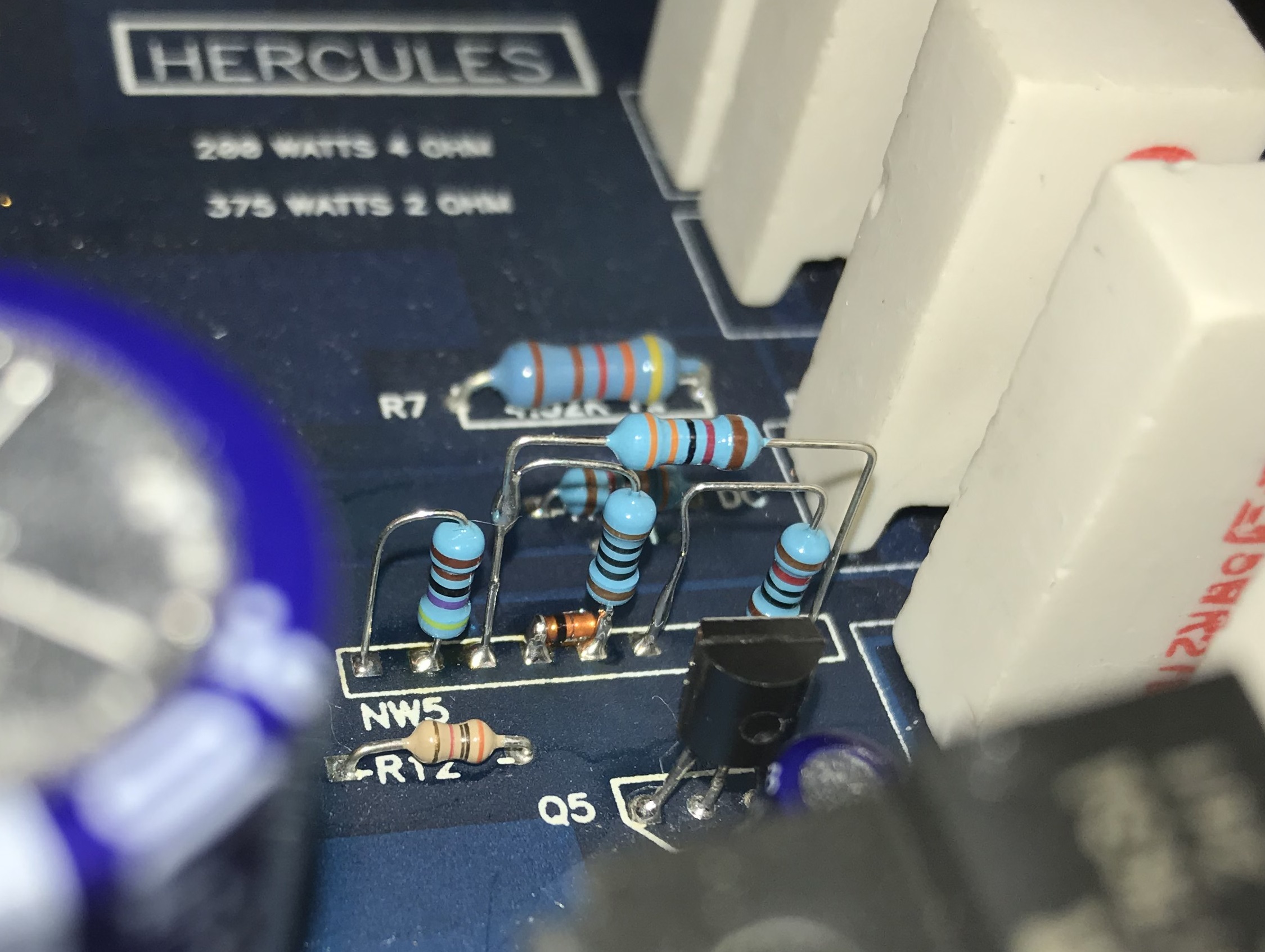

Thanks and Final Notes
I wanted to give a shout out to Mr Stephen Mantz from Zed Audio that helped me by providing information and guidance. Below is a description that he provided of the ANW12, which he has replacements for in stock, if you need any.
The description of the ANW12 is:
Looking at the network with the 2 key pins on your right and now reading from left to right which I shall call pins 1-6 then a space and then pins 7 & 8.
  • Pin 1-2 is a 4K3
  • Pin 3 has a 100R to a 33K which is on pin 8 (so pin 8 through this 33K connects to pin 3). Pin 3 in addition has a 100R to pin 5
  • Pin 4 has a 1N4148 diode to pin 5 with cathode at pin 4
  • Pin 6 has a 10K to pin 7
I interpreted this description into the attached Diagram.
I implemented this with discrete components using 1/4W 1% Metal film resistors shown in the attached picture.
Thanks again for all the help from everyone!!
