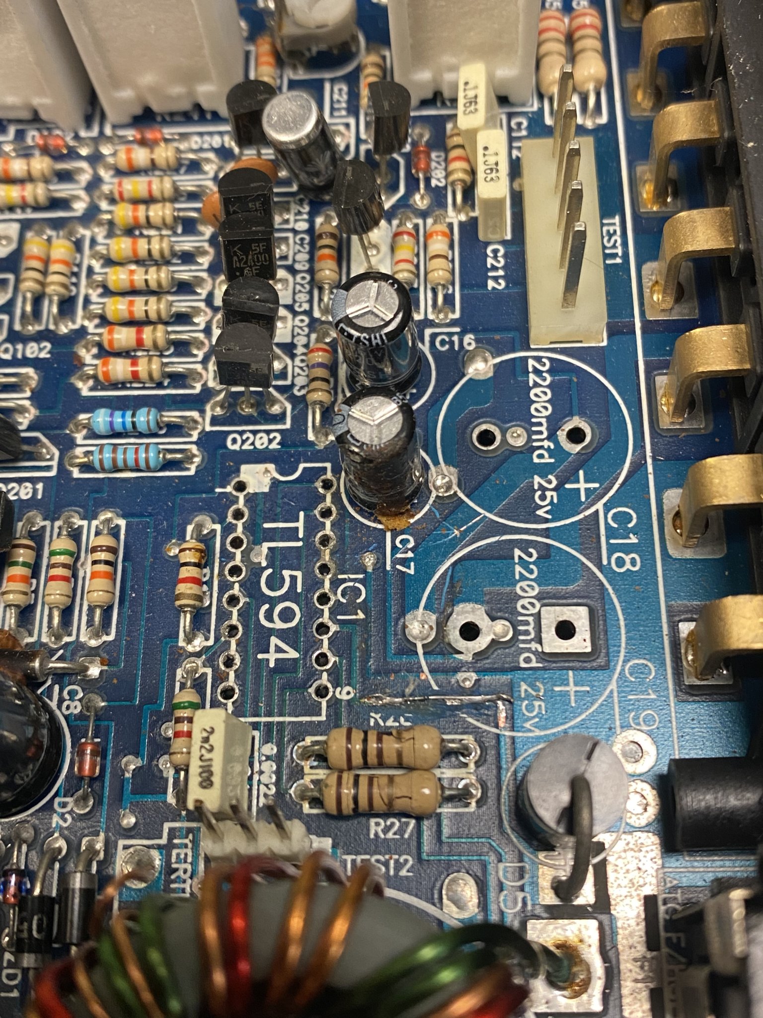

Amp will not power up here is what I get on the 494
Pin 1:4:53
Pin 2:4.53
Pin 3:0.04
Pin 4:0.44
Pin 5:1.45
Pin 6:3.42
Pin 7:0.00
Pin 8:1.62
Pin 9:0.02
Pin 10:0.02
Pin 11:1.67
Pin 12:13.67
Pin 13:4.93
Pin 14:4.93
Pin 15:12.93
Pin 16:6.84
