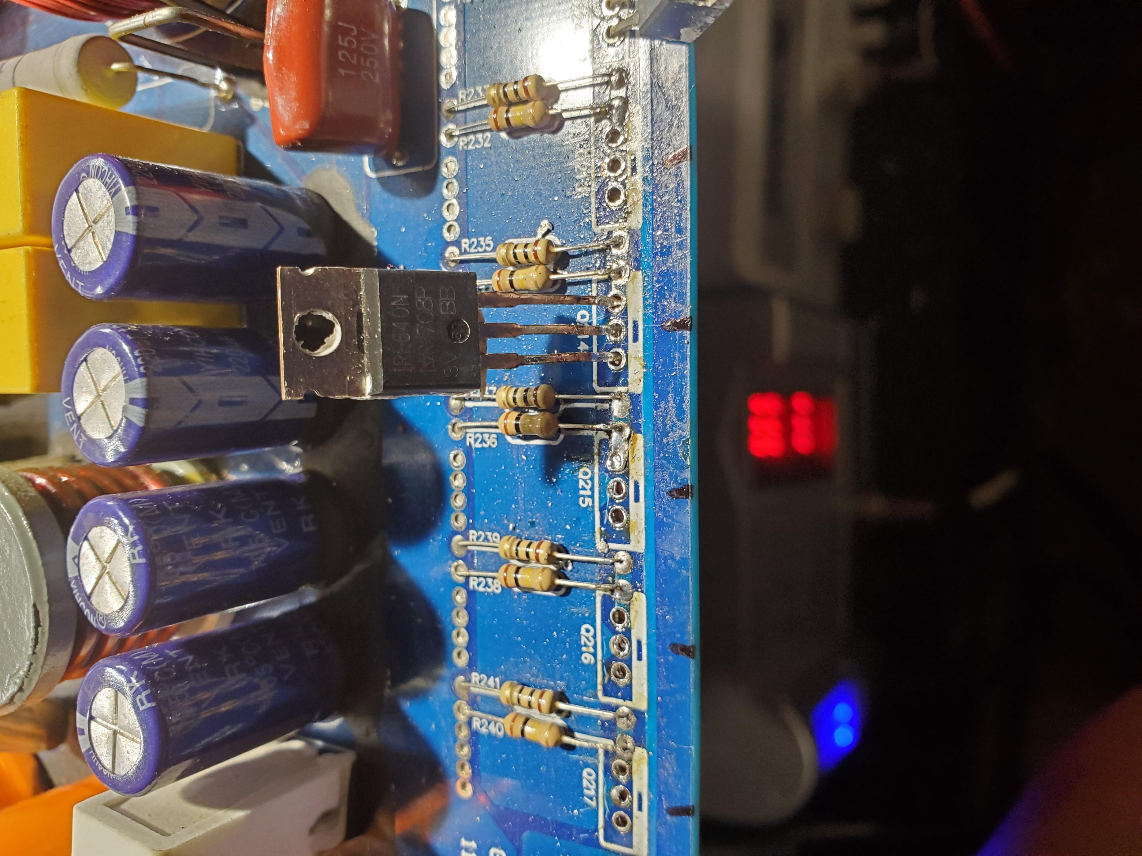

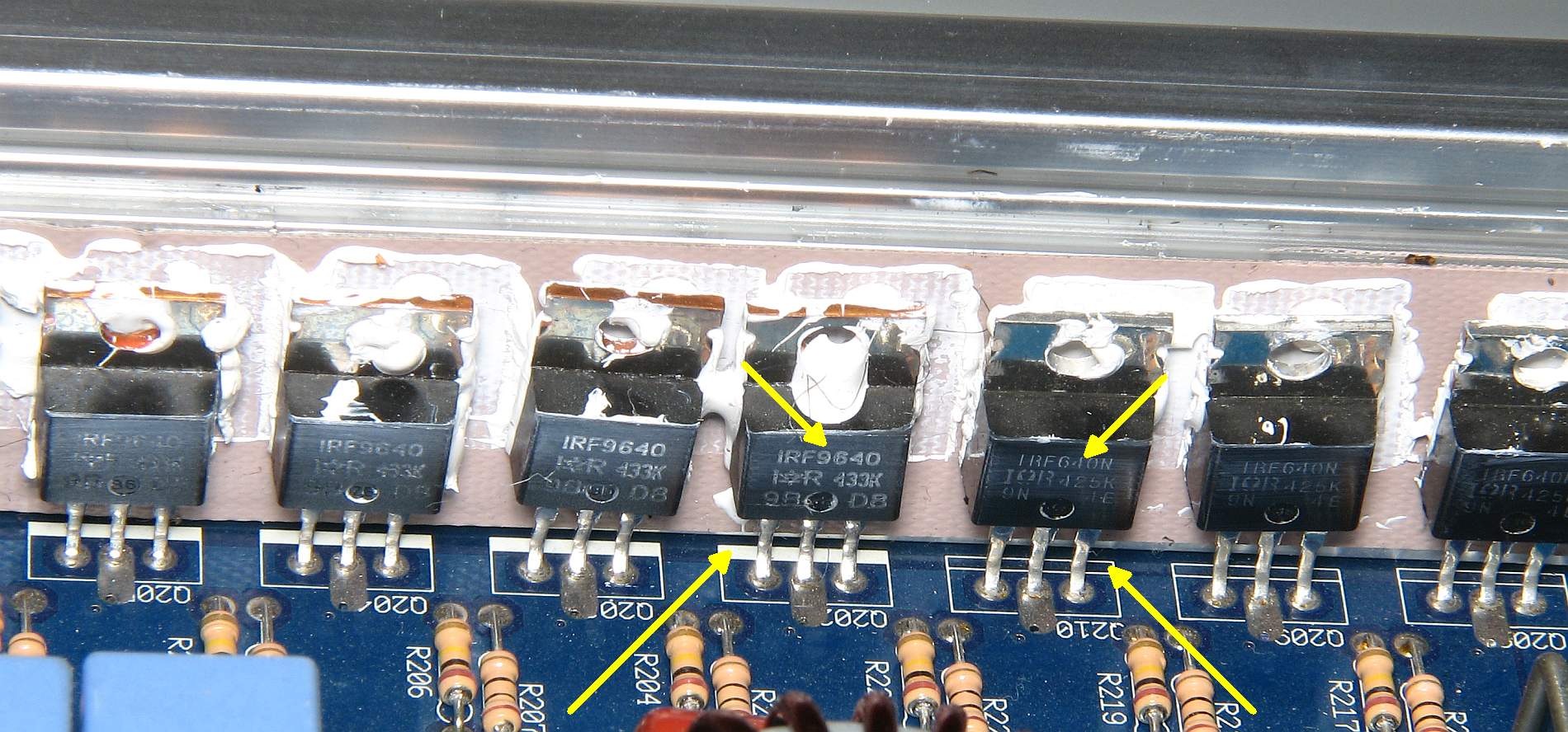

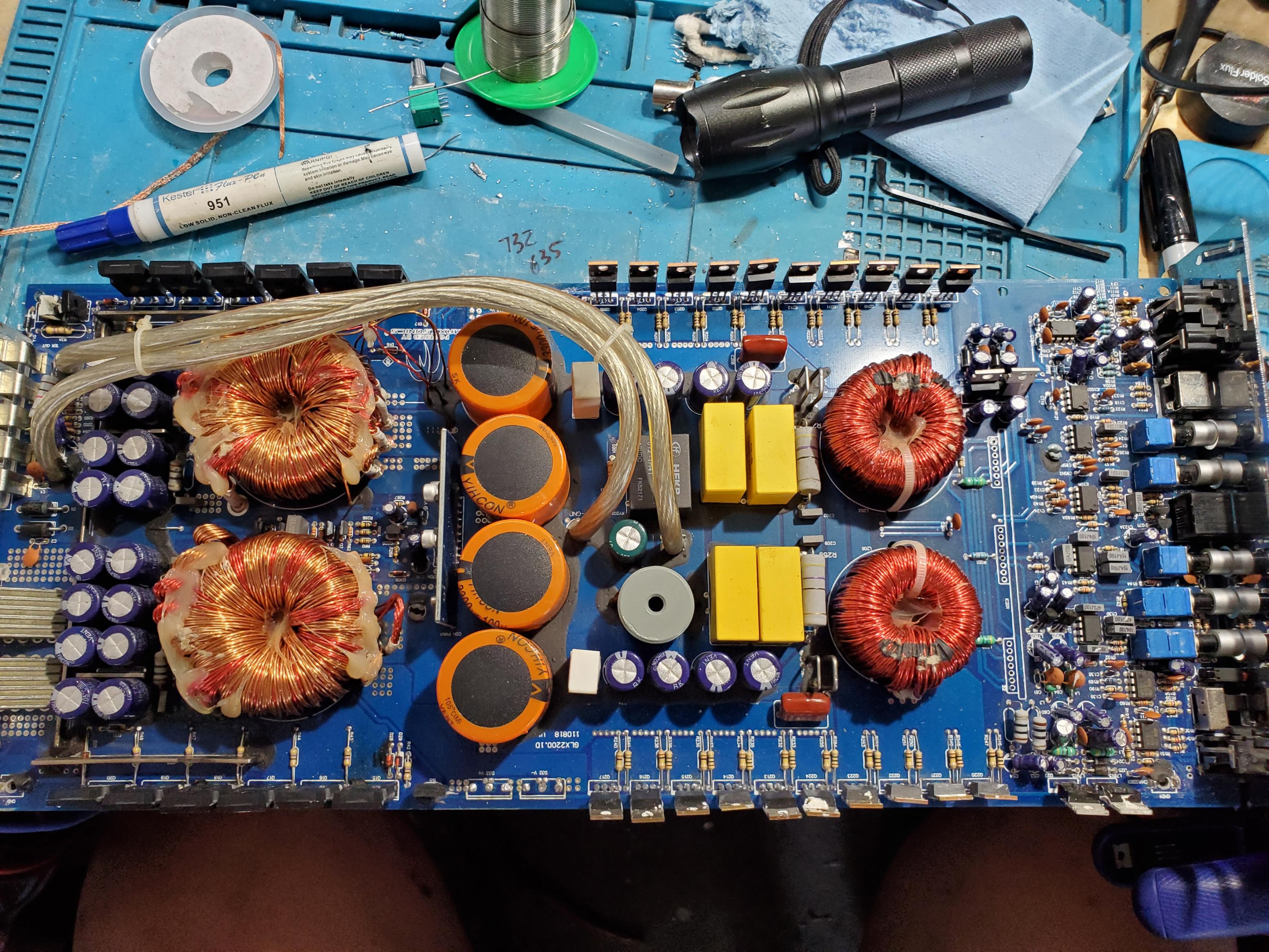

So I have rebuilt everything on this amplifier. The power supply and driver transistors all runs nice and smooth. So moved on the the output section of the amplifier. Which was entirely missing.
Q213-q217 irf640N
Q220-Q224 irf9640
Q201-Q205 irfirf640N
Q208-Q210 irf9640

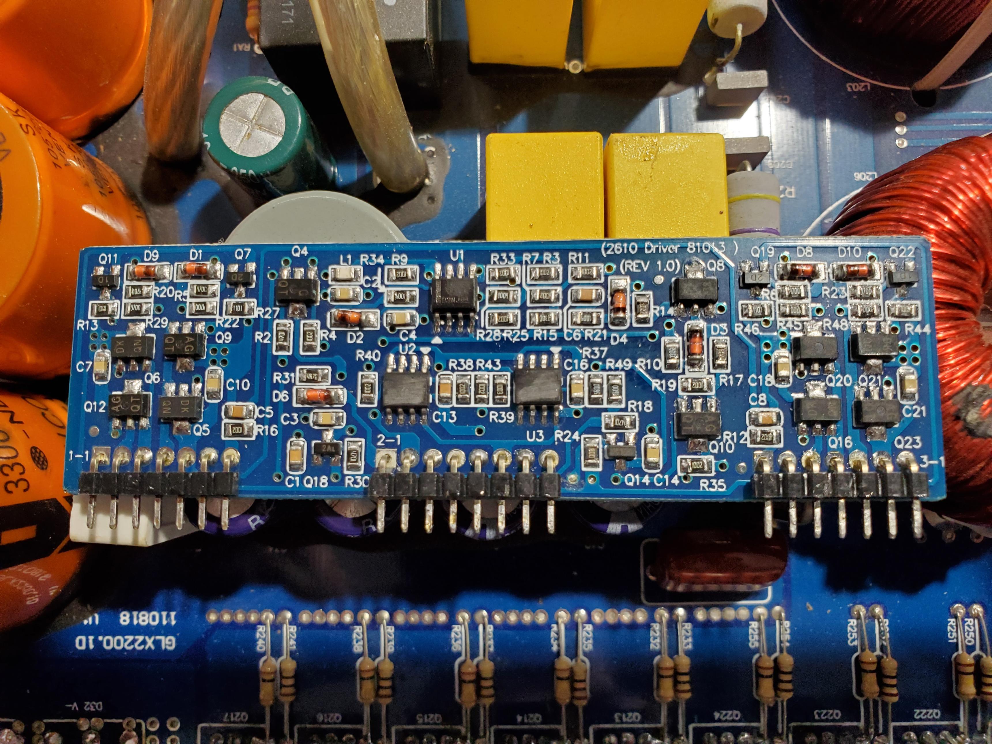

I went through the driver card as well. Checked all the regulated voltage as well.
Reinstall the rectifiers and apply b+ and ground and remote, high current? I just don't know what else can I check the rectifiers seem ok,
I can't seem to find the cause of the current.

Rectifiers are removed outputs are in the amplifier. And the driver board is currently out. I removed it to check all the 470R resistors and drivers on it when I couldn't fiqure why it is drawing so much current.
Power supply runs perfect alone.
