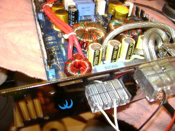

Need to order some compacitors for Hifonics 1606d amp however I dont have the amp with me at the moment. Does anyone know which capacitor it is? The capacitance and the voltage ? thanks
Which capacitors?
The primary filter caps are 2200@25 rated for 105C. They are 25mm tall and 16mm dia.
I've attached a pic that I found here on the forums. the pic is a hifonics amp but looks like it has different caps. the pic is for reference only to show the location of the capacitors that I'm looking to replace.
