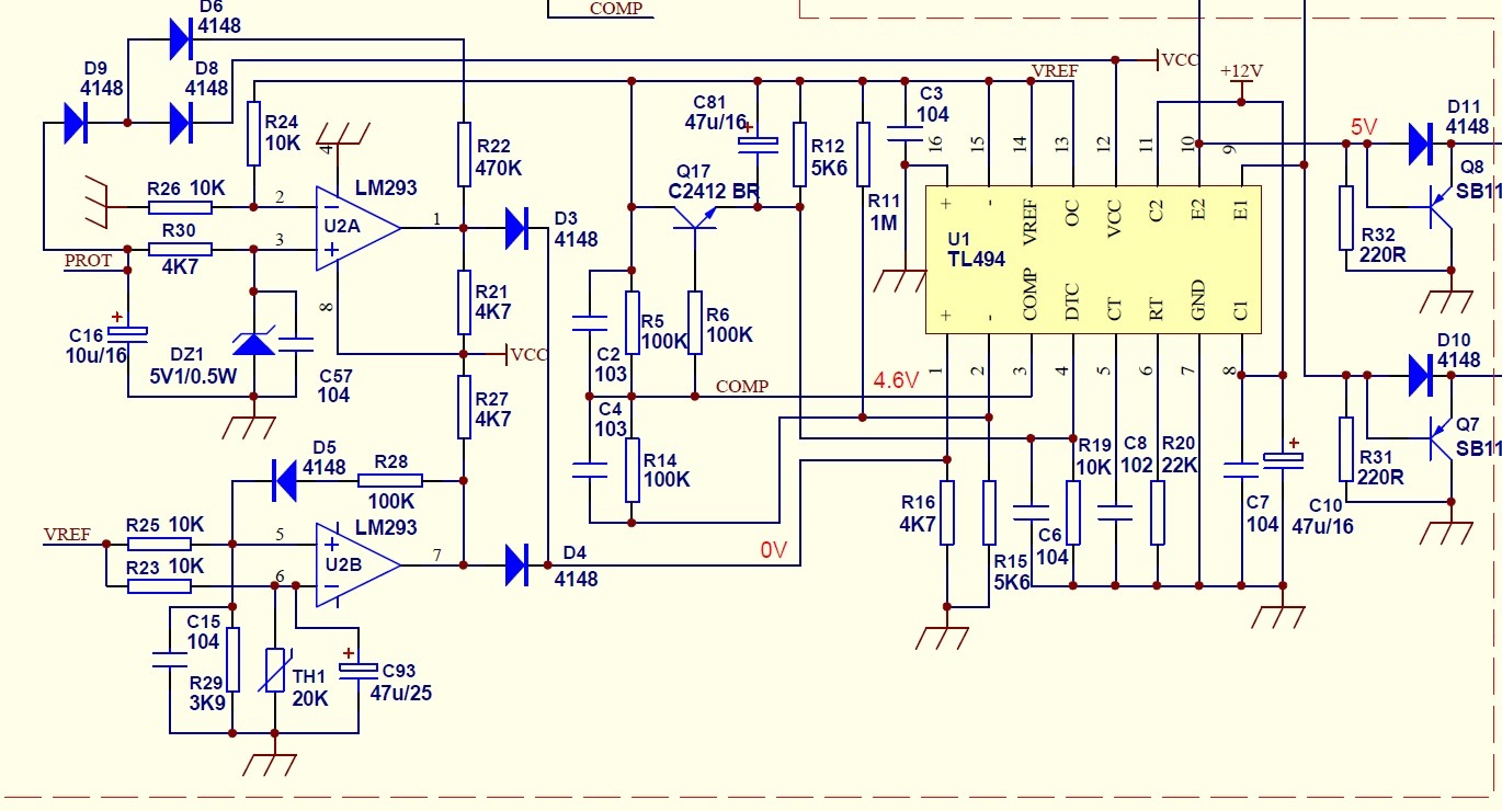

Hifonics BXL2000D protection circuit issues

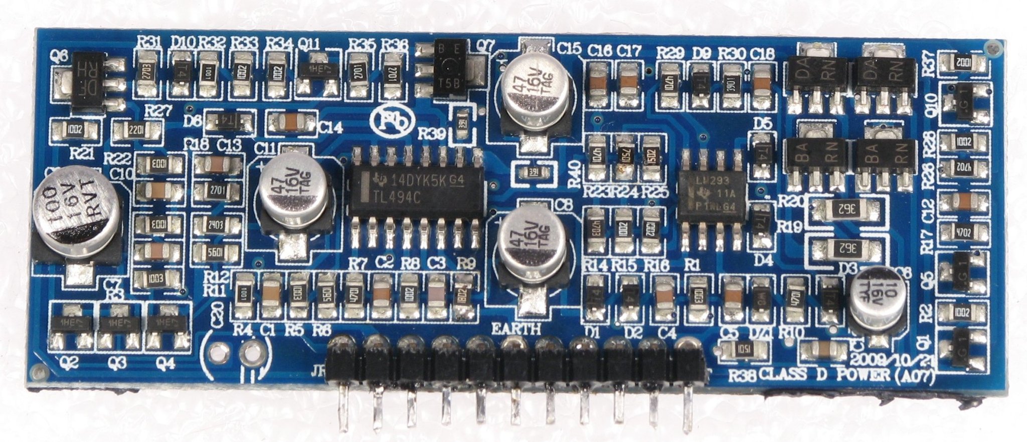

Is pin 15 at 5v and pin 16 at 0v? They should be. = they are.
To try to confirm, connect a resistor 1k or higher between header pin 2 and ground. = relay clicks in now, amp lives.
The 494 side is still higher (especially if it's still over 2v), that would tend to indicate that it's the 494. = with 1k resistor from header pin 2 and ground - pin 3 TL494 goes to about 0.2v
Header Pin 2 = 0.1v
SD at the IRS = 3.9v with the 1k resistor
