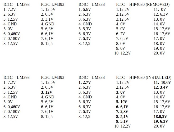

I got the Hifonics Brutus BXi1100D amplifier.
Unfortunately, someone was fixing it. Missing items.
What should the transistor Q101 be like?
The transistors in the inverter are IRLZ44N?
Power transistors are IRF3710Z ??

I'll start from the beginning.
I am a beginner electronics. I had no contact with a class D amplifier. Unfortunately, I do not have an oscilloscope, I do not know if I can repair it. I await delivery of the items.
I installed IRFZ44 in PS. When supplying a 12V amplifier, I get +/- 60V on the PS output. The red led is on. Power transistors (IRF3710z) are removed. HIP4080 removed.
I am asking for help in repairing and gaining new experience.
Gives voltage:
