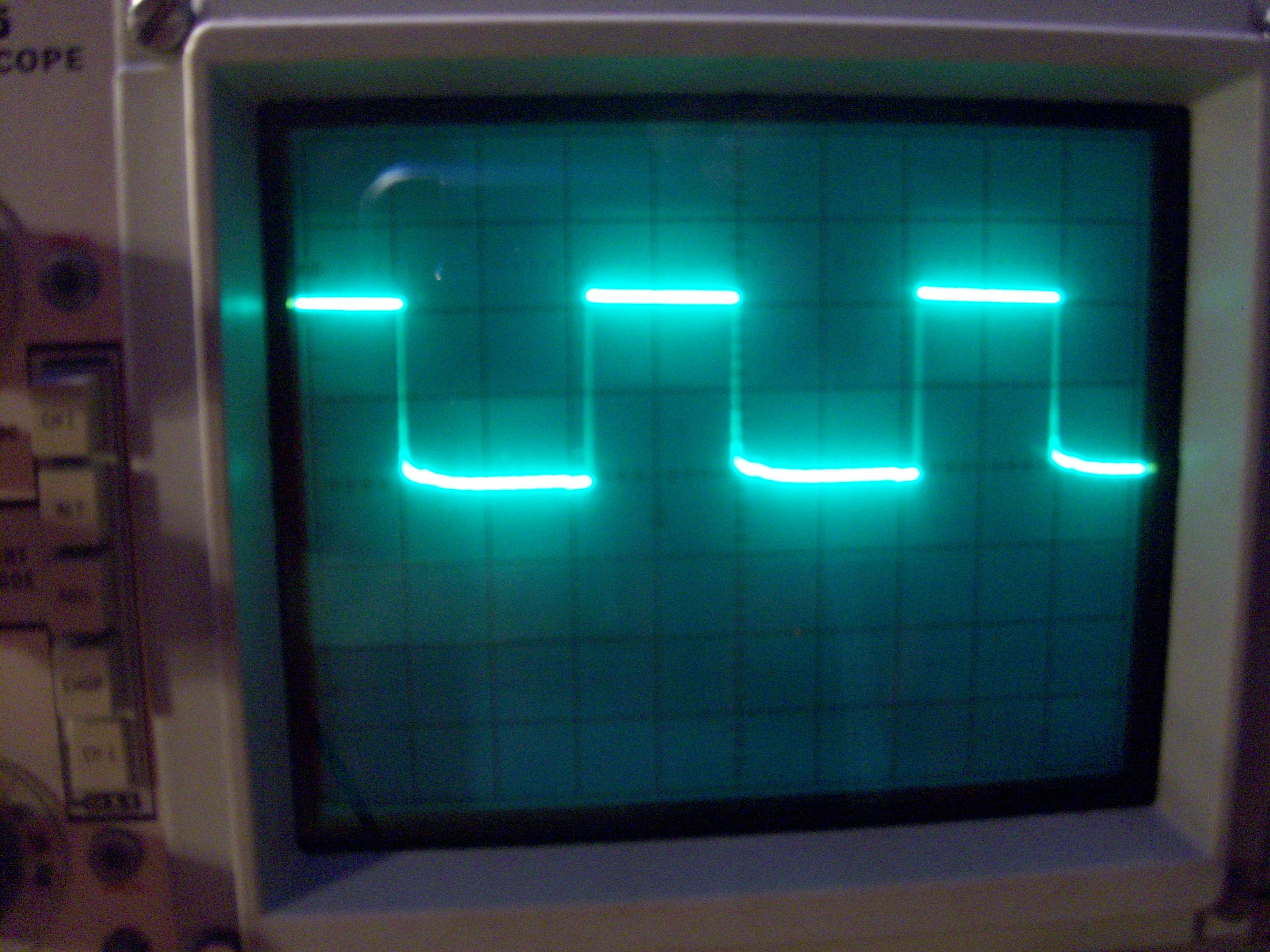

Installed gate resistors and had a look at the drive signal before installing any p/s fets and it looks a little funny to me. Iys not very square on the bottom.
Scope settings were 10us/5vd
I have 2 of the FMU-32U doublers removed is this why?
Maybe I should have a look at the drivers?
What do you all think?

Adjust your scope probe to match your scope. There shouldn't be a spike on the leading edge. The bottom of the scope page of the site shows you how to adjust it.
I almost always put new drivers in the hifonics I do anymore. I've had more than one that had a clean gate signal with no fets installed only to have a muddy signal once the first few fets were populated.
I have tried adjusting it with no success I even tried 3 different probes. Maybe my scope is messed up.
I cant get channel 1 to even trigger. It was working fine when I purchased it.
I have been using channel 2 this whole time and have never really used channel 1 except to test it when I first got it.
I used channel 2 again for the test but changed my settings to .5vd/10us scope probe set to 10X and this is the signal I get from the drive circuit.
How does this look?

My 18" subwoofer is close to my scope, when testing can the bass mess with the scope and screw it up?
It can cause the trace to shift (from the magnetic field). If the scope is exposed to a lot of vibration it could cause the calibration to drift or cause some of the components to come out of their sockets.
OK noted...... move subwoofer away from scope as far as possible!!!
