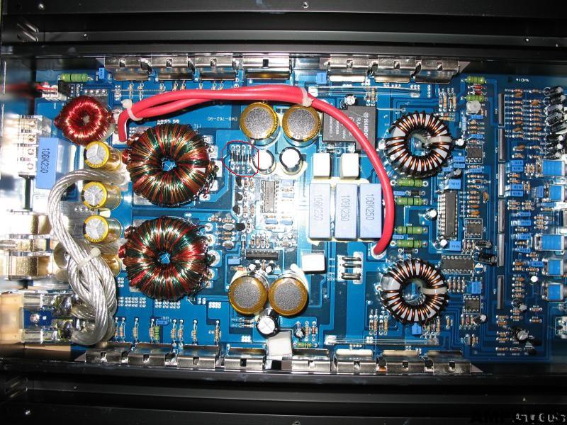

hi there, i'm new in here and need some help with same amplifier.
i dont create new thread and continue with this one.
HIFONICS bxi 1606d:
problem occured when i find out that my car leaks (some componets where wet).
494 works fine - outputs are OK, all mosfets seems to be fine, but hip4080 goes wery hot.
when i take out 4080, amp switches power-on stage (green) and when i put it back, LED switches to red...
what to do? replace only hip4080?

If the outputs are not blown, replacing the 4080 may be all that's necessary. They often fail for no apparent reason.
i replaced 4080 chip and discovered new problem, transformators give only 8 volts output.... and speaker makes zizzy sound....
any ideas?
any ideas?
sry my bad, to high frequency for multimeter, powre outputs are OK
but strange noise come out from speaker and audio in signals change nothing...
In many of the hifonics amps, the primary filter capacitors fail and can cause all sorts of problems. If the DC voltage across the power terminals is remaining above 12v, try connecting a 1500-2200uf capacitor directly across the power and ground terminals to see if that helps.
