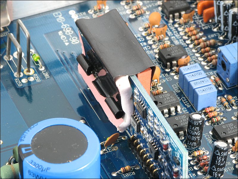

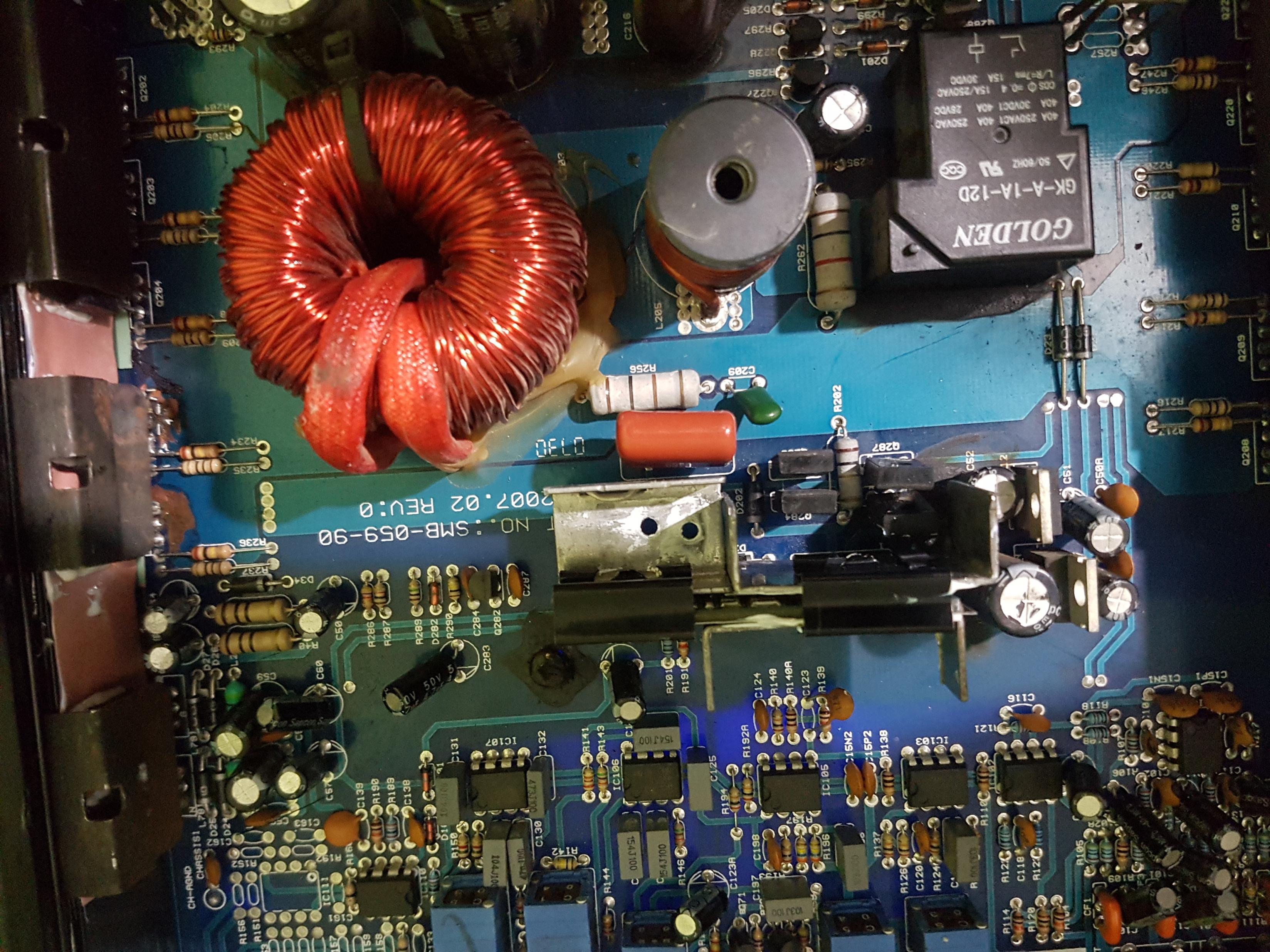

The front is where I put the gap pad. Make sure that nothing can short to the components or terminal strip.
M Mjimenez Member Joined 2017 2018-01-13 11:34 pm #22 2018-01-13 11:34 pm #22 on the side of the components you say? P Perry Babin Member Joined 2003 bcae1.com 2018-01-13 11:56 pm #23 2018-01-13 11:56 pm #23 Yes. the component side. Attachments IMG_9292b.jpg 152.2 KB · Views: 89 M Mjimenez Member Joined 2017 2018-01-14 12:05 am #24 2018-01-14 12:05 am #24 Oky I will do it M Mjimenez Member Joined 2017 2018-01-14 12:15 am #25 2018-01-14 12:15 am #25 what material is the sponge P Perry Babin Member Joined 2003 bcae1.com 2018-01-14 12:44 am #26 2018-01-14 12:44 am #26 Thermal gap pad. GAP PAD VO Ultra Soft - Thermal Materials by Henkel M Mjimenez Member Joined 2017 2018-01-14 4:02 am #27 2018-01-14 4:02 am #27 Ready Perry Babin thank you for your tutoring Attachments 20180113_214416.jpg 1,012.5 KB · Views: 108 20180113_214701.jpg 957.5 KB · Views: 71 20180113_214642.jpg 954.4 KB · Views: 67 M Mjimenez Member Joined 2017 2018-01-14 4:07 am #28 2018-01-14 4:07 am #28 Thank you Jason Smith 616 for your support, you gave me your regards Prev 1 2 First Prev 2 of 2 Go to page Go Status Not open for further replies. Share: Facebook X (Twitter) LinkedIn Reddit Pinterest Tumblr WhatsApp Email Link Home General Interest Car Audio Hifonics bxi 1606d led red
