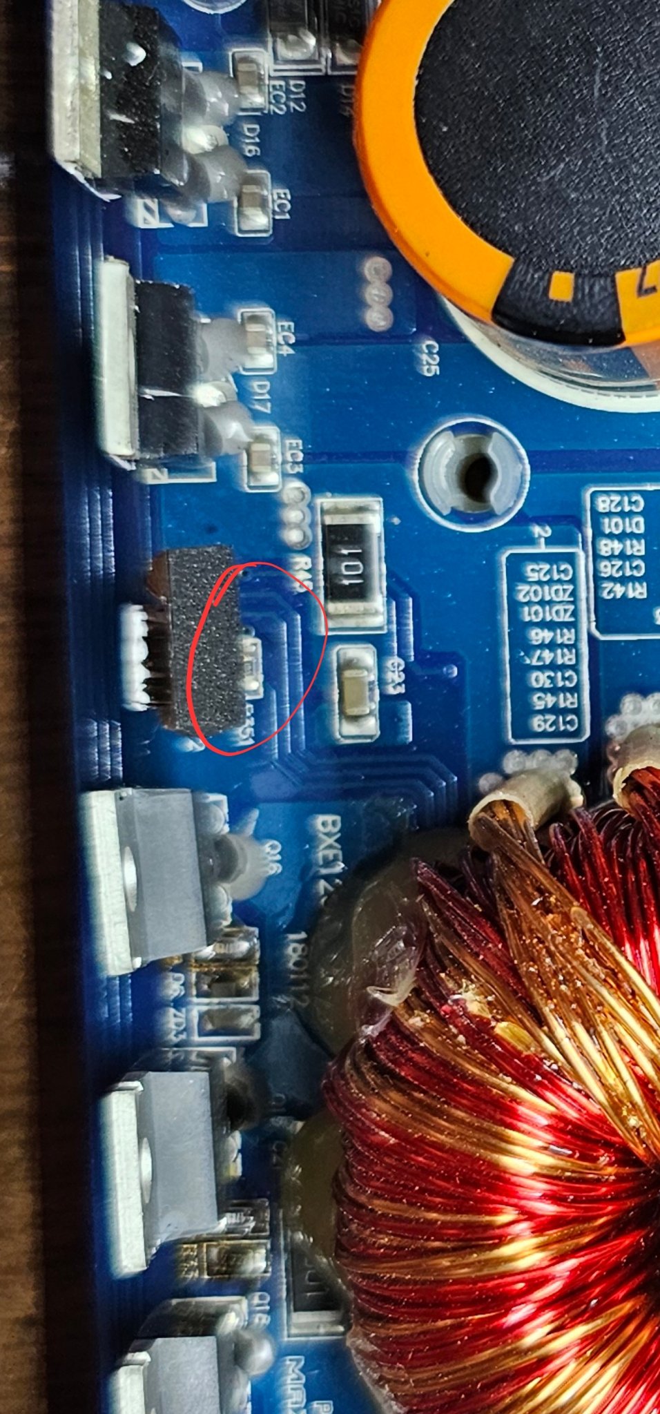

Hello friends, I am looking to solve this problem. It is a hifonics BXE1250.1D amplifier, initially the problem was in the power supply and it was solved, but now in the output I have oscillation and voltages of +-15v in operational amplifiers and still apparently no audio signal arrives which appears to be an irs2010s, but when I touched parts of the pre-amplification I managed to see audio at the output of the amplifier, I already changed some operational amplifiers and I couldn't get it to work beforehand, I appreciate your support and send greetings to the group
Have you tried operating all of the pots and switches through their entire range with a signal source connected and a speaker connected to the dead channel to see if the channel ever produced any sort of sound (even if it was just static/noise)?

For a standard head unit, the output RCAs should read 0 ohms to its case. If it doesn't, that needs to be resolved. This is one solution, or you could go into the head unit and repair it.
If the head unit is being powered by the same power supply as the amplifier, the case of the head unit should read 0 ohms to the ground terminal of the 12v power supply.

Well, I have tried to repair the main unit and it seems to work fine, what I found wrong was an open 1k resistor of the amplifier that is located between the secondary ground and the main power ground and it gave me sound, although very low. Previously I repaired one of these amplifiers and it worked in the same way, I lost a lot of time trying to solve and in the end with a good car radio, it worked well (my car radio is not good), I hope that is the case, greetings and thank you very much Mr. Perry Babin .
