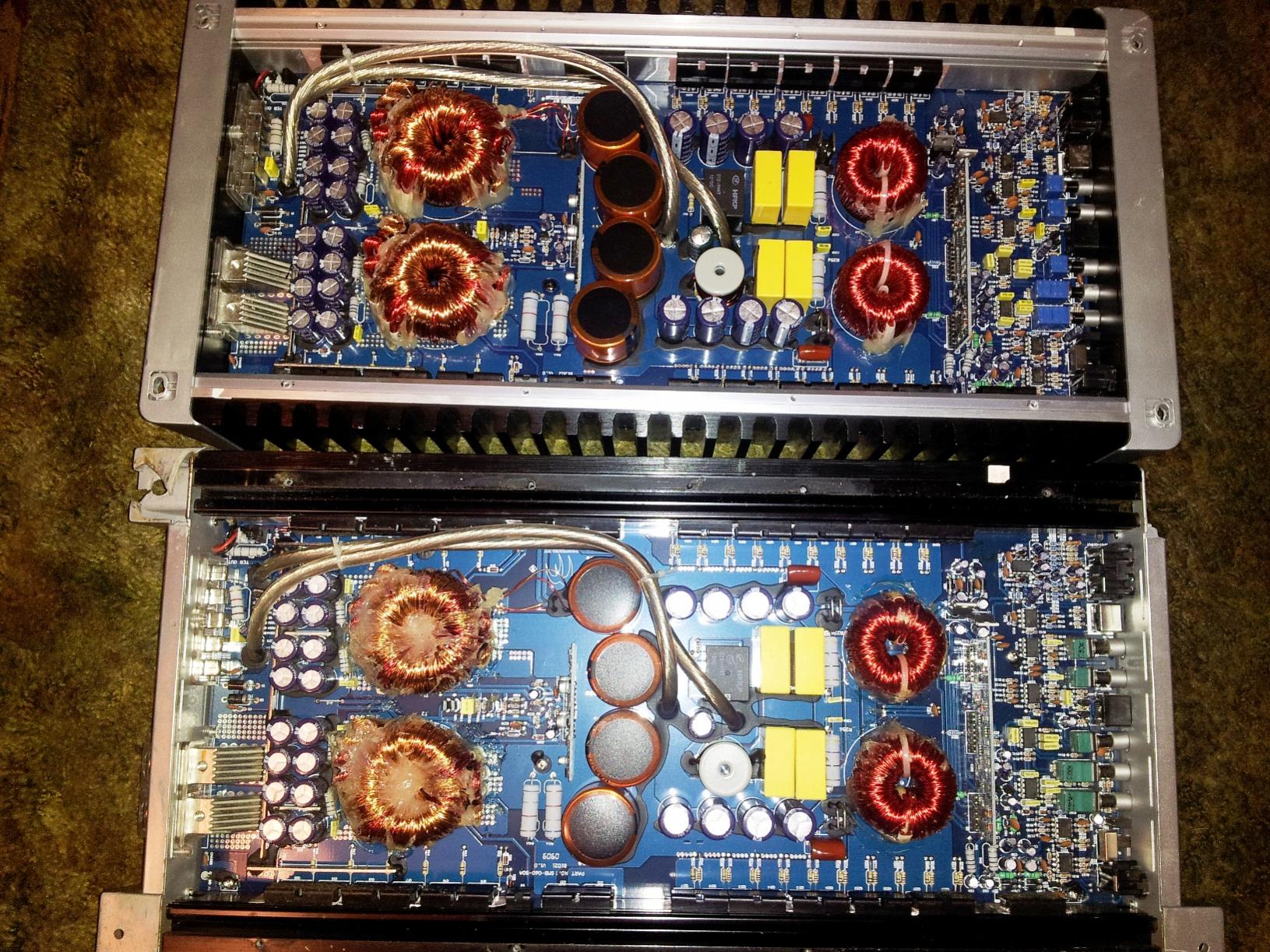

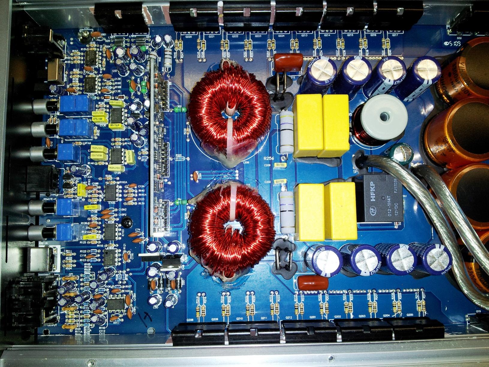

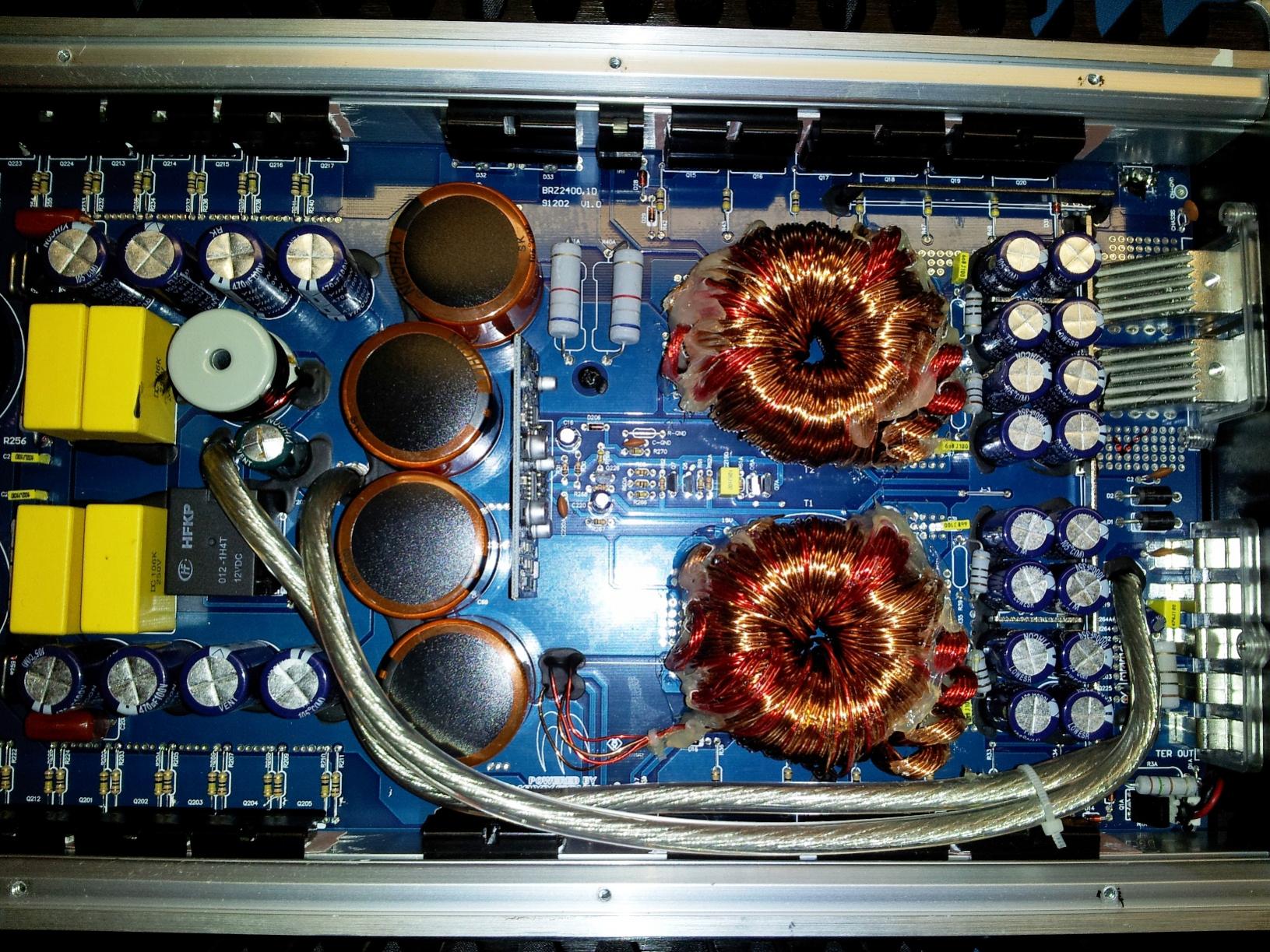

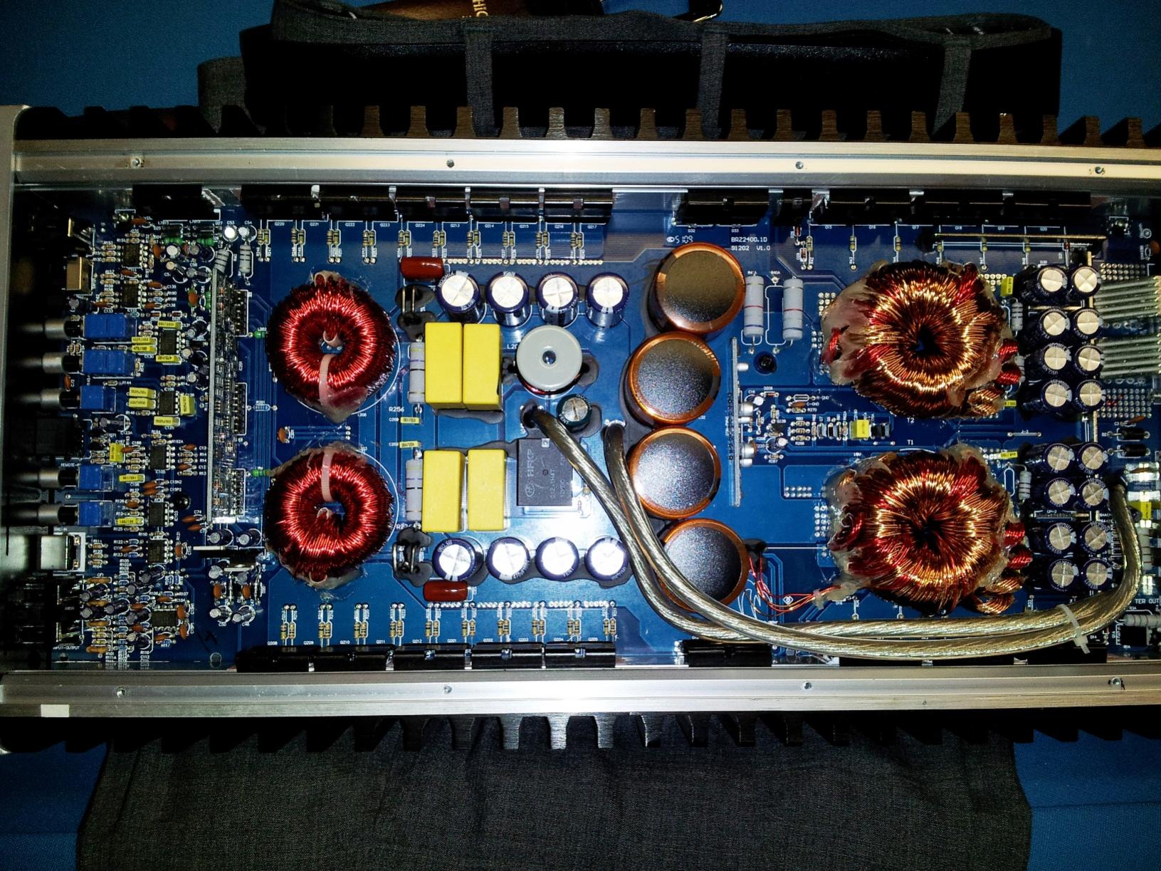

So I had thought that I fixed my amp but a week ago I went ahead and installed it for the first time since the repair and it plays but goes into protect regardless low/medium/high volumes. I haven't opened the amp yet but I was wondering if you think my driver board has bad transistors like you mentioned in the earlier posts?
I opened the amp and all fets on the sides are good. I hooked it up on my test bench with my two 8 inch subwoofers at 4 ohms using RCA to 3.5mm audio jack. I was pplaying the amp as loud as my subs can take it which I clamped out about 300 watts going to the subs.
Weird thing is that I am playing it moderately for long periods of time and it never went into protect. But when I play it in my car it goes into protect at low moderate levels...Does it have to do with the Driver board and/or the fact that my head unit is giving the amp 4 volts preout? Please let me know.
