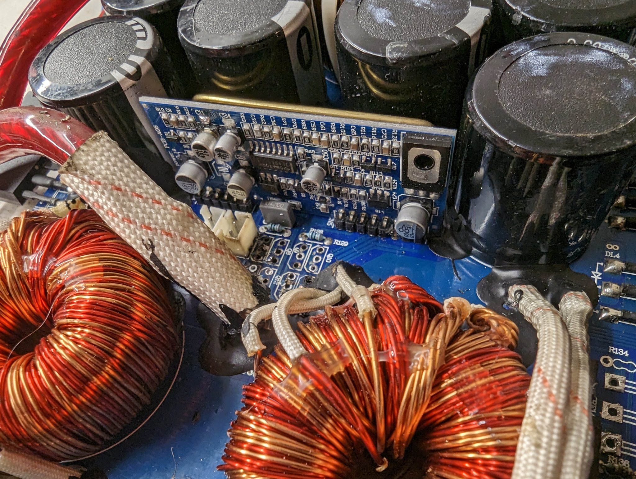

Received this amp with burned power supply. Mosfets and drivers are gone.

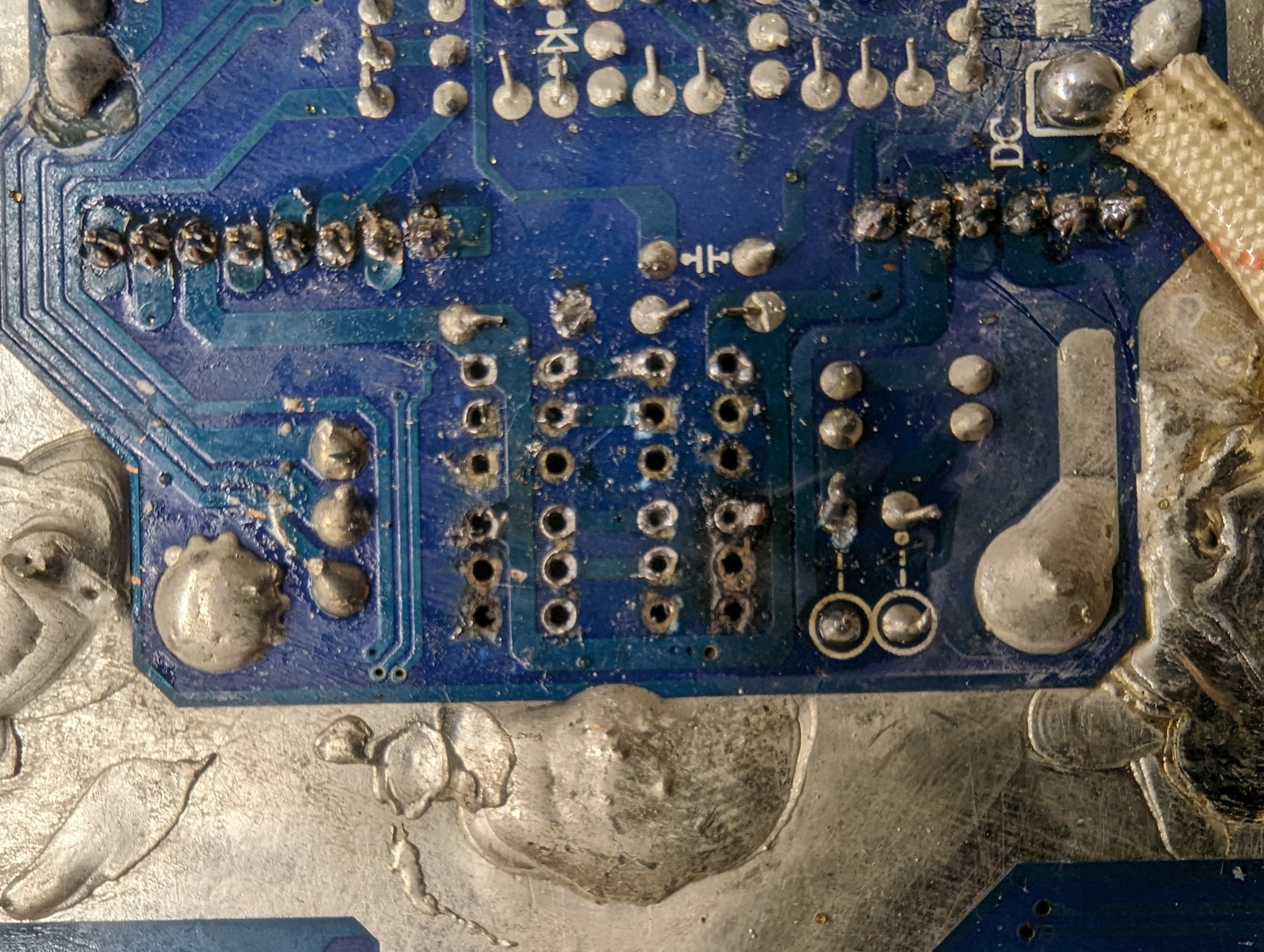

Removed all Fets and Gate resistors.
Fet drivers are C2383
and A1013.. Same Pinout as BD139/140 ECB

TL494 and drive card is ok. But one Drivewave has 8V Amplitude, the other 12V Amplitude.... All parts are removed, but it seems, that the problem occurs from mainboard.

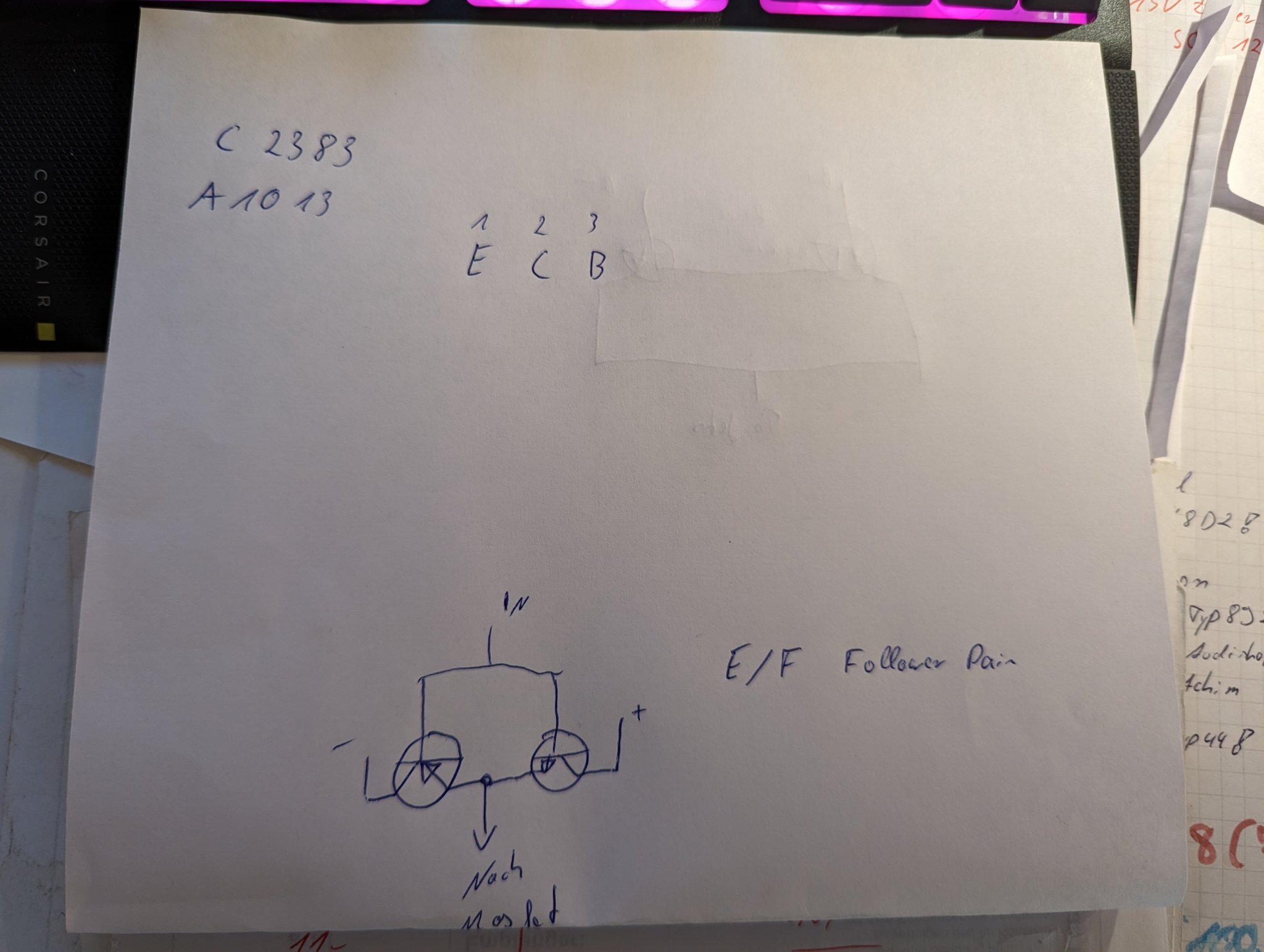

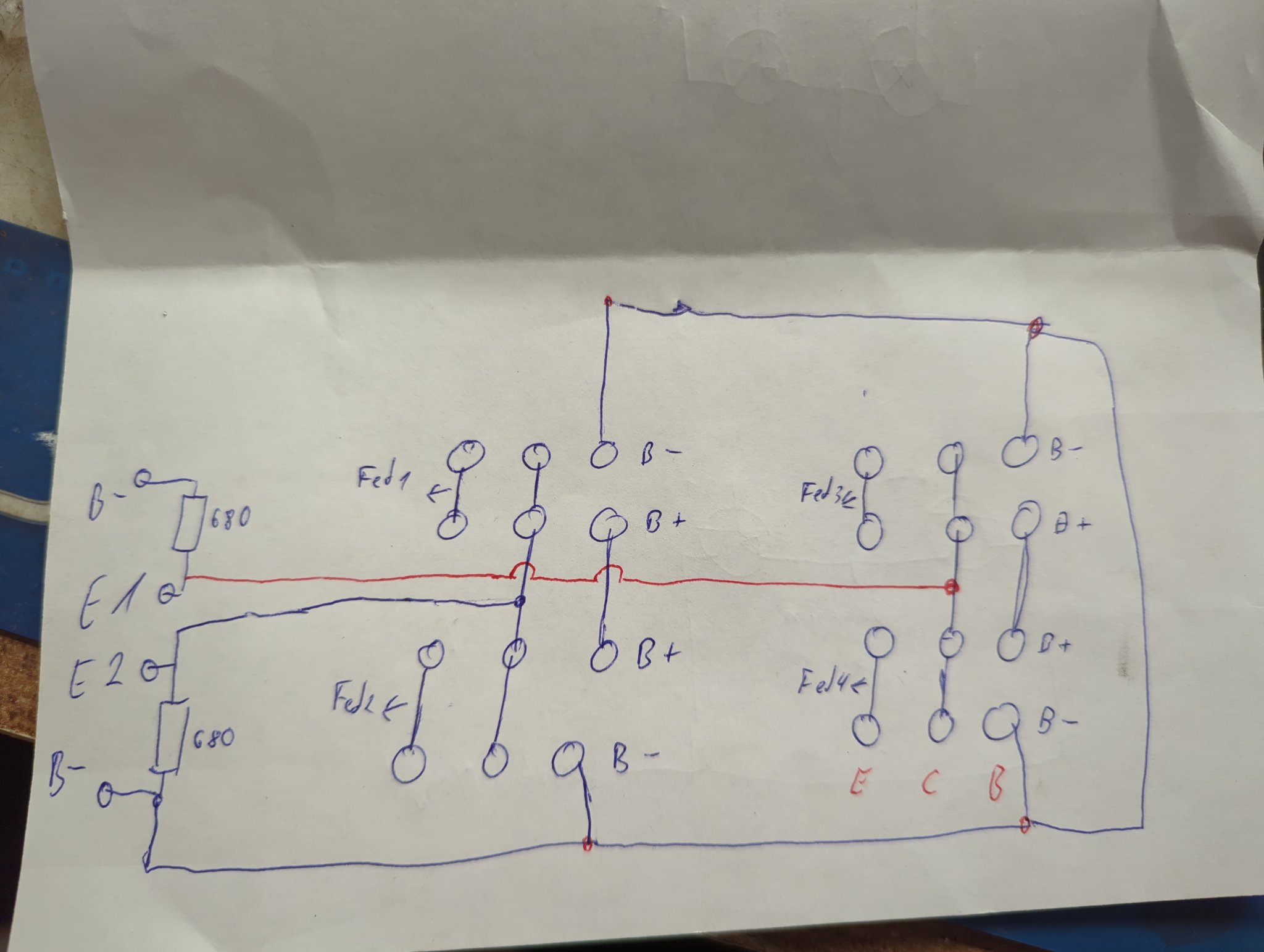

Second Problem: Somehow the driver configuration is strange, and doesnt work.
Normally it is E/F follower pair.

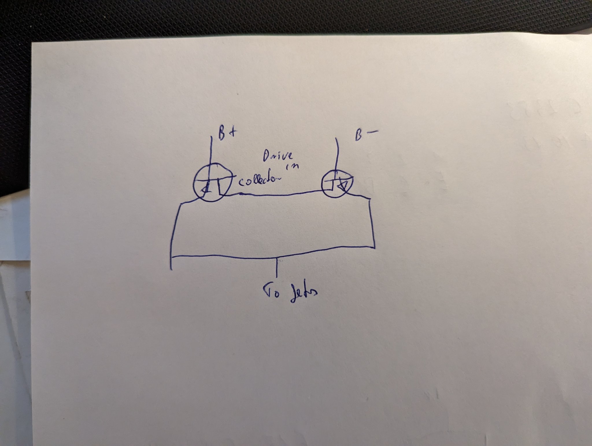

But this one got B+ and B- at the base of the transistors.
collectors are collected and goes to the mosfets.
Emitters are collected together and get the drive signal from the TL494.
Has someone infos about that, or ever seen such a configuration?

Ok, found the problem.... I had to look at the old transistors.. The legs are covered with some skin from manufacturer... Inside the skin, they twisted two legs..
Base and collector... Than it will work as normal E/F pair..... Very poor manufacturing.
