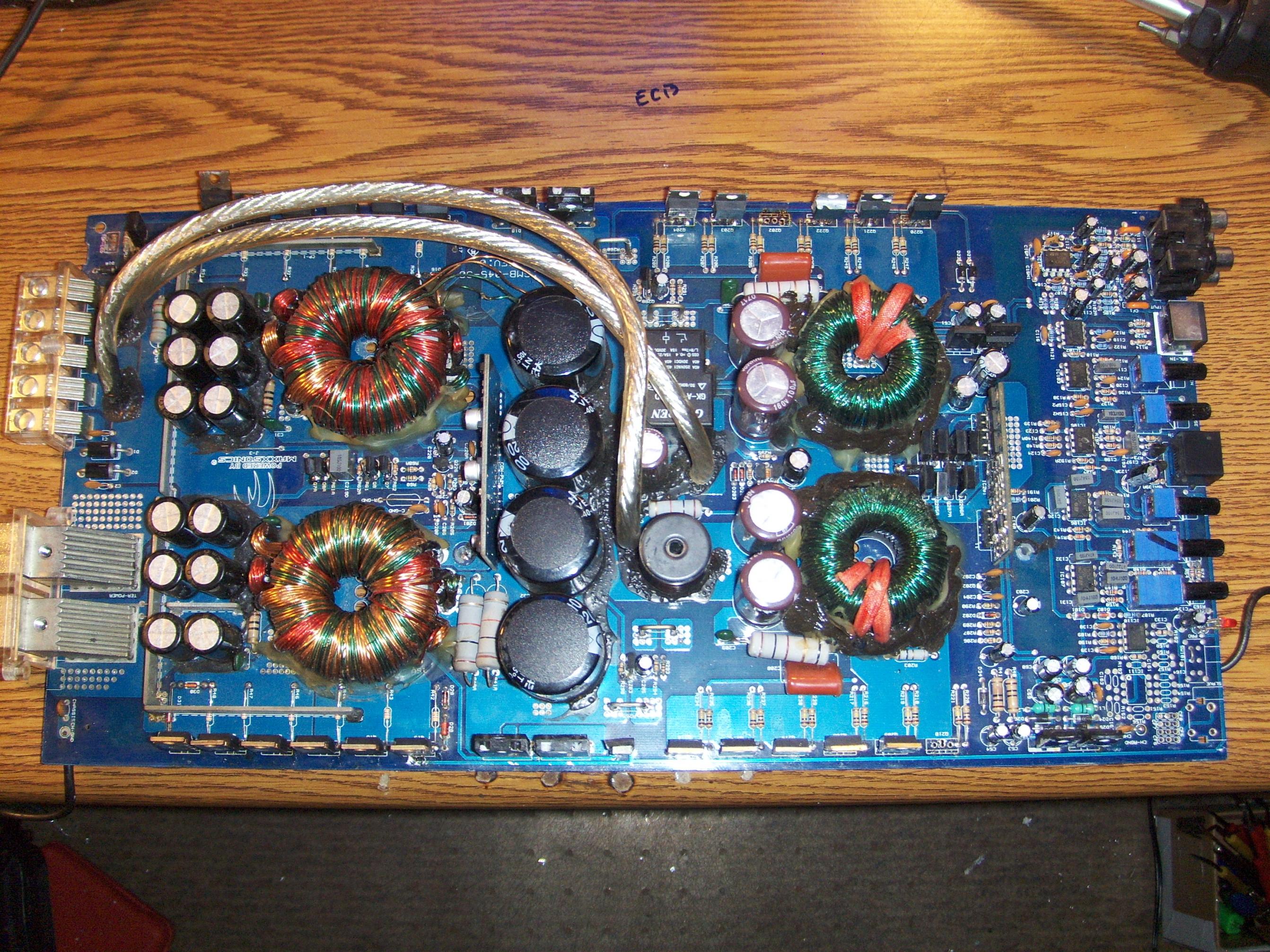

I received this amp for repair.
The amp powers up, idle is stable, its not in protect and it produced audio.
Someone has attempted to repair this amp and didnt do a very good job. Although its working I question its reliability.
I am going to reflow the solder on the p/s fets and gate resistors.
The amp is missing 2 outputs, my question is this amp has all IRF640 in it with no IRF9640. Is this how this amp is suppose to be?
Before I replace all the mismatched date coded output fets I want to be sure this amp uses all Irf 640's in the board. I thought they would be IRF640N and IRF9640.
I am beggining to wonder if its even a BXi2006D or a smaller amp in the wrong case??
Can anyone tell me if this amp has the correct outputs installed? I would think if you had IRF640's where the 9640's should be it wouldnt power up???
I have posted a pic of the board can anyone tell me by looking?
The board number is SMB-045-90 2006.12 REV:0

I reflowed the solder to the p/s fets, replaced all the outputs, and removed an un needed jumper someone installed and this baby rocks the old 18.
