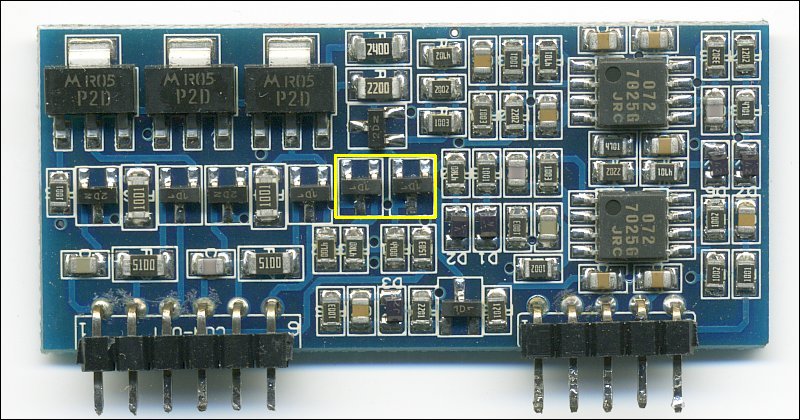

If there are no shorted output transistors and no output transistors with broken legs, the most common fault for amps using this driver board is the failure of the two transistors in the yellow rectangle.

What are the part numbers of the two small signal transistors in your picture above in the yellow rectangle?

I've checked transistors in the circuit before and they checked open but after removing them, they appeared to be OK. I'd suggest replacing them. They run very hot. Generally, the board is discolored under those transistors because they operate at such high temperatures.
Does anyone have the part number for Q6/Q7? I see where one person substitutes a MPSA42 in to-92 package for more power handling. Is there a schematic of this circuit anywhere? Are these NPN transistors just used as switches?
Does the discoloration on D5/D6 on driver board mean anything? I guess I can take diodes off and check them.

MMBTA42
