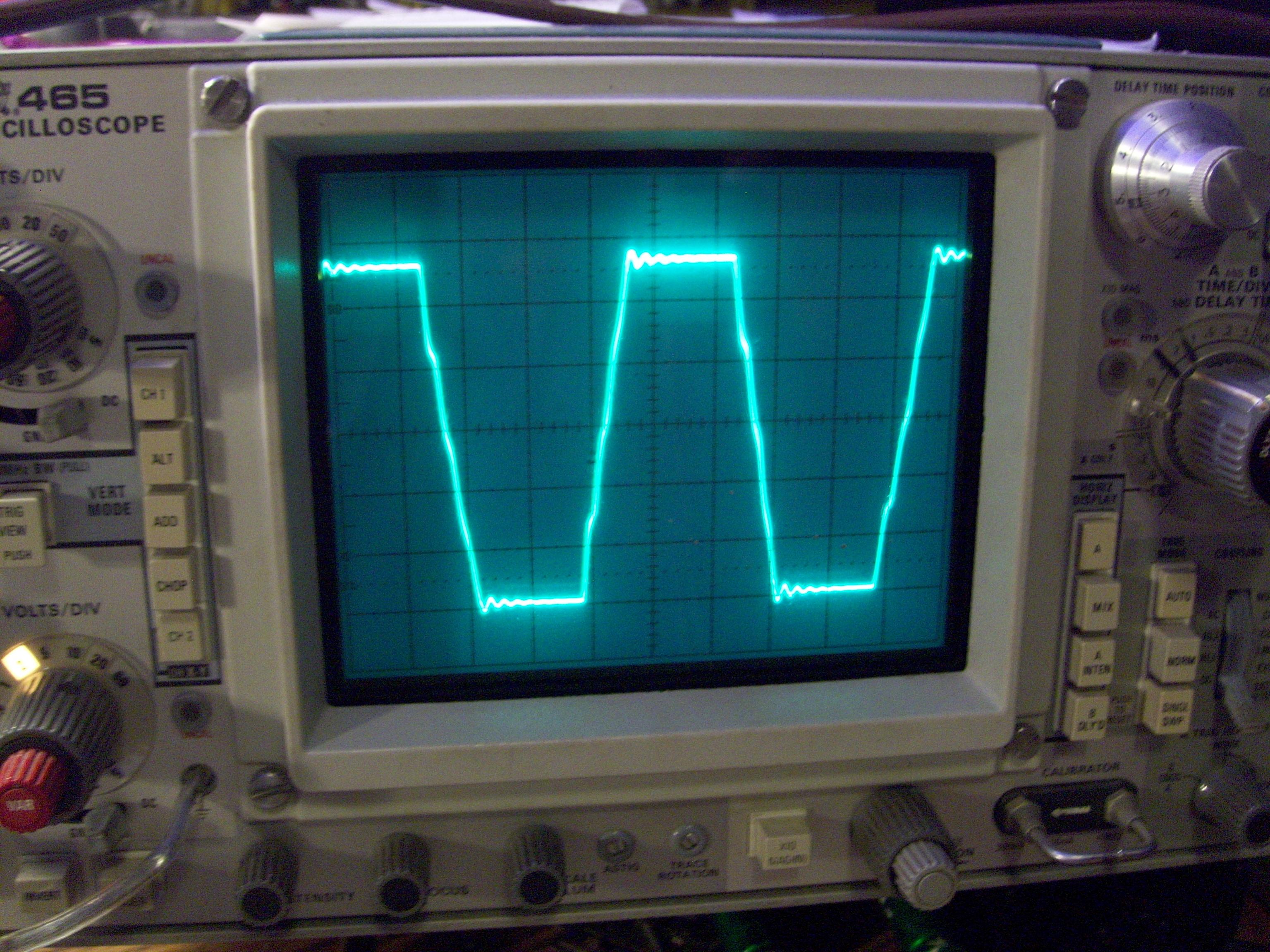

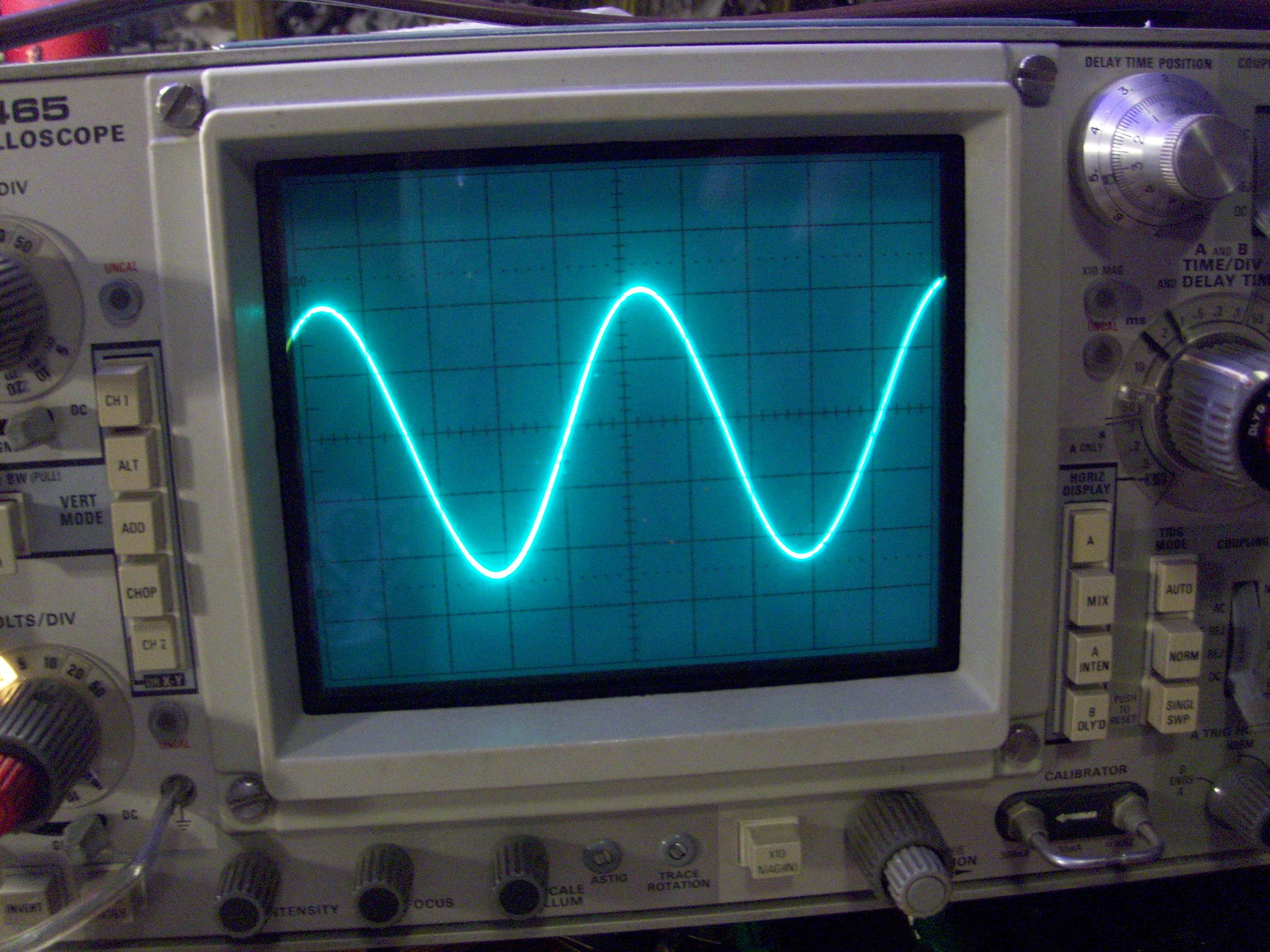

I changed the top TL072C and the amp powers up and does not go into protect.
The voltage on the + output terminals is -0.047 vdc and stable.
The supply is no longer shutting down.
Should I change the bottom one or if its working just leave it?
Still looking good, audio is clean but when it gets up to clipping gets a little choppy looking is this normal?

I am just so use to working on Rockfords I guess, they dont make a signal like that when they are clipping.
This is a cheap model hifonics though probably not well built.
The Brutus BX2005D you helped me with didnt have distortion like that either.
Wierd?
I hooked it up to the old Rockford 18" sub and it sounds great!!
