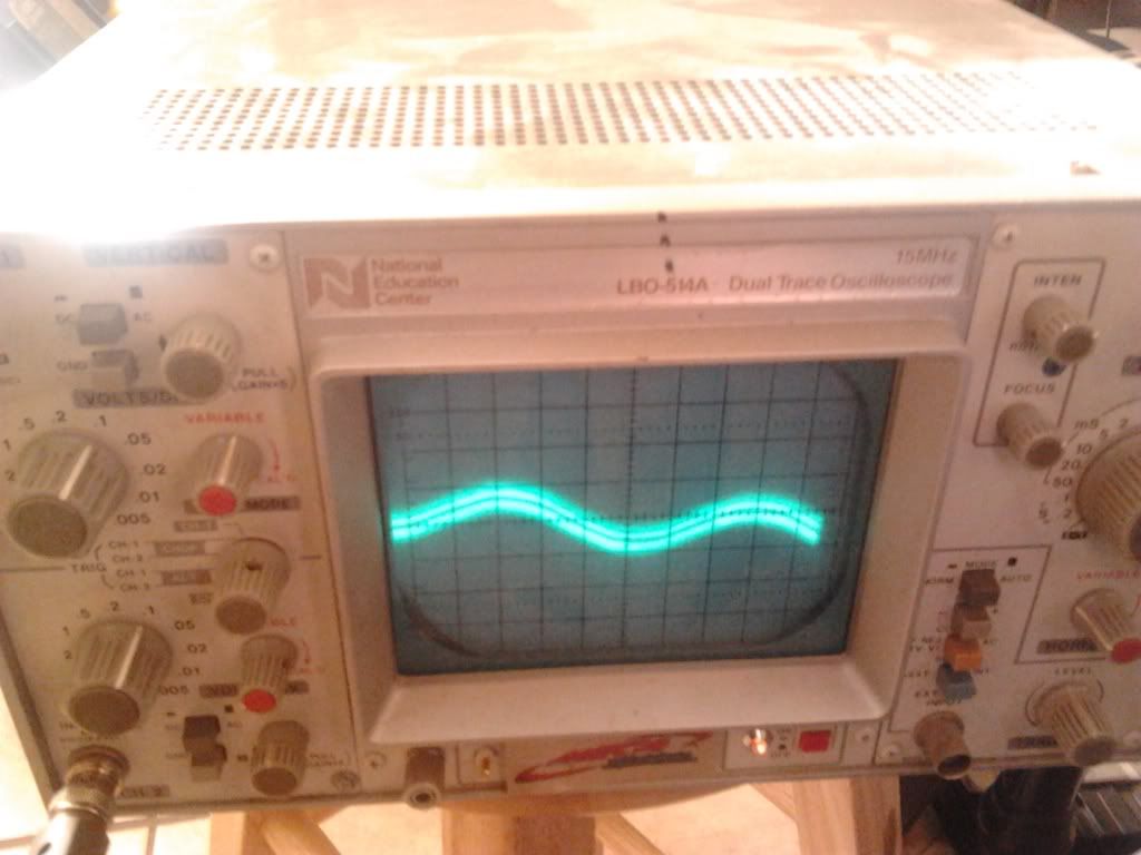

If none of the op-amps have any significant voltage on their output pins (1 and 7 for 8-pin op-amps), you need to drive a signal into the amp and find where the signal is lost.
i get signal on output pins 1 and 7 on the following op-amps ic101 , ic102 , ic103, ic105, ic106 , ic107 has signal on pin 1 but not on pin 7 , ic110 no signal either pin trace looks staticy
Please re-read (very carefully) the 'Best Initial Settings' section on the oscilloscope page of the site (page 73), read down to the 7 questions and make sure that you can answer them.
When you list the timebase setting as 1 that doesn't tell us anything. It could be 1ms, 1us, or even 1s.
After reading the Best Initial setting and setting the scope as suggested there, post another photo with the waveforms on all 3 legs of Q210. Set the vertical amp to 20v/div. Set the timebase to 2ms.
