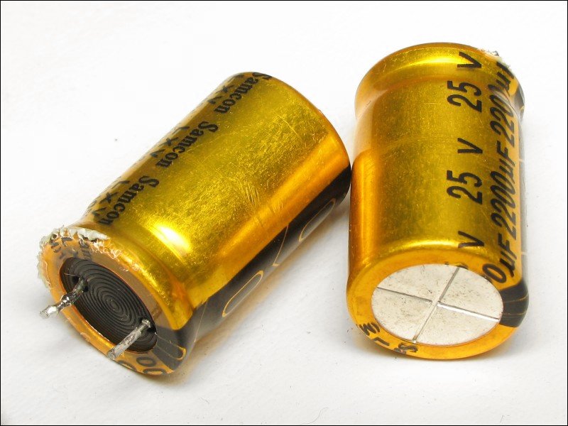

Don't replace the capacitors (not unless you find a reason that they need to be replaced). Confirm that you read less than 0.1v across all of the capacitors in the amp and then re-check to see if that was causing you to read what appeared to be a short.
ok..lets do so. Perhaps it's never a bad idea to change those badcaps to something real, like Rubycon 😀 Than you for your help..it doesn't fit in my brains that measured differently the FETs are good and HIP is good, but together they're not. But let's recheck with caps zero voltage for sure.
Those had a very high failure rate and caused all sorts of problems. Connecting a single, large capacitor (1000uf or greater) across the B+ and ground terminals generally allowed the amp to function normally at low power when these were the problem. If you have a scope, you should see excessive high frequency noise on the B+ terminal of the amp (if these are defective).
Earlier I did that 'trick' and placed a 4700uF cap straight to B+ and GND -terminal..the amp showed a little lifesigns and tried to turn on (power led turned on green but it was like bumbing the current and led was sailing between bright and öö the other, not so bright). Secondly I added another capasitor (2x4700uF) to terminal and the amp did act like before -> power led red. So it didn't wake up anymore..maybe the HIP died at that first part :/ So..it seems that next reasonable thing to do, is change those larger caps to something better. And order a new HIP if this doesn't wake up with that capasitor change. I write with mobile phone and I cannot add enter 😀
