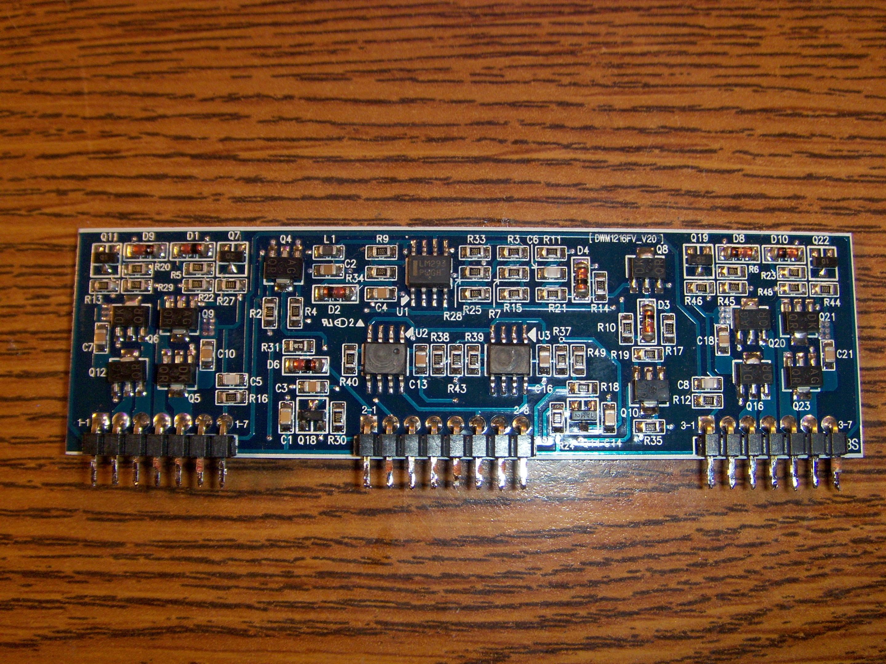

I powered up the amp all was well then poof went the outputs!!!
I can leave all the 9640's installed and it powers up fine, when I try installing the 640N's they blow instantly.
I have posted a pic of the audio driver board, you can see the drive transistors but I am not sure what is what.
There are 4 marked DK QR and 4 marked AG QR.

DK = 2SC4672
AG = 2SA1797
Was the driver board in the amp when the FETs failed?
Yes the driver board was installed, it is removed now. Should I replace the fets and power up without the driver board installed?
Could some of the DK or AG being leaky or defective cause the 640N's to blow?
The amp idles fine and has a nice square waveform on the power supplt gates. It is producing positive and negative rail voltage of around 80v and all the op-amps have positive and negative supply voltage.
I am thinking I have an issue with the driver board???
Q7, 11, 19 and 22 are generally the problem on this driver board.
I've never seen any of the AG/DK transistors fail on these boards but that doesn't mean that it couldn't happen.
I'd reinstall the outputs with no driver board and confirm that there is no DC voltage on the center legs of the outputs.
I replaced all the irf640N's and powered up the amp without the driver board installed, everything seems fine no dc voltage on the center legs of the 640's.
Does this mean likely Q7, Q11, Q19, Q22 are possibly leaky or shorted??
as replacements all I have on hand is MMBT3904 and 3906 and will those work for replacements since they are all the same pin configuration? I have a56 and a06 but I think the a06 is different pin configuration unless my old notes are wrong?
