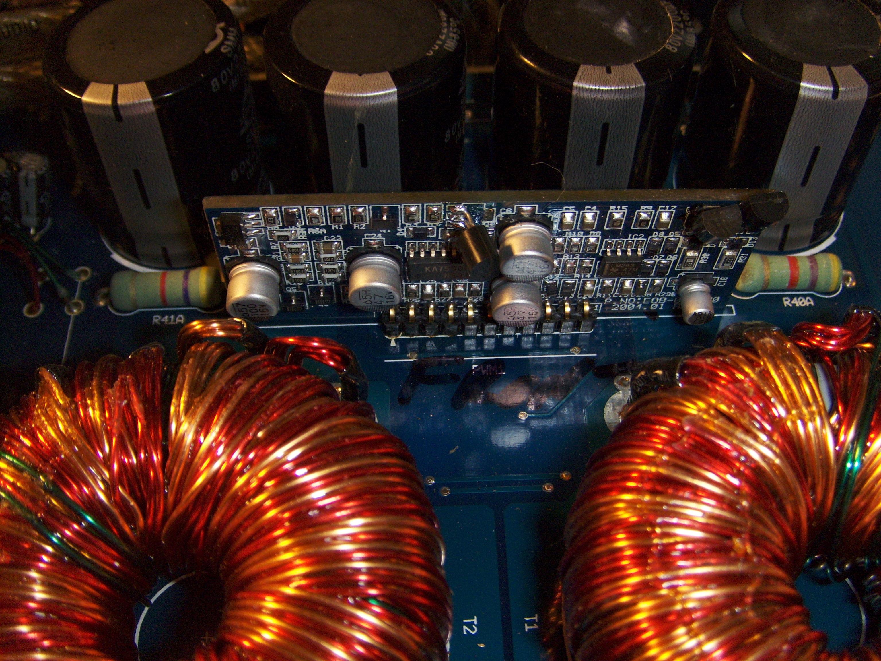

Well I recieved the amp today. All the power supply fets (FQP85N05) have been removed. Someone has attempted a repair on this unit. The gate resistors they installed are 22ohm but are to big and poorly installed.
Were the originals 22 ohm and if so were they 1/8 watt?
There are also some transistors poorly soldered on a driver board near the rail caps, dont know if there the right ones they are marked A1266 and there is only 3 of them or what they are suppose to be????
I will be replacing the power supply fets with IRF3205 and 47 ohm through hole resistors just need to know if they are suppose to 1/8 watt or what looks like they used 1/4 watt and they are to big for the spot on the board.
Any advice would be great and anything else I should be looking for asside blown outputs???

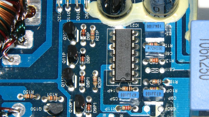

I don't have anything on this amp but many of the amps that used 1/8w gate resistors used 22 ohm resistors. The ones with 1/4w resistors tended to use 47 ohm resistors.
If the layout is similar to the attached photo, there should be 4 1266s. There is one 1266 and one diode to drive each of the 4 banks of FETs.

This amp is different and I have not confirmed but dont think its a 4080 amp. The parts yours show are not in this amp and it has a driver card next to the rail caps.
Pic 1 of board
Pic 2 of driver card with 3 1266's soldered on and I dont know if they are original I would say not by looking what do you think???

Someone has done a real hack job here, I have removed the gate resistors and power supply fets legs. The solder pads are in rough shape from someone over heating them. I will be able to salvage them though.
I have ordered 47 ohm 1/8 watt resistors for the p/s gates, I stock the IRF3205.
The outputs are all original and they use a IRF640N and IRF9640, there a few shorted but I stock all those.
Question is what should the transistors be that drive the power supply fets on the driver board?? Looks to be four of them and there are 4 pads. The big pad in the front looks to be nothing other than an extra pad to hold down the transistor. The 3 pads in the back are what count.
Could I use PZTA56 in place cause I am not sure what the originals are???
Could you Perry or you bl4kcw1d0w tell me what the original drive transistors are on the boards you guys have and if the PZTA56 will be a sub or do I have to go original due to pin configuration???
Next question......should I be worried about the KA7500BD IC or has it possibly survived???

The ones you posted will work. The originals had an HFE rating of R. The Q will work. You can use either.
A couple of notes...
It's really not a bad idea to have those transistors off of the board. The boards are not very high quality and will burn badly many times (as was shown in the thread for the link I posted).
You probably know this but the 7500 is the same as the TLx94 so it if you ever need to replace one, you'll likely have a replacement in stock.
Ok thanks Perry Mouser does have the "R" in stock as well. Which one is heavier duty?
Next question...would the bd140's I ordered work for this application?
Yes I have many tl494 in stock thanks for the info as I did not know they were the same.
The A56 will work but you'll have to twist the legs to make them work. If you plan on using these as permanent replacements, I'd suggest cleaning the through-hole for the collector and inserting the collector leg through the hole (soldering on both sides of the board).
If you want to use the BD140s, scrape a strip of solder mask from the back of the board. Fold the collector leg over the board and solder it down. You'll still need to insert a wire through the hole for the center leg of the original transistor to make sure that you have a good connection to the ground on the back of the board.
