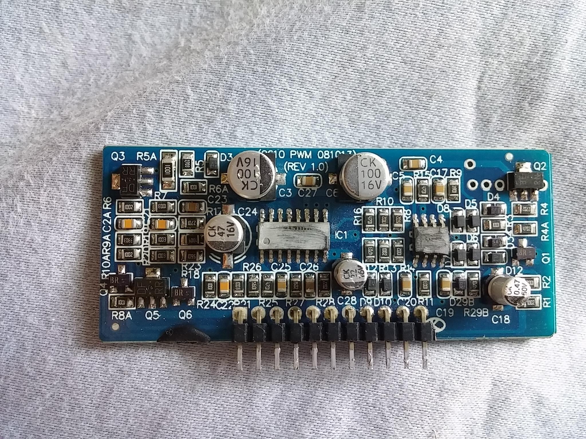

On bank 1 which did not blow the fets after replacing, the gate resistor showed 3.84 volts before gate resistor and 3.62 volts when the load resistor was placed betweenpads 1 (gate) and 3; however it jumped to 4.65 before gate resistor and 4.52 when load resistor was placed on gate and drain. On bank 2 which blew the fets after replacing, I had 3.82 before gate resistor and 3.61 after gate resistor when load was placed between 1 and 3 and had near identical numbers when load was replaced between gate and drain; however, I noticed the a1275 driver seemed to warm up quickly on bank 2 and remained cool on bank 1.
I checked the traces and components around the driver transistors. They appair to be fine. One thing of note is that the thermal protector is tied in to the gate resistor of bank 1 and that the trace after the thermal has signs of overheating as the sealer has flaked off. Not sure how to trace that. Also the drivers follow back to a ower assembly board (pwab) and go straight to an op ic designated ic1. However, the factory for some reason ground the part number off of the ic. I think this is where my problem is. Any ideas of what it is? I don't know how to post a pic of the pwab on here.
Here is a pic of the pwba. I was incorrect when I said thermal is attached to gate resistor, it is attached to pin 3 of power fet.

What else can I look for then? Drivers were new nte, new gate resistors and new fairchild 50n06 fets. I did try a quick power up with no outputs in it. With power hooked up and no remote, seen .5 amp draw. When remote was hooked up I shut down supply when amos started to climbn was at 7.56 amps when I **** down power.
