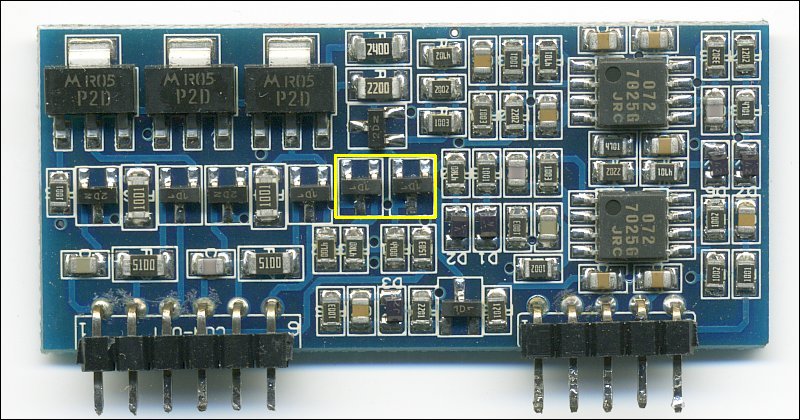

2. All 12 of the 47 Ohm gate resistors in the power supply have been replaced (Circuit Board Designation R32-R38 & R42-R48)

9. The Driver board in this one has been pulled right now which is located at IC201. It is labled CON1 Driver board 81013 V1.0. This is the common one found in the Hifonics 2006D models as well.
http://www.bcae1.com/temp/bxi2006daudiodriverboard01bx.jpg

I had one that had a defective op-amp, which was causing the protect. I first replaced the 1D transistors in Perry's photo. Not until I replaced the op-amps did it come out of protect. They are probably TL072C, not sure.
I finally found the problem. I found that q285 and q287 which are KSA1220A's had the emitter and collector shorted. This amp took me a while because I am usually use to those pesky driver transistors more commonly shorting out on the driver board.

Did you replace the transistors in the rectangle?
Sometimes the op-amps will cause the amp to go into protect but it's generally those two transistors.
