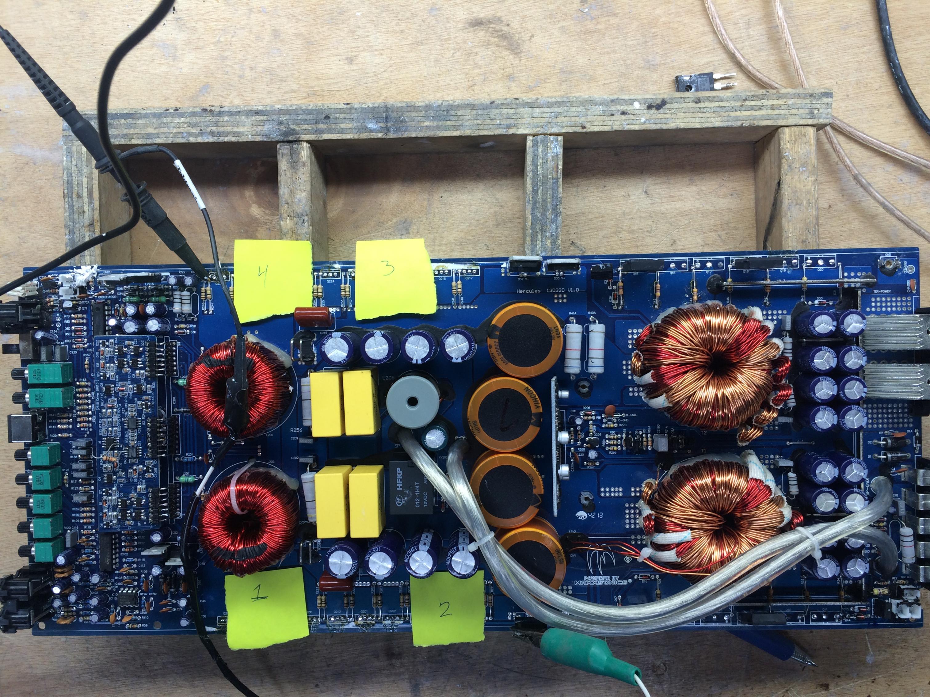

By the way, this amp is giving all 4 signals without no MOSFETs and no 10k ohms resistor
Between pin 1 and pin 2 of U2.

Can I swap the signals between shoulder to see if the getting hot problem swaps or stay in the same shoulder?

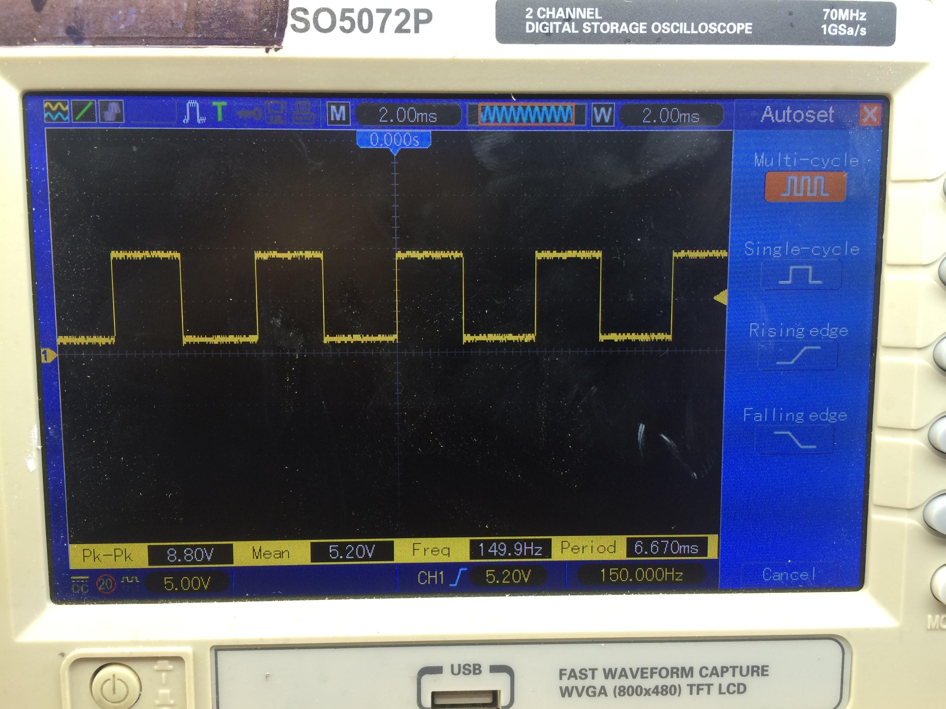

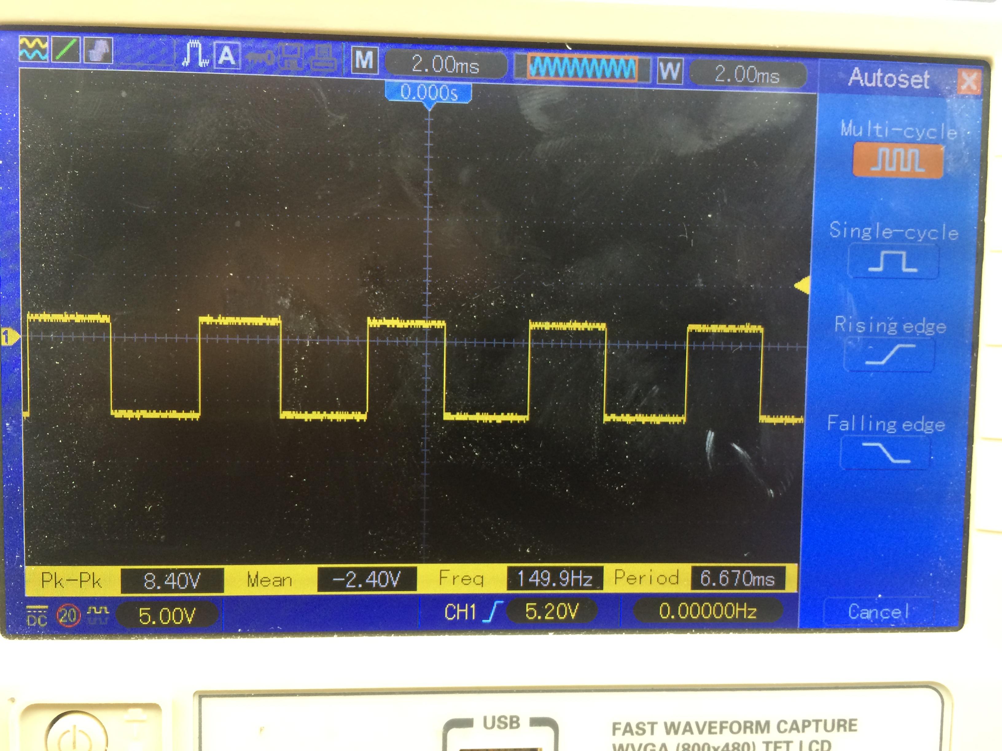

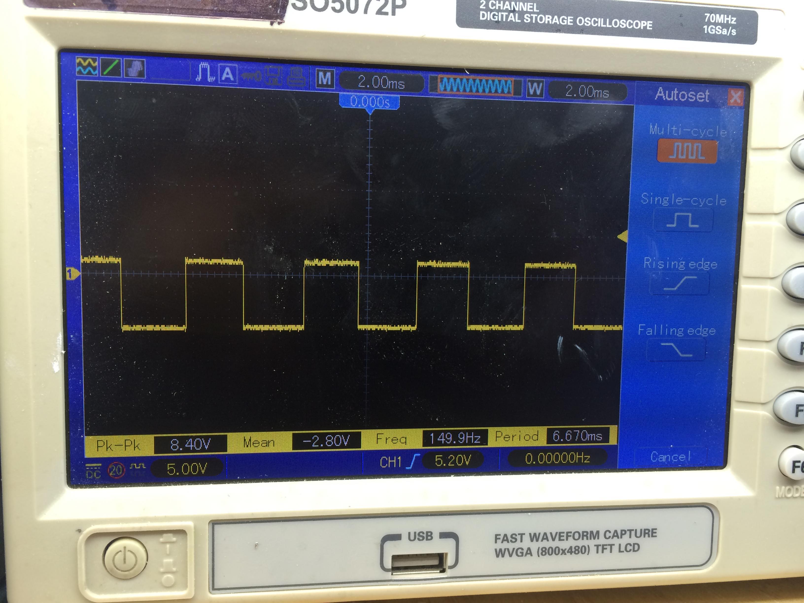

This test was done with reference to the sources. The scope shows 8.8 volts pk-pk.
Is that an Ok voltage?

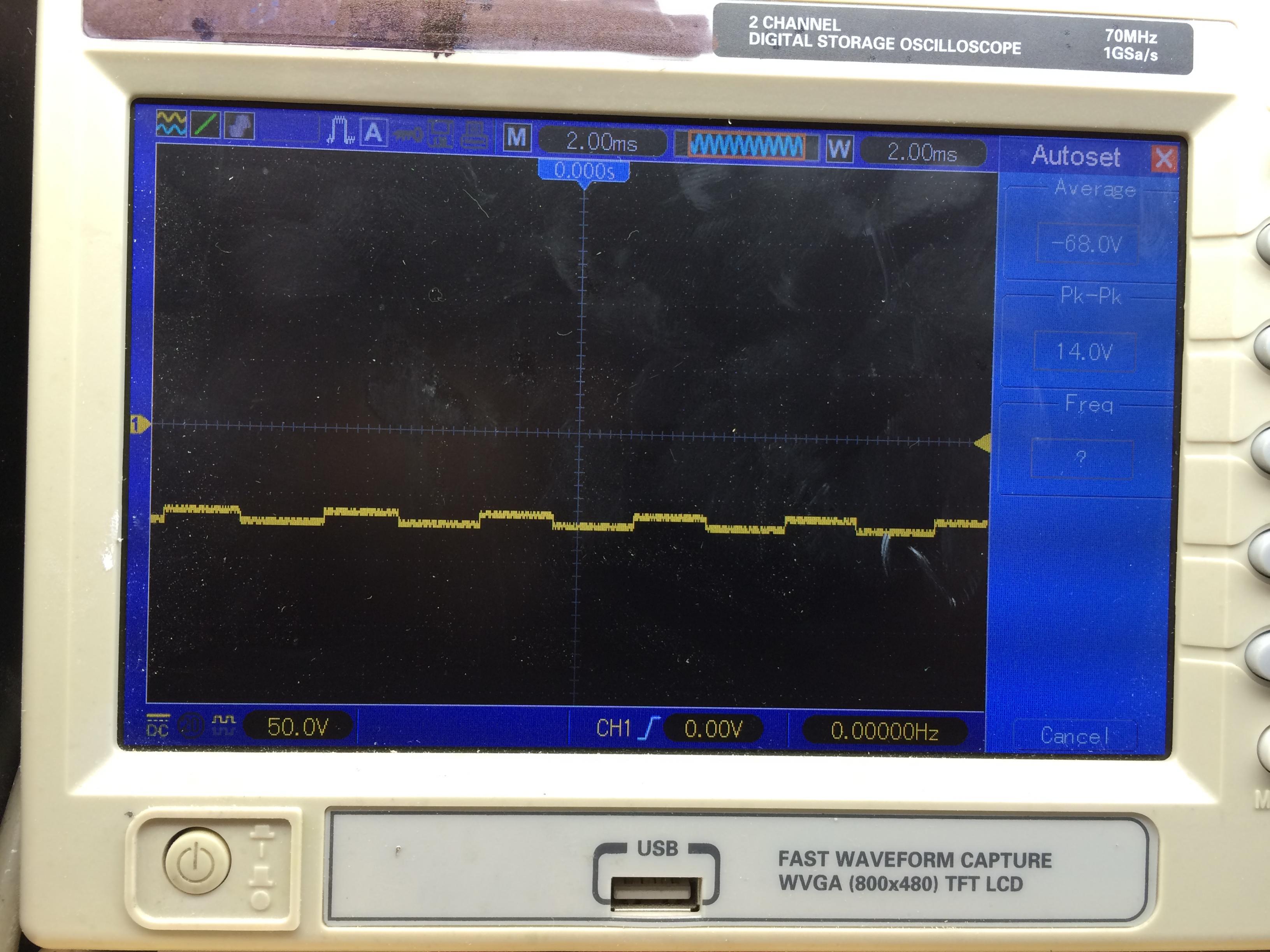

I'm still having trouble understanding the waveforms. It appears that the scope was set to DC coupling.
Is the scope battery powered?
If not, how did you reference to the source legs that are on the rails?
Was the scope trace aligned with the center reference line on the display when capturing the waveforms?

No, the scope is not battery power, it's power by 110vac.
To do this test I placed the scope ground lead on the tab of the rectifiers.
The center leg of the rectifiers are connected to the source of the mosfets.
For most scopes, the scope ground is connected to the mains ground (through the ground pin on the 3-wire power cord) and connecting any significant voltage to the ground burns the ground in the scope. It also causes the entire chassis of the scope to be at the voltage you connect the ground to. This can be lethal in some situations. To make such measurements, you need to use a differential probe setup or use a battery powered (handheld/portable) scope.
Knowing what you did still doesn't make sense looking at the images, especially for the ones that cross the reference line. The other two are what I'd expect.

Here are the pictures of the signals with the good power cord. (With ground pin)
